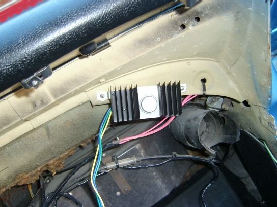

Test the convector;

Default convector
How do you test the convector????
Thanks
VS
Test the convector;
