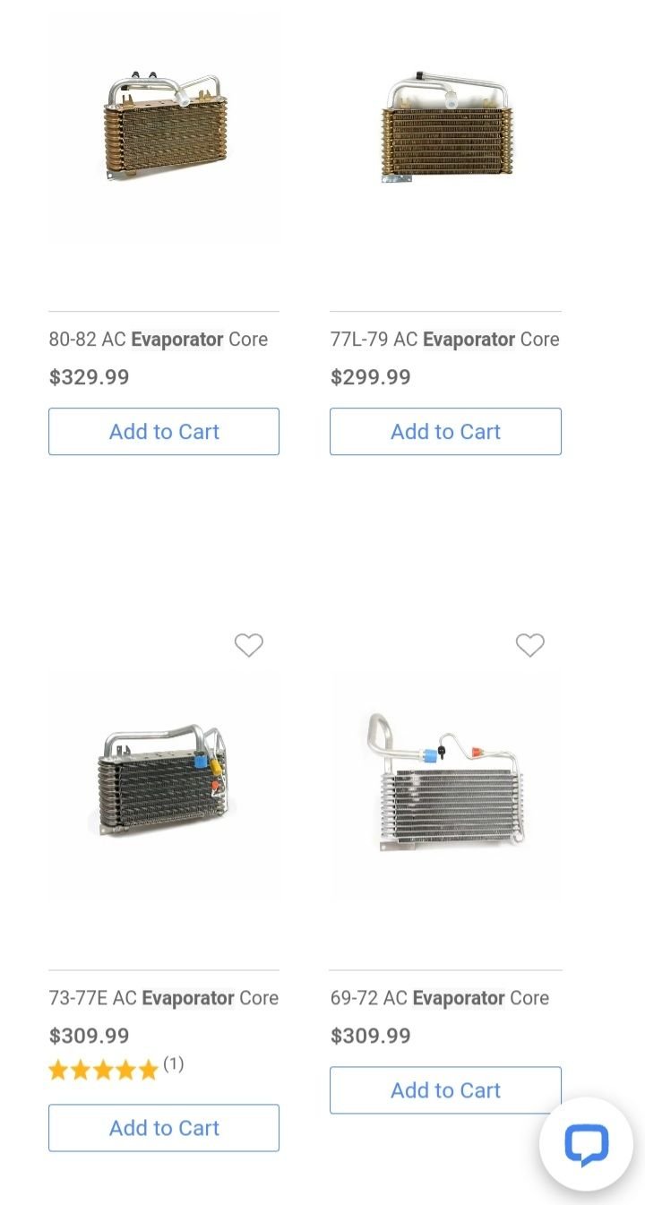

From a well known Corvette vendors web site.
As you can see 77E and 77L are different. But only 10 bucks different in price.
And yes they can be pressure tested as can a condenser or a radiator.
