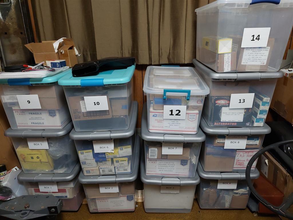

Grady, you now have a few spare parts...
Little Back Story of my parts quest for my 77.
I purchased my 77 in the spring of 1983 (I think?).
One of my neighbors at the time was the Parts Manager for a Local Chevrolet Dealership.
He stopped me one day and told me stop by the dealership if I needed any parts, so one day I did.
He told me about all the 1 year only parts for the 1977 and others that would soon be discontinued.
I asked him when he had time make me a list and would purchase what I could afford at the time.
So from then on when I find a part for a reasonable price I purchase it.
These 14 containers are large 68qt size...If you notice #11 is missing it is near with a set of ready to rebuild calipers in it...lol
Old Mar 25, 2022 | 08:57 AM
  #72
grady white's Avatar
grady white
Joined: Dec 2021
Posts: 805
Likes: 260
wow 😮 very impressive spare parts collection .. wish they were 75 NOS parts . You know me 😂

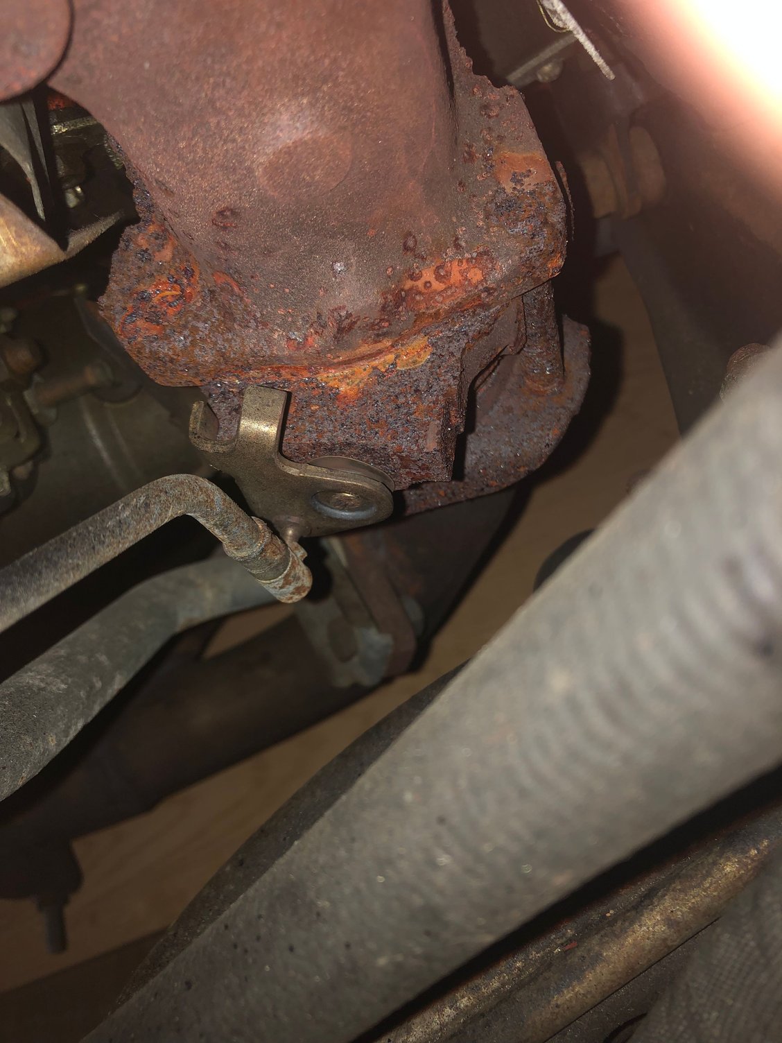

Joined: Mar 2015
Posts: 79
From: winter fl
Originally Posted by grady white
Hi , Does anyone know how to disconnect and reinstall the rod coming off the vacuum actuator leading to the heat riser on my 75 ?? I changed the TVS switch and thermostat, however when she warms up it still does not open..I hear sounds coming from the actuator so I am thinking that is the final part that is not working .. If I pull off the rubber hose on the actuator then the heat riser opens. As always
thank you
Perhaps a newbie question, but in your photo # 3, is the valve open or closed as shown? Also, anyway to check if it operates? Thanks
