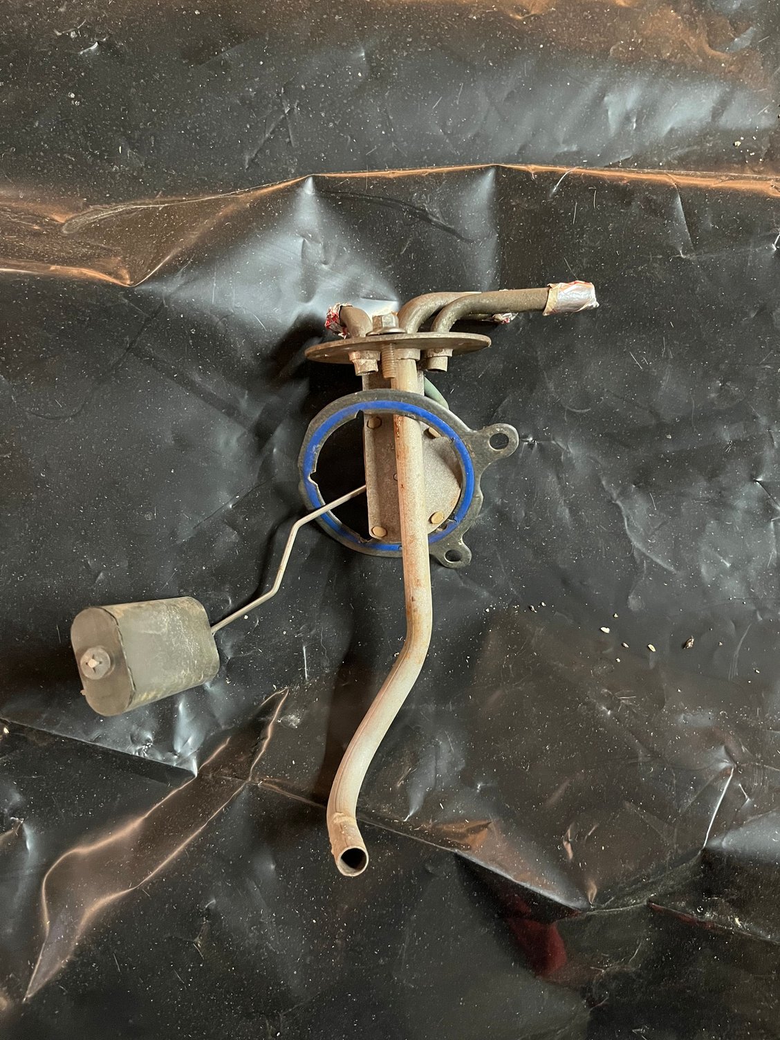

Hey all,
Looking for advice on a replacement sending unit. Researching replacements, this doesn’t appear to be common on any vette. I googled the part but have had no luck finding anything close.
Would rebuilding this unit be an option? The ohm reading is not stable- thinking the spring might be the issue. Thanks in advance

That's the correct part, yes. But the OP didn't remove that. He has some 5-bolt unit.

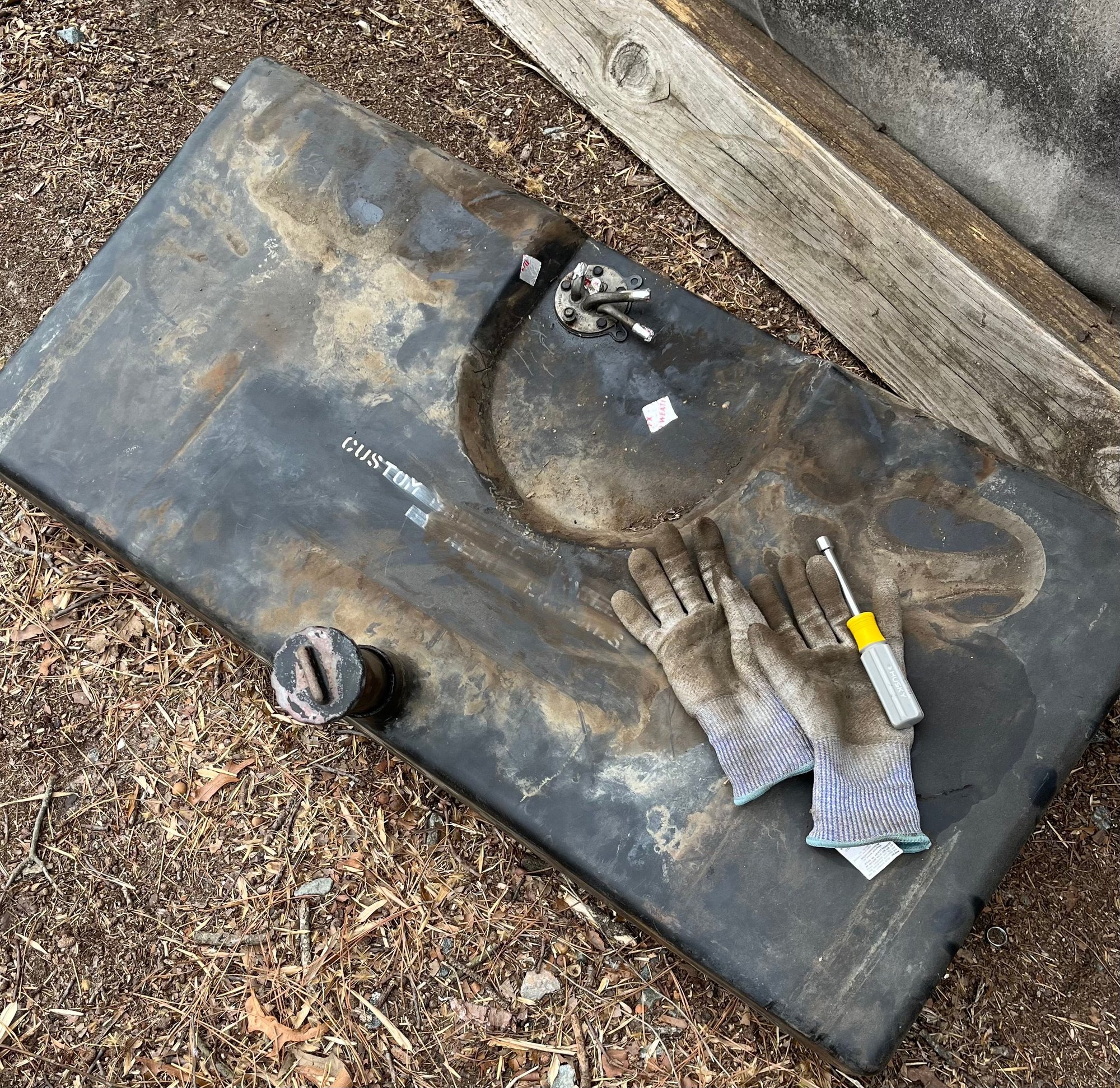

OP, can you post a photo of the top of your tank? Perhaps a Bubba adaptor is there that can be removed to get the 8-bolt flange back.

Here’s the top of the tank. This is a tank that’s no longer produced but the manufacturer said that there were popular for eckler conversions

Thanks! Is this a hatchback or shooting brake conversion? Nifty! Did the tank manufacturer say where Eckler's got the sending unit? Depending on how handy you are, you may be able to use the sending unit bits from the 81 assembly (new, or used) as long as the tubing passages are intact. Otherwise, you could modify the tank. Fill it with water several times before you do that, though!

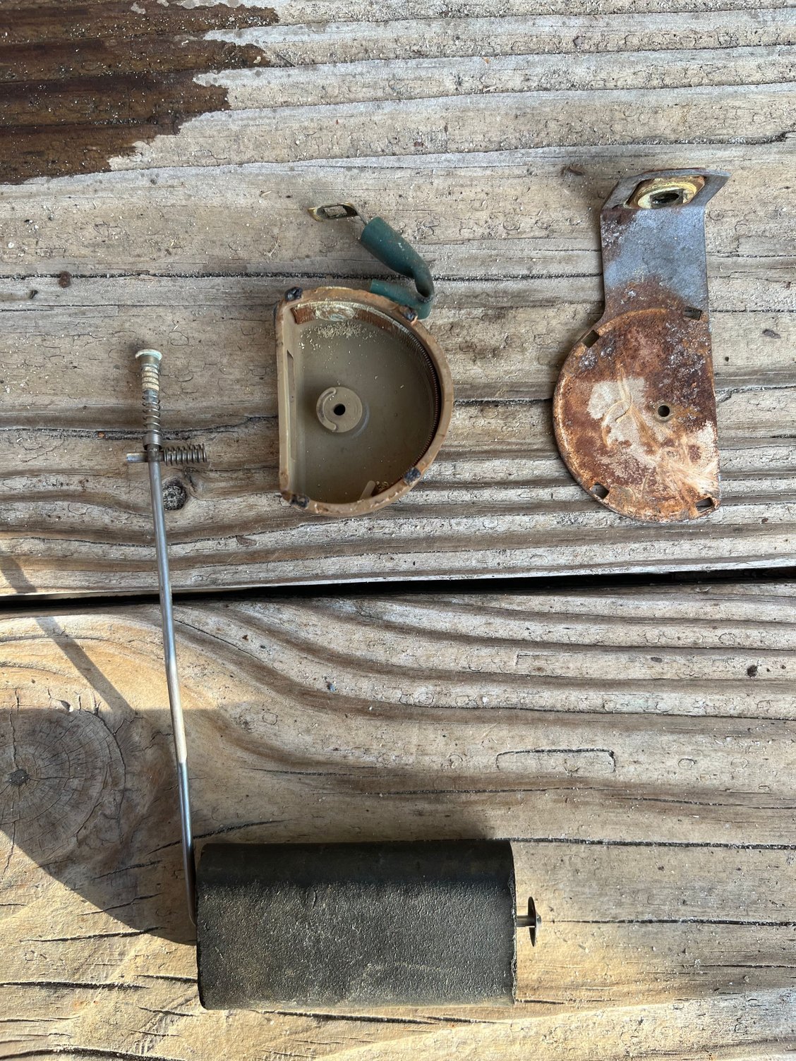

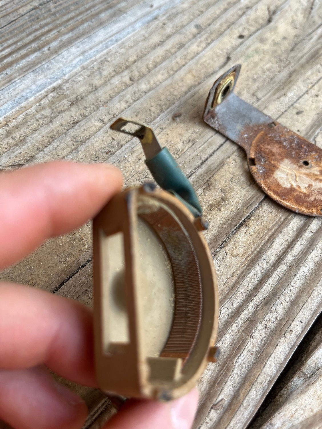

Update:
I took apart the area of the rheostat. I’m going to try to rebuild this. Does anyone know where I can get a replacement 90 ohm rheostat like this?

Grab some electrical cleaner (DeoxIT spray contact cleaner0 and give that a try. Might just need a good cleaning to get it back in service.
