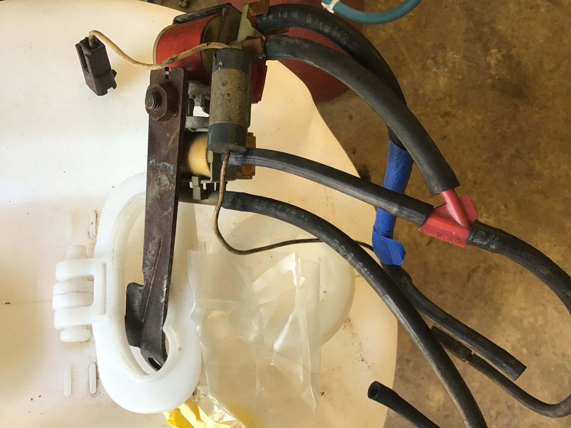

Default What’s this called
Wondering besides some type of vacuum what is this part name? And I’m replacing everything on top Edelbrock heads,intake,carburetor and HEI distributor,so,I’m hoping I don’t have to put it back,it’s ugly and there beside the the distributor.do most people use this or not?

egr solenoids.
control egr opening from ecu.

Like stated above, those two solenoids are for the emissions/egr system. The long round part with the white wires coming off of it is the tach filter. Plugs in between the distributor and the tachometer. You may still need it if your tach acts funny when you get your car running again. Seems some people had no trouble with the tach after removing it but others have had tach weirdness when they eliminated it.
