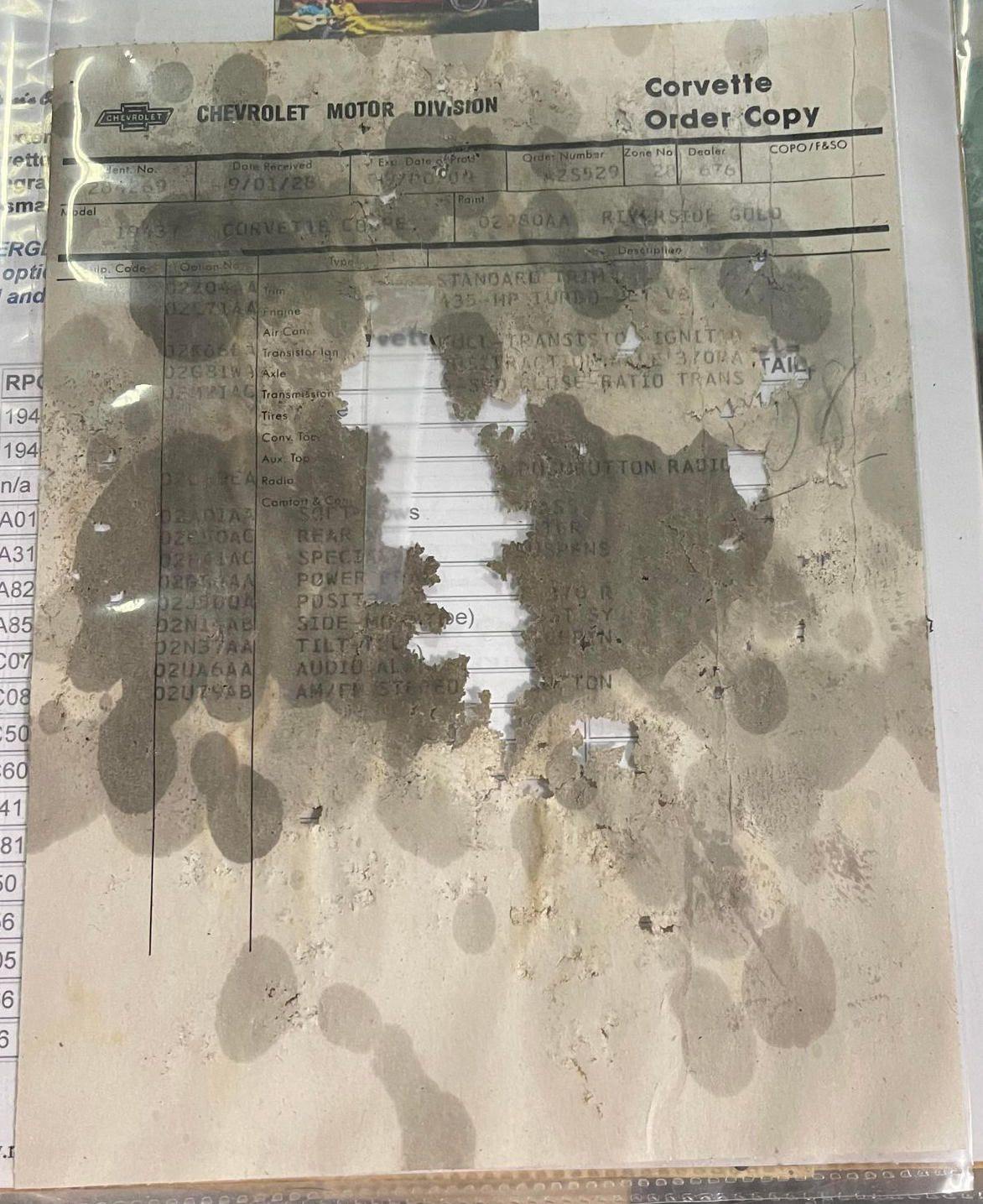

Looking for feedback on whether this is a genuine build sheet / tank sticker:

I would say things don't look right with the printing. The letters should align vertically from one line to the next and I'm not seeing that. It looks like it's got some authentic aging. There are other things I don't think are correct but maybe someone else will comment.

Like AOS stated, the letters don’t line up correct. Not original.

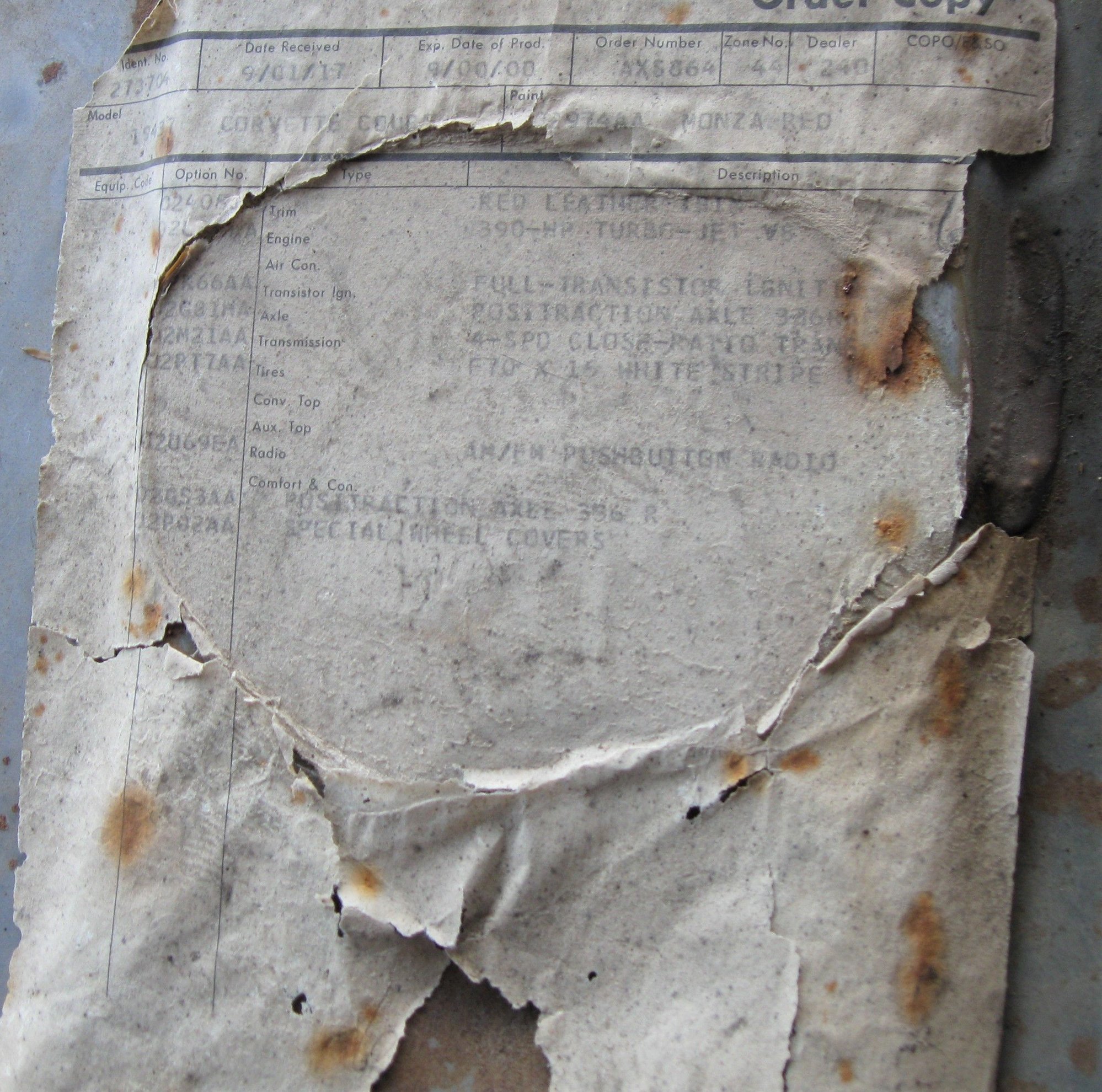

early 1978 tank sticker

The options do not line up vertically ( this was from my first new Corvette in 1969 )

The tank sticker in the original post is not typical factory production The spacing is not consistent with original tank stickers and there are mistakes in the sheet such as options like the 427 missing in the the second the line where the engine designation is.

The sticker in question was presented along with other documentation on a car I was interested in.
Car is now sold but this may have put me off anyway so appreciate the feedback

Knew you would catch the missing 427.
How about the Positraction and Power Brake option lines reversed…..
That was what I caught, I then sent a text to DKM and asked his opinion.
