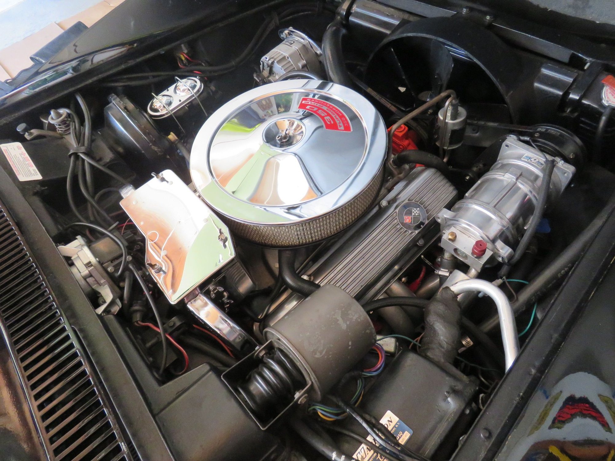

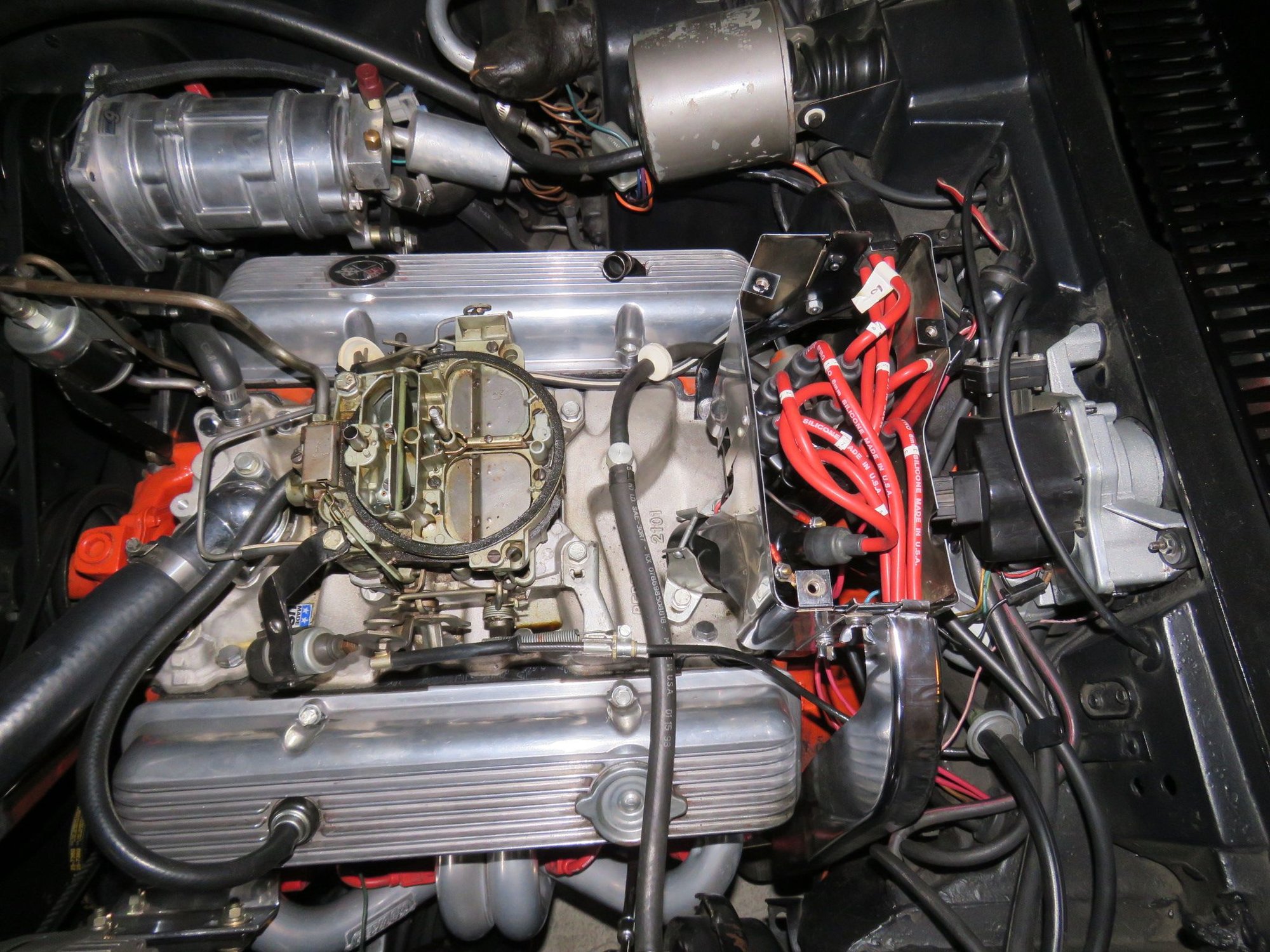

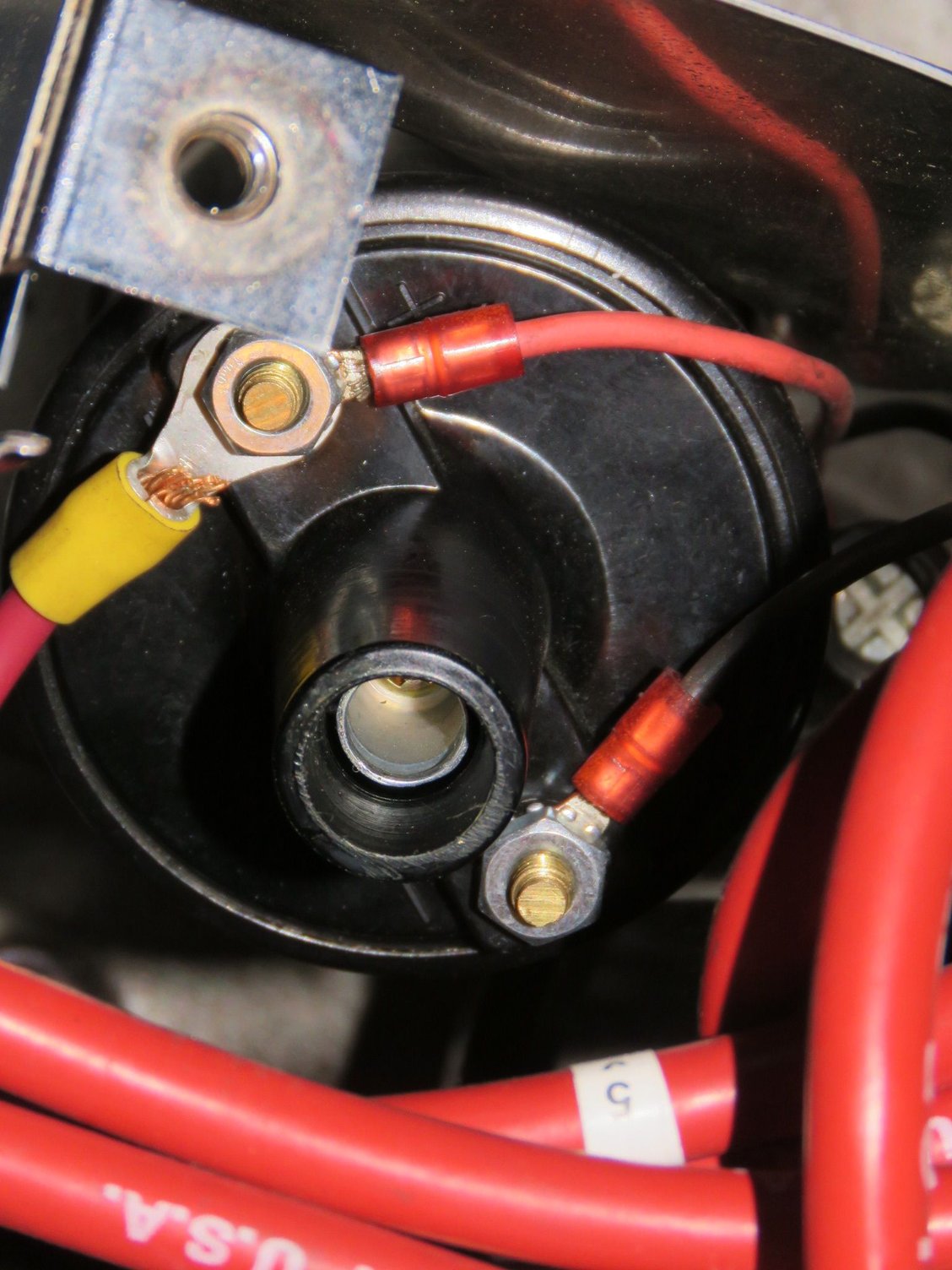

THose coil wires arent stock. If you can get a color coded wire diagram you should be able to trace those out and see where they go. Theres some on ebay or the vendors might have them that the wires are actually color on the chart so you can follow them easily. Dr Rebuild has some nice wire harness identifiers but they arent a diagram. Very ehlpful though tracing wires and identifying them by the connectors. THey shouldnt be coming through the grommet unwrapped and individual like that.
Looks really nice otherwise. I had speaker wire coming from the alternator though the fire wall into the wiper switch. It made some nice smoke when I turned them on. Yours is in much nicer shape.
