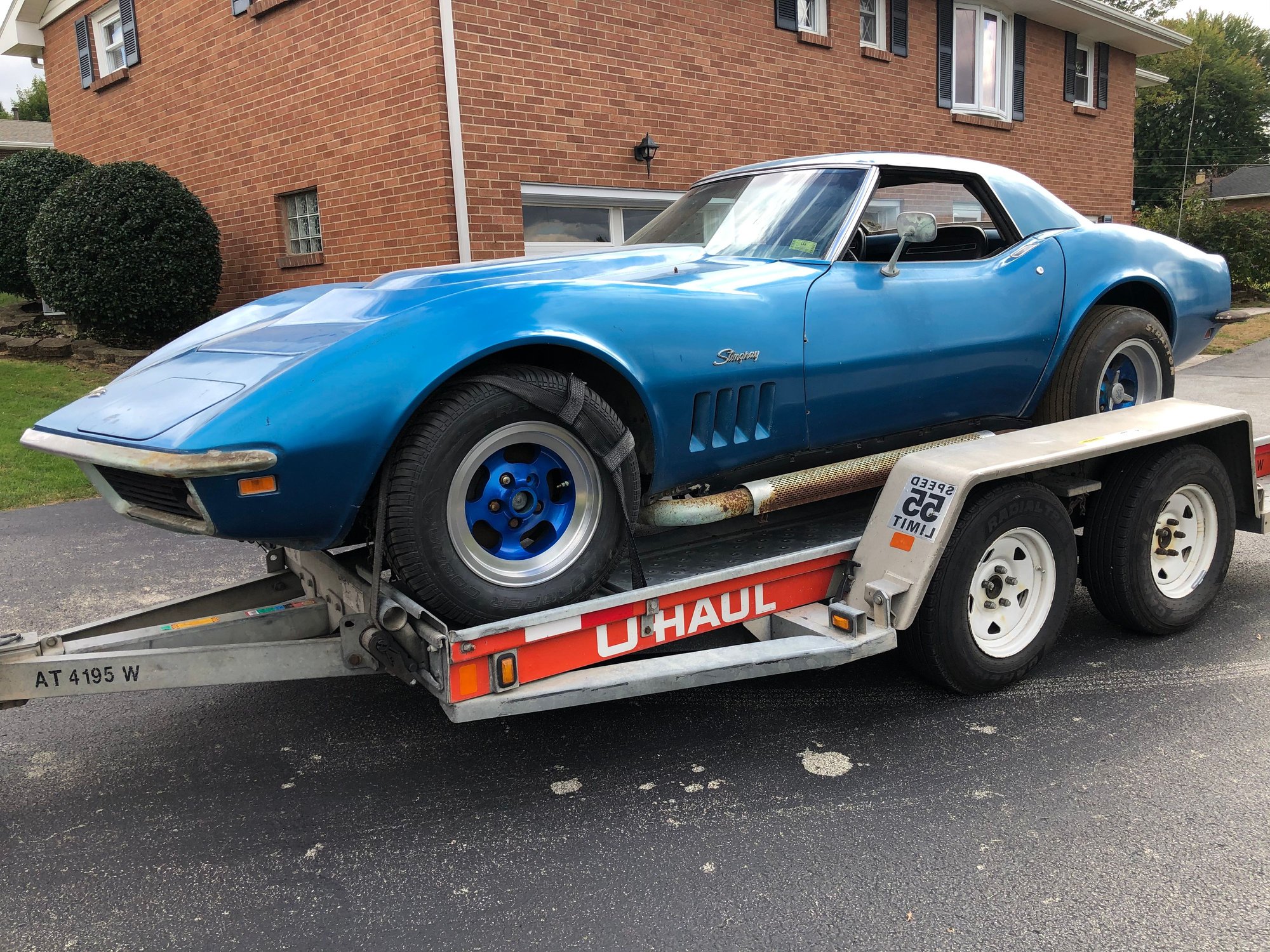

Here is a picture of the car the day I brought it home.

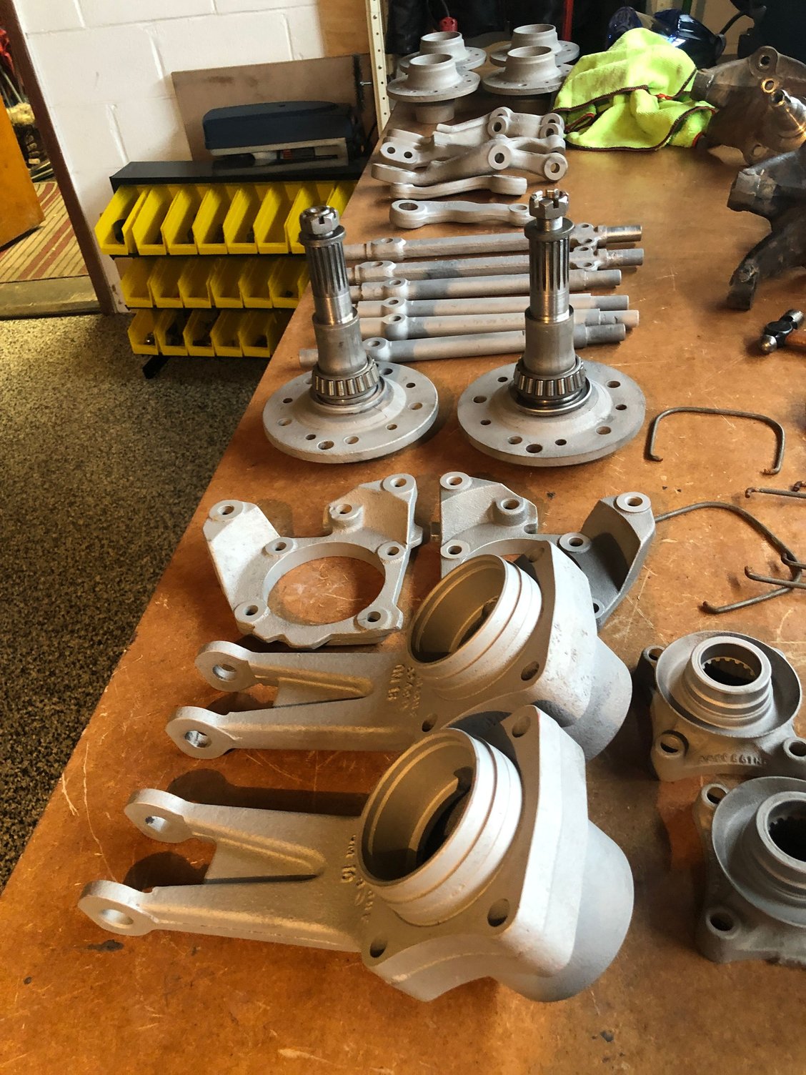

Blasted a bunch of suspension / steering parts yesterday. I have some extras, as you can see in the picture, which will be up for sale in our classified section. I also disassembled two manual brake master cylinders I have. I would like to use one of them because they are originals,.....but, I need to see if the bores look any good.....has anyone ever paid anyone to sleeve them? I have FOUR front spindles,......and only one is wear free on the shafts......looking for a good one, so if anyone has one, let me know. And despite having extra control arm shafts, some of them are compromised in the bushing area......I would like to find one good lower control arm shaft....so again....anyone? I know I can buy new ones, but prefer GM parts.

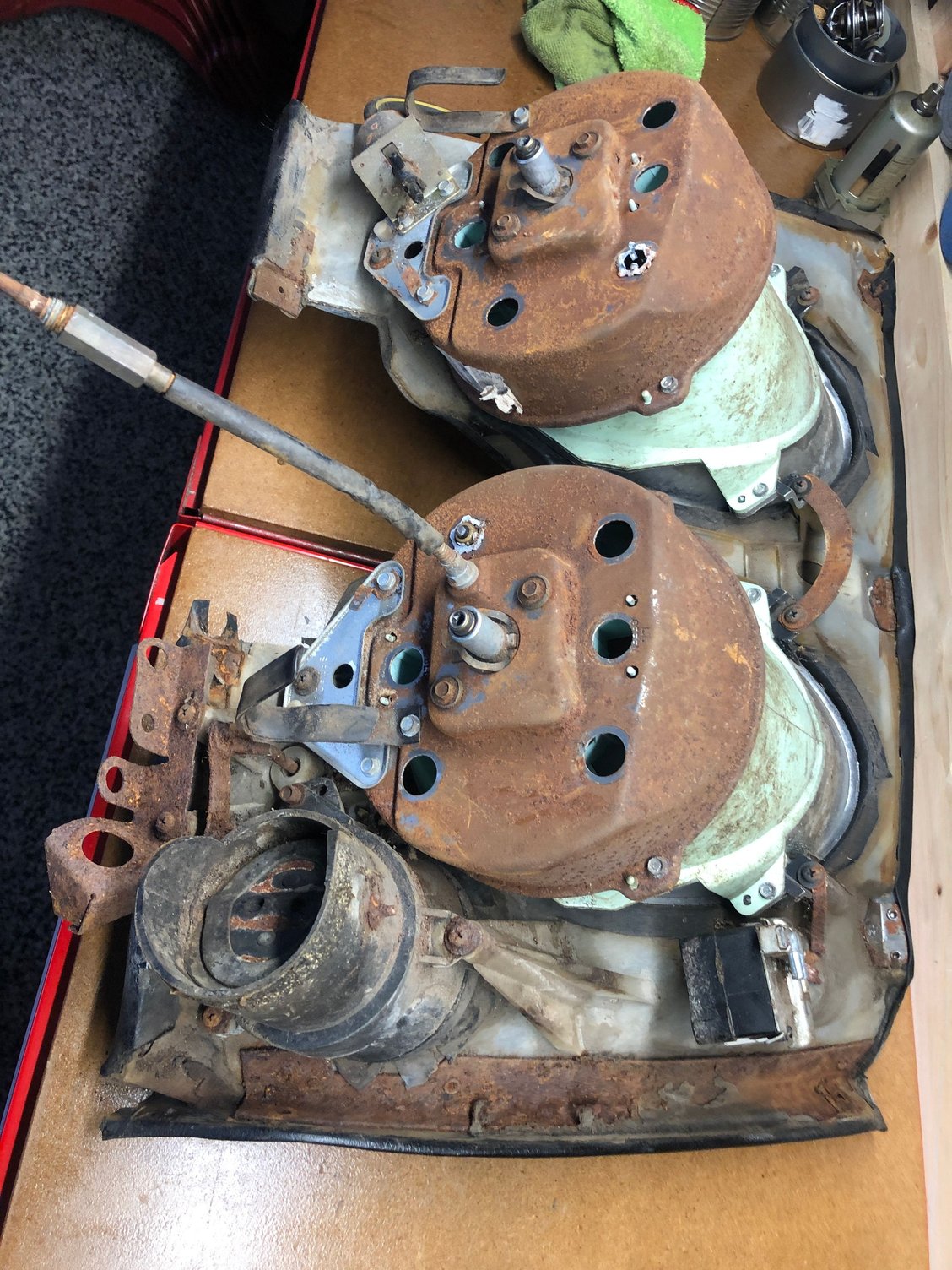

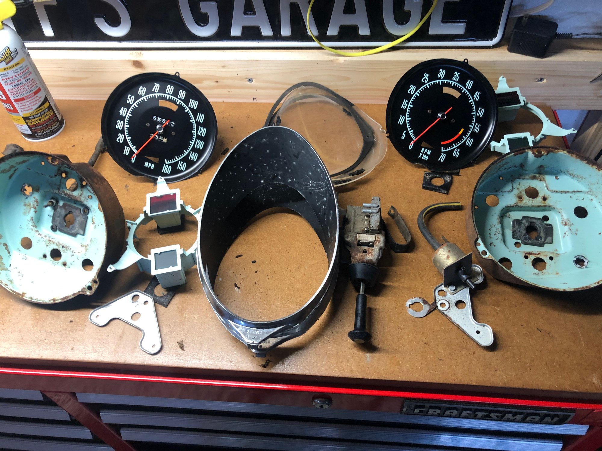

I disassembled the instrument panels and cluster gages. Contacted company in South Carolina called D&M Restoration, and sent the the gages for cleanup, testing and calibration. I liked what they told me, and hoping they do the work as well as they stated. I didn't do any of this on my 77 when I rebuilt it, but this 69 sat for over 30 years, so I think its possible some of the gages will be non-functional, and don't want to find out after they are installed. The faces are all pretty good except the clock. I will update you on the results. THAT IS ACTUAL MILEAGE ----65,514
