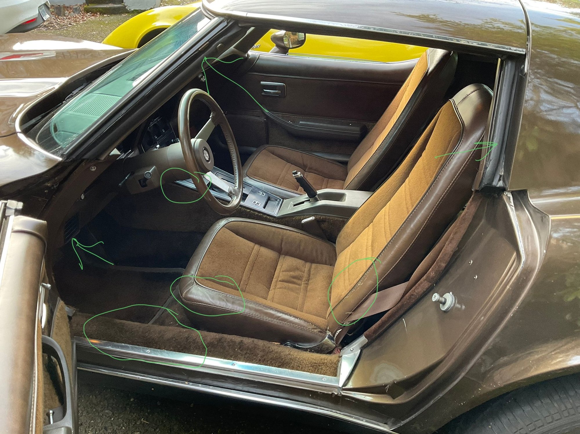

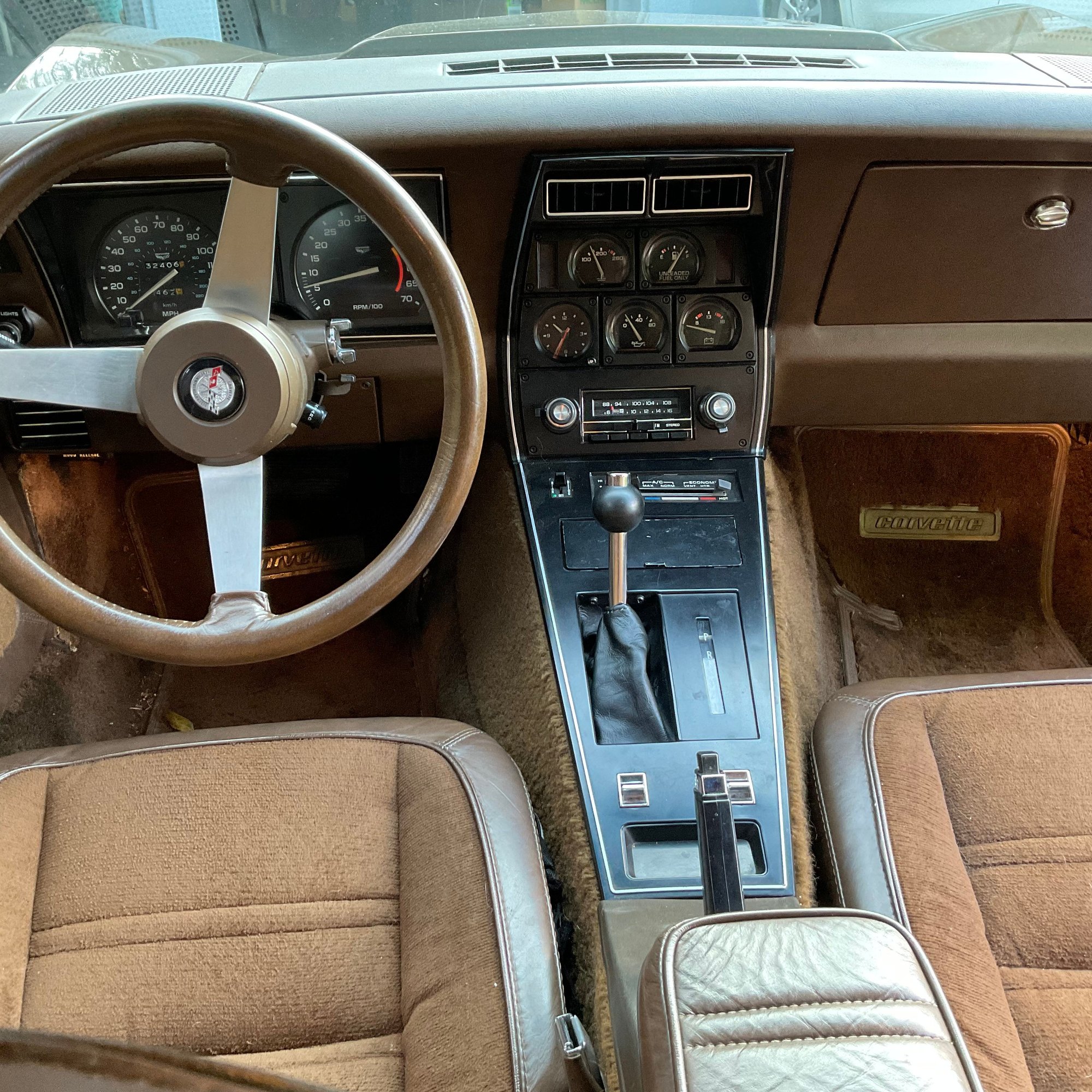

Original miles or plus 100,000? Here’s an original 32,000mi car for comparison. High wear areas; seat
bolsters, door sill aluminum trim and carpet, chrome edge on center console, brake pedal, weather stripping, steering wheel, ash tray cover.
