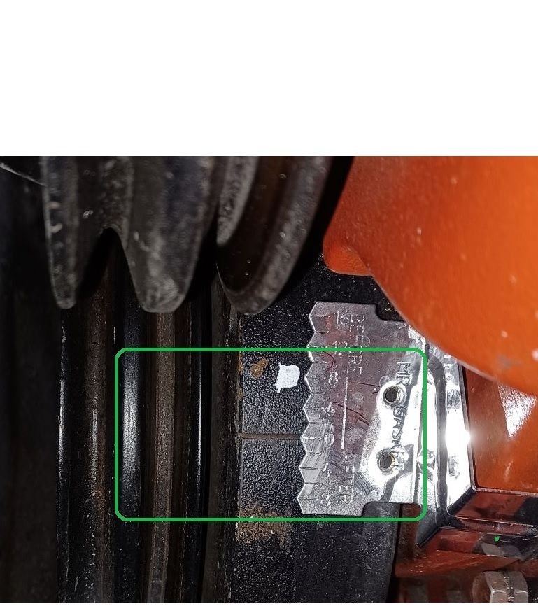

So I got the balancer timing slot lined up at TDC - it was right about where the piston stop stopped the CW rotation of the engine on the #1 spark plug hole.

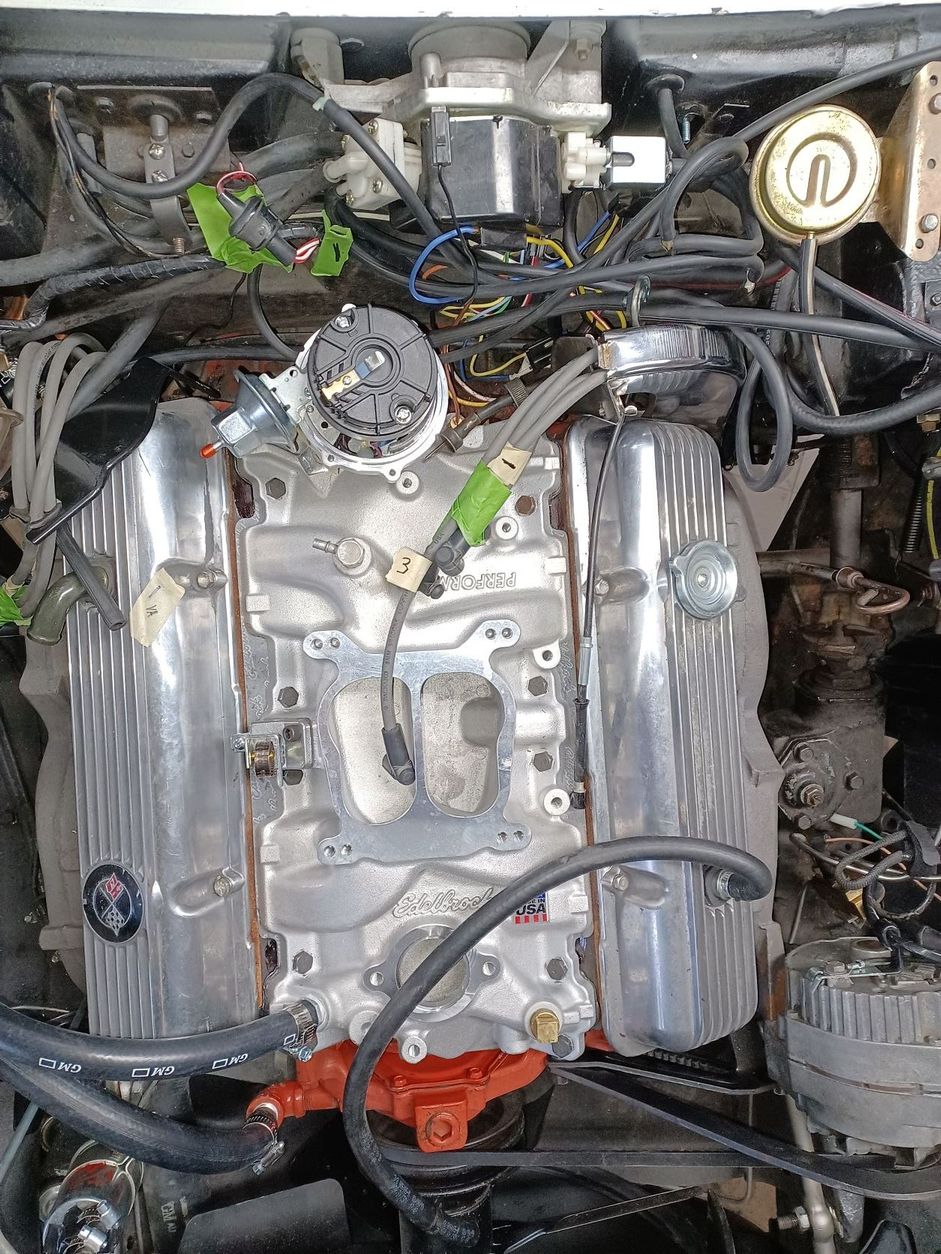

So far so good. However, it appears my distributor is pointed at the #1 wire at about the 8:00 location (looking down on the engine). This looks a bit off
to me from the standard Chevy factory placement which looks to be about 6:30 or 7 location. Didn't have much luck trying to pick up the distributor and walk
it over a tooth at a time to put it in the standard location.

from where it is now, pull dist and put it at about 5;30. then crank motor while holding down on distributor. you will feel the pump drive line up and it will drop in. now crank it around again to about 6;30 and see where timing mark sets up. as doorgunner was saying, do not worry about where the vacuum can points. set dist up so tach cable has straightest run to it's mount point.

So after re-reading Lars Grimsrud's "How to Install your Chevy Distributor' I set the timing mark to the 8 degree BTDC. Then I used a screwdriver to spin the oil pump shaft into position to install the distributor in a way where the rotor points at the #1
at about 6:30 position. Thanks to all for your help!
