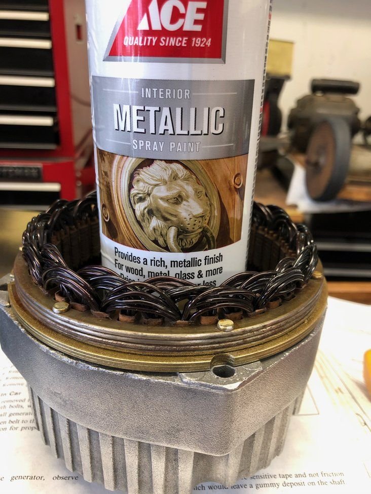

start about post 90
https://www.corvetteforum.com/forums...uestion-6.html
you are smart to keep original.. the china remanufactured are noisy and draw more HP..
if you like original.. the only comment i would have is to brass brush not blast as numbers wear down..
i did not clear mine left bare.. but did paint the stator that shows.. i think its the epoxy they use for insulation..color (check your year)
