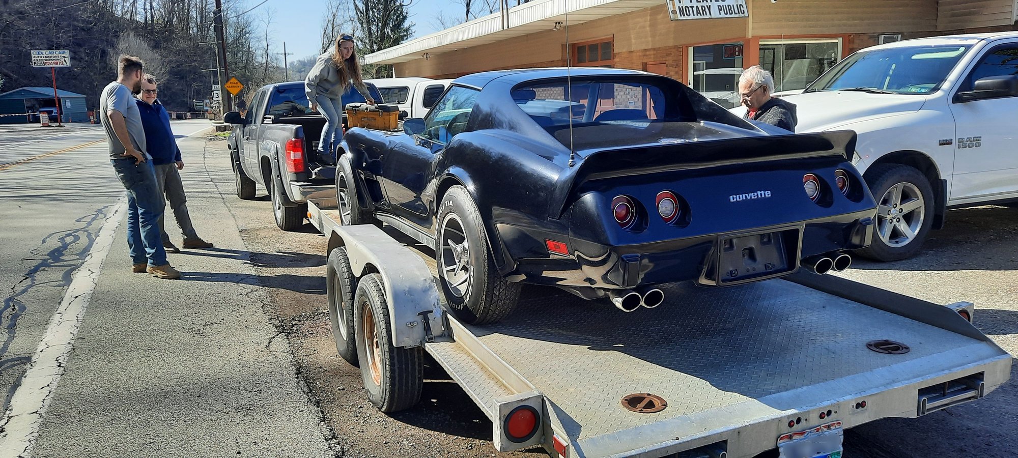

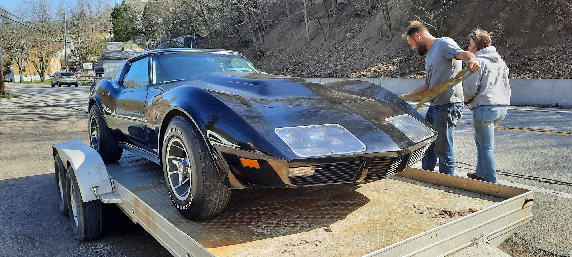

Old Apr 22, 2022 | 04:13 PM
C0RVETTED0N's Avatar
C0RVETTED0N
Joined: Feb 2012
Posts: 135
From: The North Coast
Default Quick Pick Me Up
Loadin' Up & Headed Home
By Bye PA, I'm Ohio Bound
