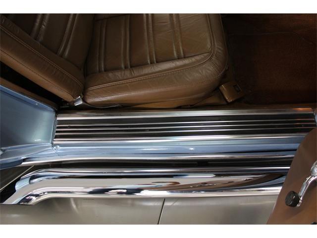

It would be much easier to pull the rocker sill, it's only held on by 4 screws. Then you could pull the carpet back a bit and see true paint evidence. The tank sticker will be great to have as it will confirm a special paint code but it probably won't tell you what that color was.

I still say the only way to know for sure is to look under the rocker sill.
