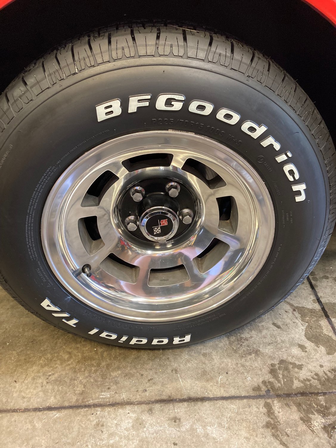

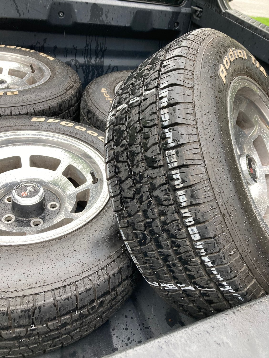

as my vibration now above 80 is still there (BUT MUCH BETTER) i had my tires balanced at discount tire previously a year ago..
i decided to spring for the forced balancing .. it was 99 bucks for all 4..
before i could pay he already said the one on the machine will NOT balance as there is too much 'hop' and would check the rest..
says he was able to get 3 OK but they still had some hop but should be OK.. said take them drive it and if no good bring back and refund balance.
I asked about buying one new tire he said just get 2.. ( i thought i had decent tread).. got them home noted 2 of the 4 tires had these markings on them an dassume the one with the biggest 'hop' they didn't even put weights on..so i decided to buy 2 more brown lettered BFTA..
will be in thursday and will return all 4 to pick worst ones..
i asked about the ok tires what was the hop pounds and he said worst 19.. i said that sounds high and he said up to 30 ok... beats me.
he actually showed me the out of round on the one tire, he was not sure if some treads let go or what..anyway will update.. hoping for 100% fix..

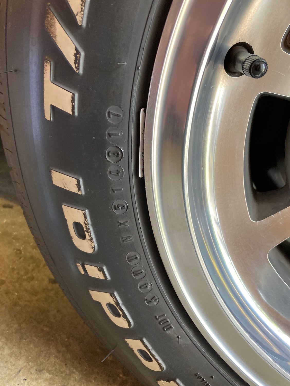

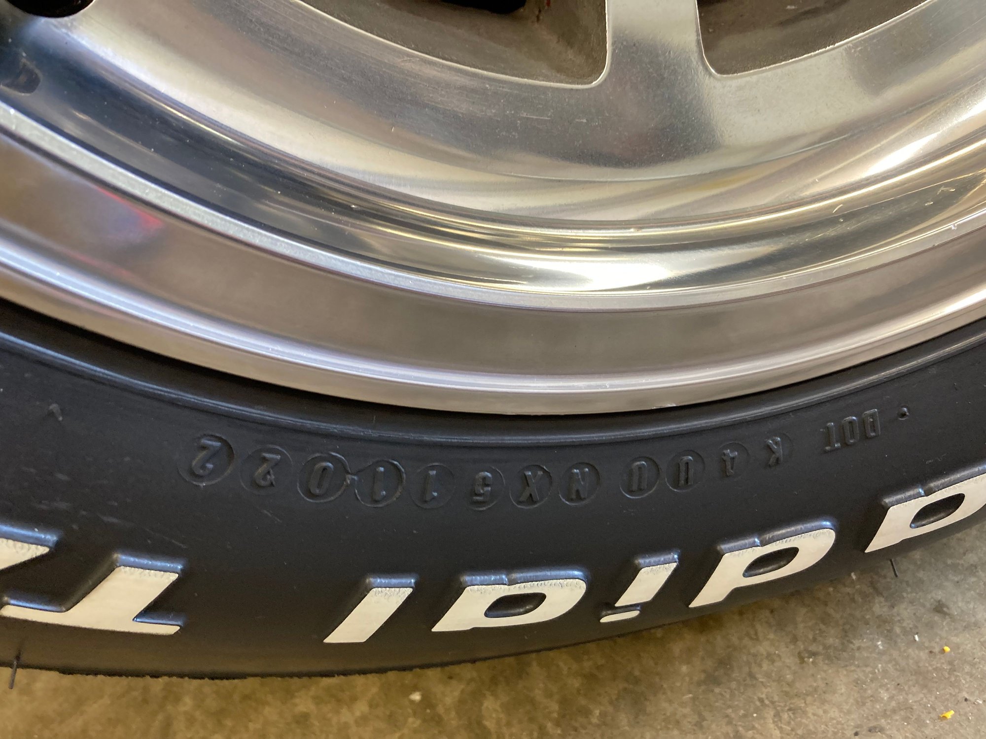

one new tire was 10 pounds on force balancing, and the other new one was 15 pounds after moving tire to get there.. they said they used to put red dots but these did not have them..
old brown letter tires were 12/2017, new tires were march 2022 and NO country of origin!!???
will see how white they stay...
edit…inside of tire made in Mexico
