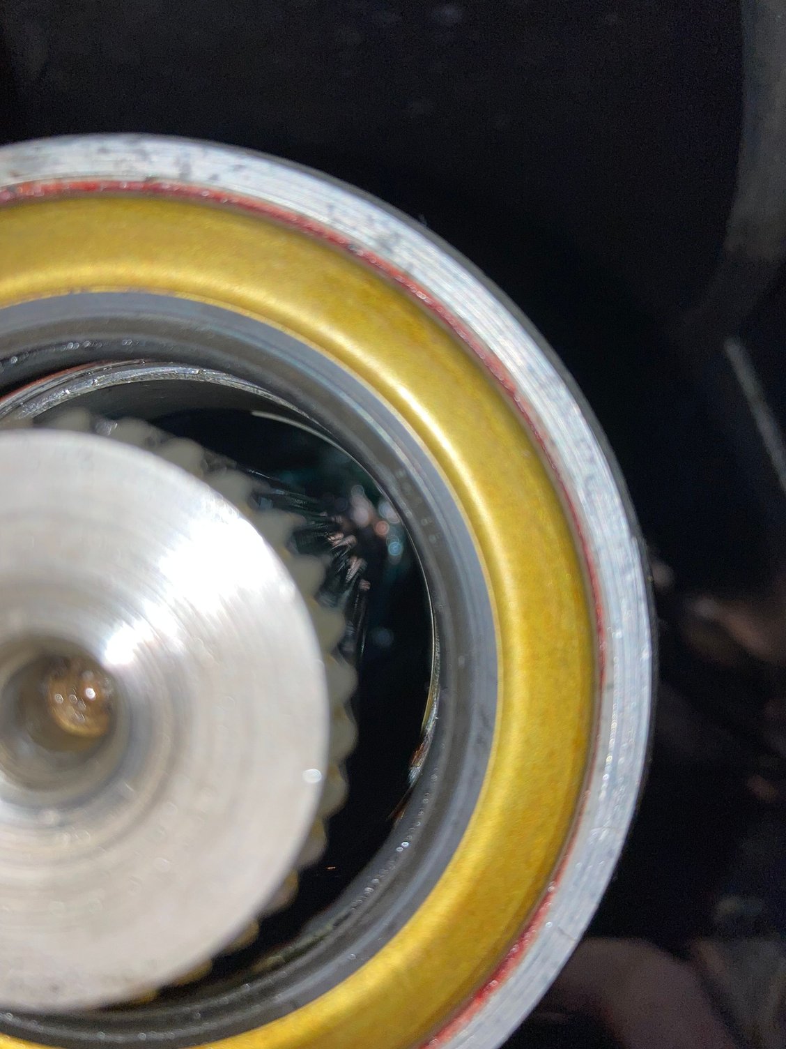

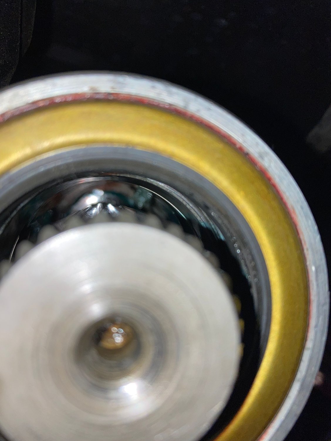

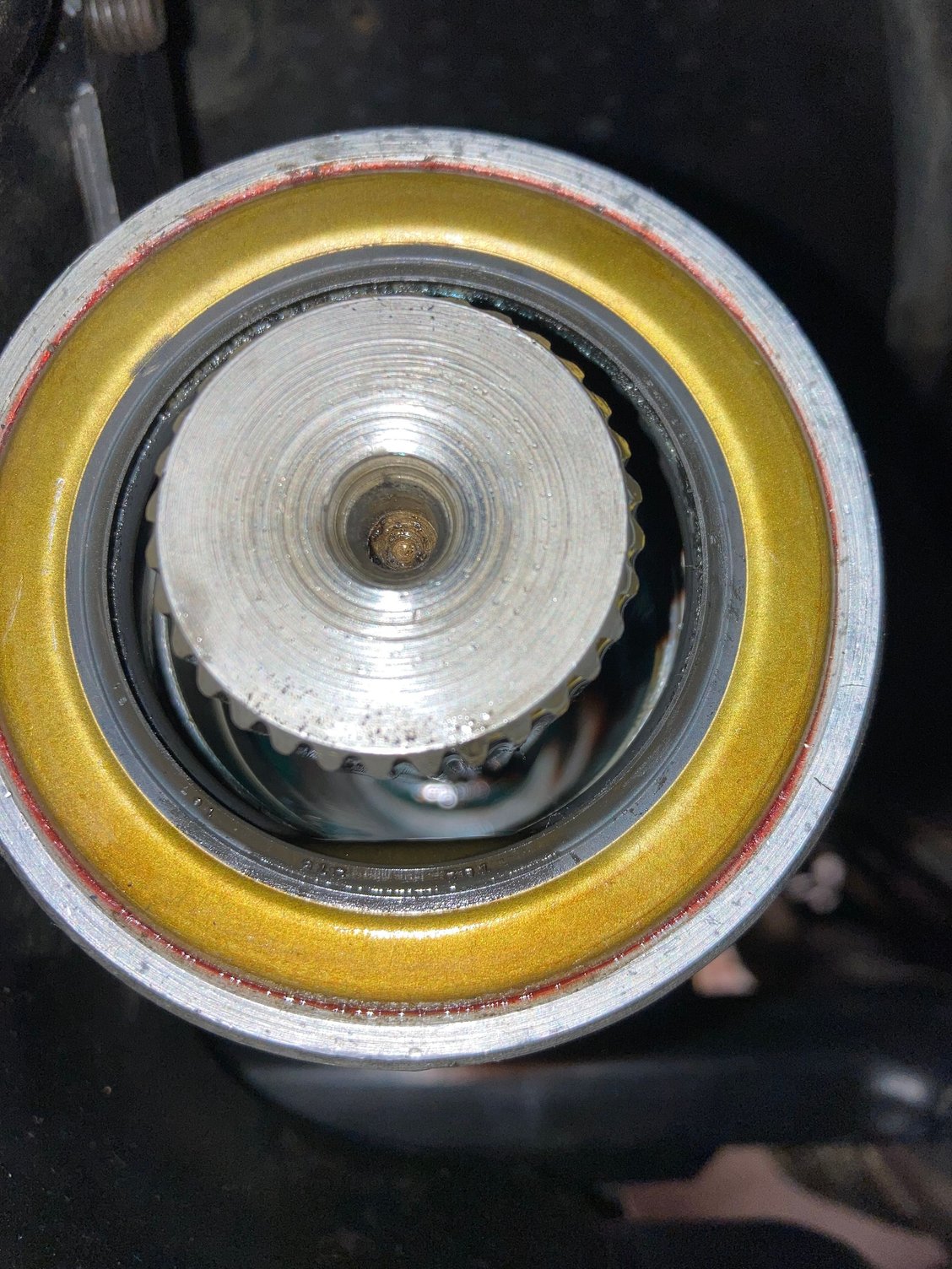

still chasing high speed shifter car vibration buzz over 70. It is like a cheap massage chair at 90 and noisy...
pretty much rehabbed / replaced balanced everything but driveshaft ..
only in 4th high speed, all other no issues..
I am calling around to driveshaft places to see if they will balance..
as far as i know i aligned the driveshaft and yokes as they were removed.. and when replacing u joints etc.. marked. the car always buzzed at high speed since i got it. even rebuilt transmission (bad input bearing at neutral clutch out)
Questions
- has anyone sent theirs out? what was reason/ result?
- do you bring them the driveshaft with all u joints and transmission yoke? they will balance with all?
- will i screw something up or is this another rabbit hole?
thanks!!!

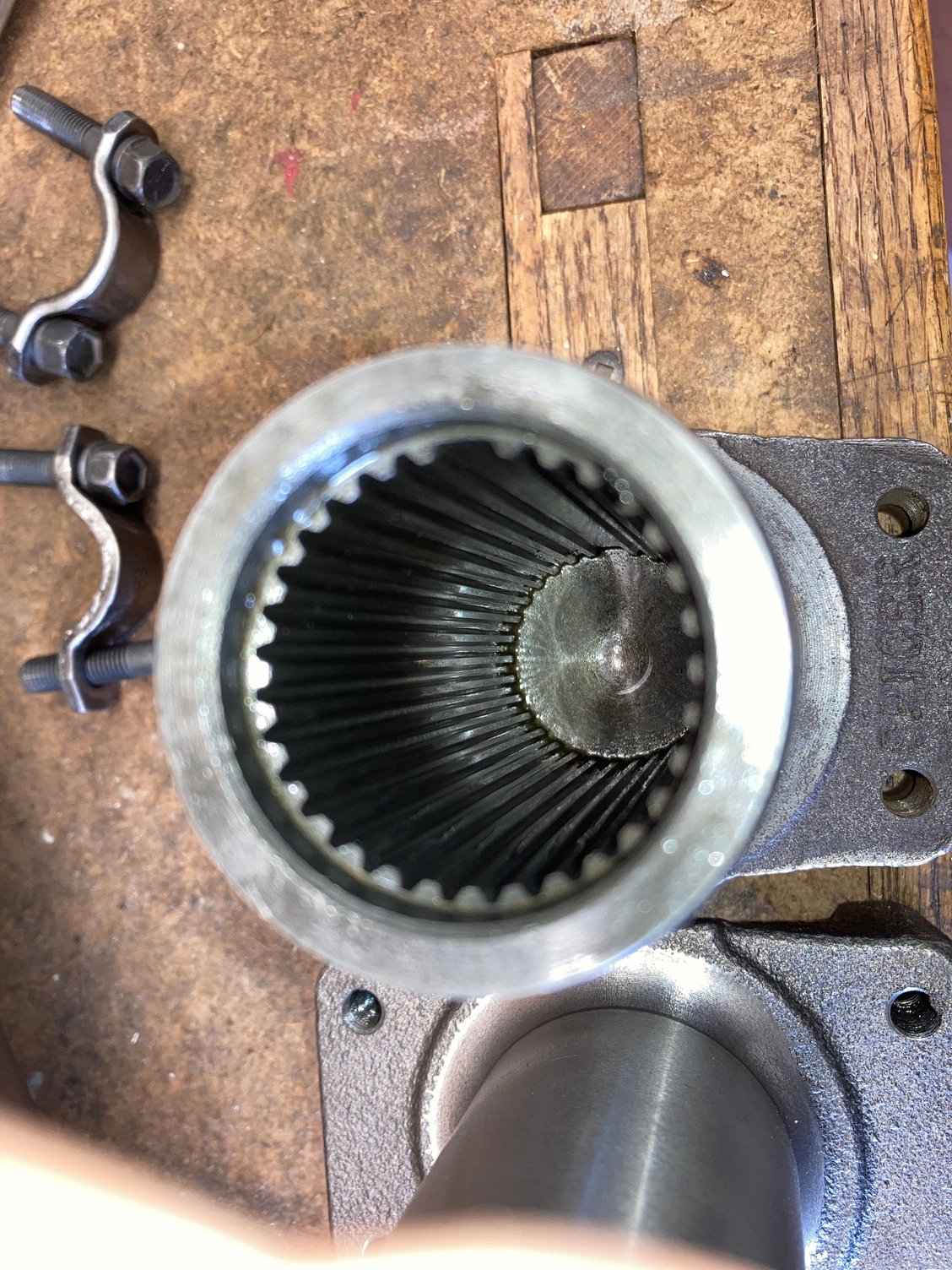

took to Indy axle and drivetrain.
got a call and they said the yoke is a problem, it has a spot on it as it goes into transmission that will cause a vibration. Offered a yoke but would need to adapt to a smaller u joint????
i said can i buy the right one and they will use they said ok..
not sure what is wrong with it but hoping my issue..
ONLY ZIP had the part..i called many

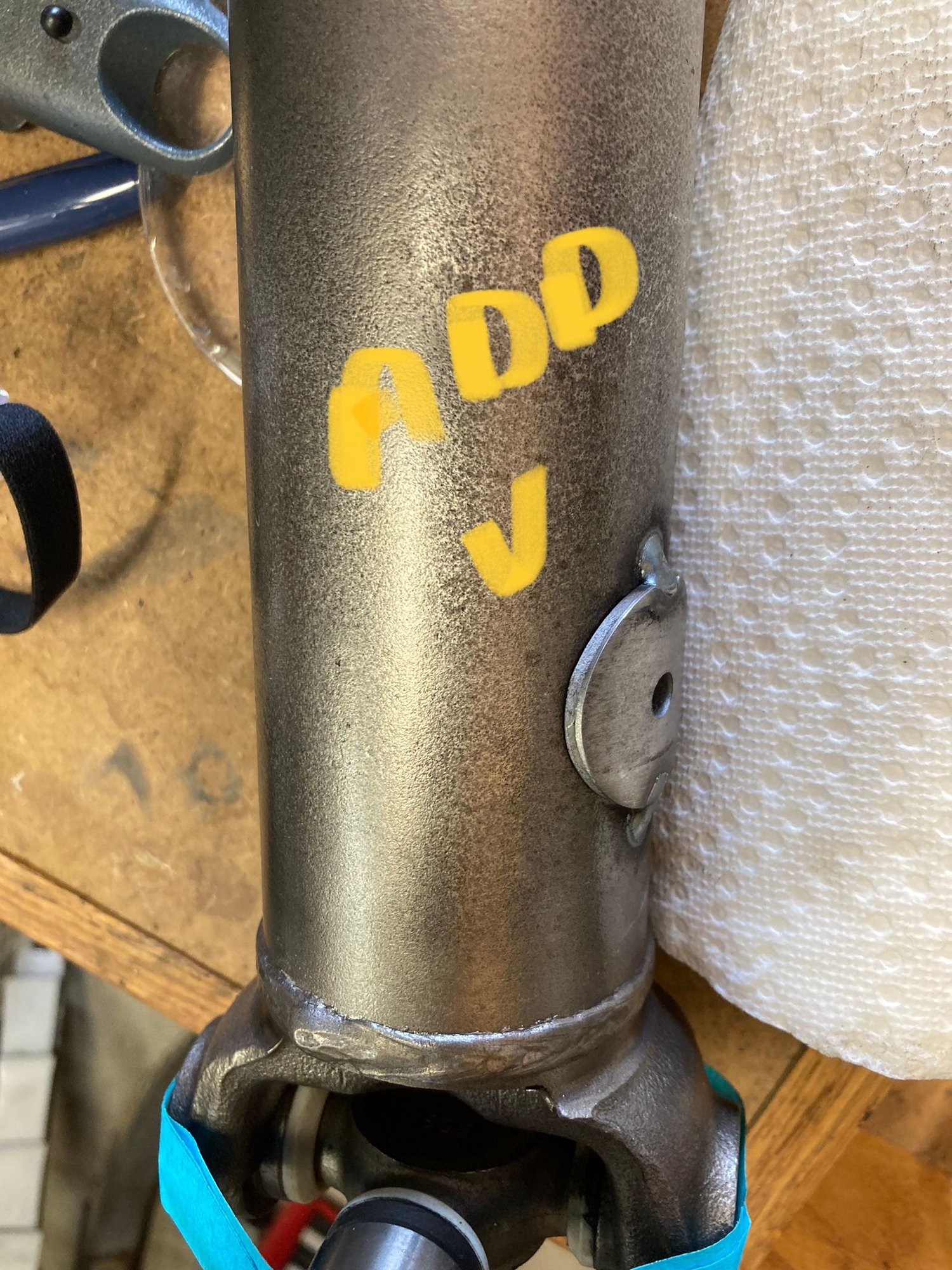

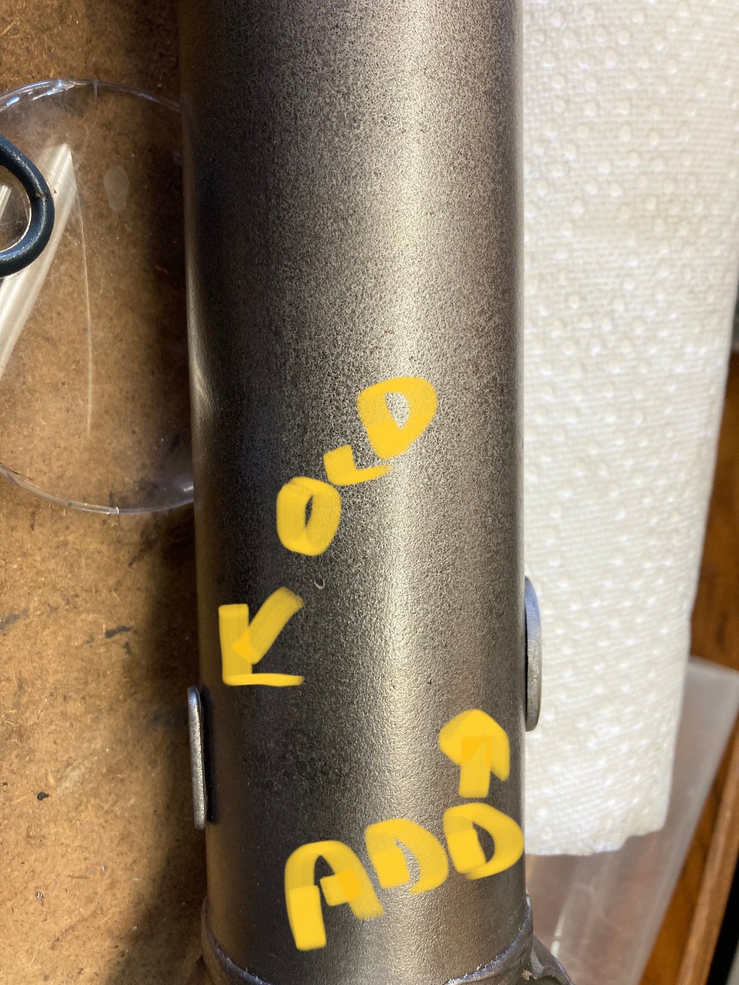

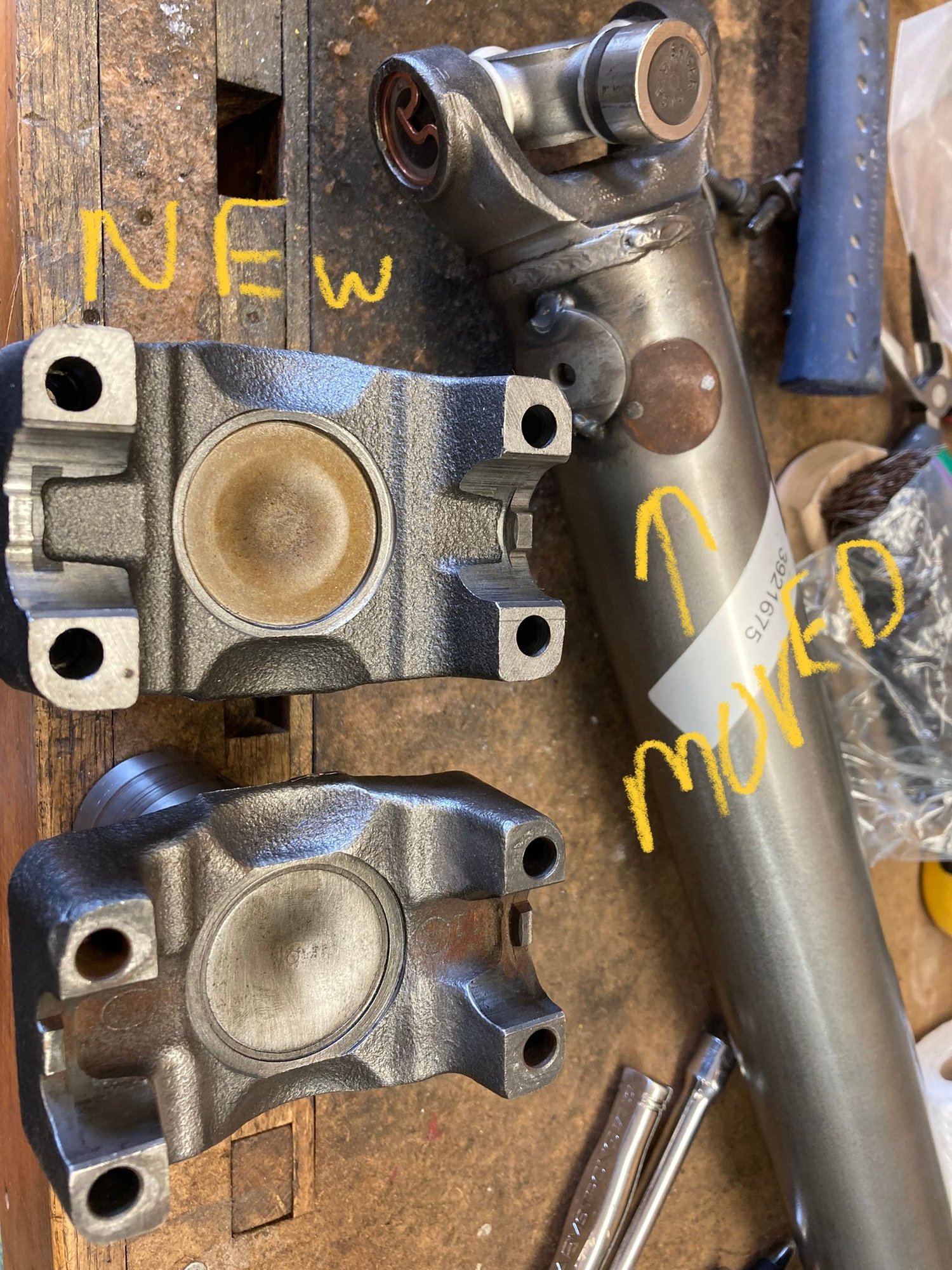

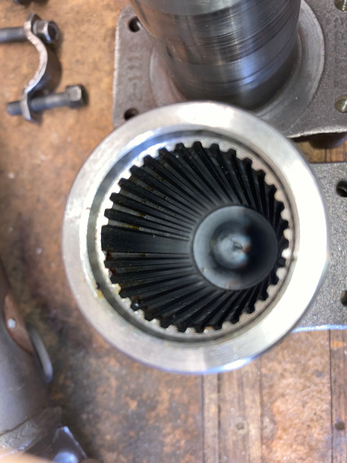

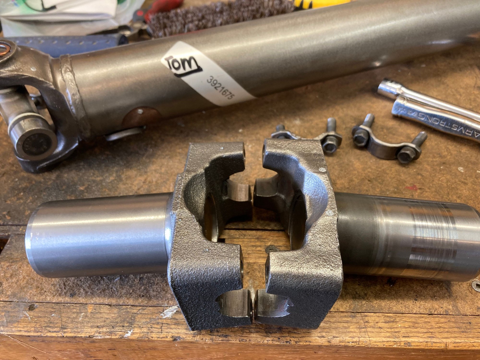

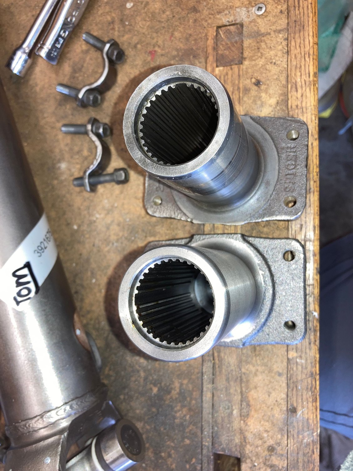

ups 315 from zip my new usa made yoke, 30 minute to shop as they held my driveshaft all week,
430 done.
i verified he said again it would vibrate at high speed with the old yoke..new no issues in his machine i assume because he balancd it. 95 bucks from day one and 95 when i left..and a tip.
weights noted in pics, added one across from factory square and moved the original round slightly.
measured outside shaft new and old..identical. I really cannot visually see anything.
seems tighter and driveshaft does move but mich less when lifting.
i totally misplaced my straps for differential end..i hope they are same front and back! Zip came with straps and bolts and so did the balance shop. I must have lost a set!

Pleased to report success.
smoother at all speeds..rearview mirror headlights start to distort at 95 bit still zero vibration on car or seat. That damn shifter still rattles but a finger holding down stops it which I couldn’t do before.
highly recommend this place if indy or looks like sameday mail.
i guess if you change u joints or cannot remember if driveshaft balanced , a worthwhile effort.
