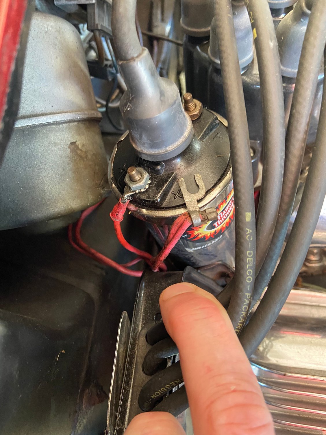

Well, I’m embarrassed to admit that it took me this long to figure out the problem. I tried replacing the fuel filter last week, and that changed nothing. Then I took the car out, and the engine just died. Fortunately it was down the road a few hundred feet, so I pushed it back into the garage (with help). But nothing I did got it to restart I ran out of time and finally came back today. Thinking it was possibly a bad coil, I took off the chrome ignition cover, and found this. So I’m guessing this wire was loose and was getting pulled away from the coil on acceleration. Then it just finally pulled off, which is why it wouldn’t restart. I’m just glad it was an easy fix.

Whooo Hoooo! it's great when it's something simple and you found it fairly quickly.

Thats great!. Back to driving without spending a dime!!!!
