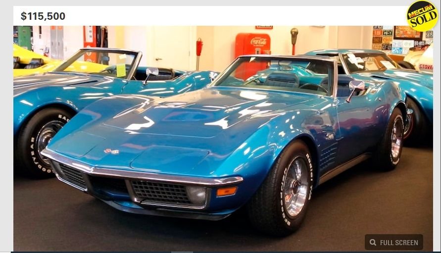

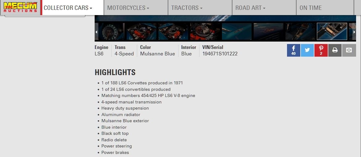

Currently on Bring A Trailer, In the comments section on a real nice white original LS-6 Convertible, a guy had written comments about his own personal 1971 Blue Convertible, Vin 194671S101222, claiming it is a LS-6, with some different engine stamping that was "verified by a Ex Bloomington Gold inspector" there is no such person, his Blue 71 is listed on/in the C-3 registry, no LS-6 cars were built before very late February early March 1971, his car was built in September of 1970. Vin 101222 is in the C-3 registry & shows a photo of his engine pad, major problems with the pad, the "W" in CPW is stamped with a half "W" which is wrong, and the Vin stamp starts out with a "7" and is short one digit, should start with a "C" and have 10 digits, his starts with a 7 and has 9 digits. So a very poorly made up car that was sold in the Mecum Auction at Rick Treworgy Muscle car building in 2021. Not nice that the guy mentions someone from Bloomington Gold verified the pad, nobody with any C-3 Corvette knowledge, either NCRS, or Bloomington, would ever think that the engine pad is close to being OK. Thanks Jim Wallace

when it sold at Mecum in 2021 I had seen in photos' the small w, and other items that I thought were very strange on the Vette as a LS-6
I think someone paid $110,000 or $120,000 for it at that time.

so, what is this? a CPH LS5 car with bodywork done to the pad to restamp it as CPW? and get somebody to give him an eighth of a million for a 40 or 50k car? restamp cuz you want the right numbers and restamping for profit are 2 very different things. like paying 15k for a 2 carat hunk of cubic zirconia. of course the buyer is supposed to do some homework...

Lot B17 Rick Treworgy's Muscle Car City 2021 Jan 22-23
1971 Chevrolet Corvette LS6 Convertible
454/425 HP, 4-Speed, 1 of Only 188 Produced in 1971 No Reserve

Thanks for the reminder. The thread here was back in January, 2021, when the car was in the auction process. It is a bogus car, no doubt. The first LS6 was in the 10900 range. 1222 is MUCH too early to be an LS6.

but somebody paid 115k for it? or was that asking price?

that was the sold for price...........

A fool and his money. Sounds like total fraud to me and will likely lead to a long and expensive law suite.
