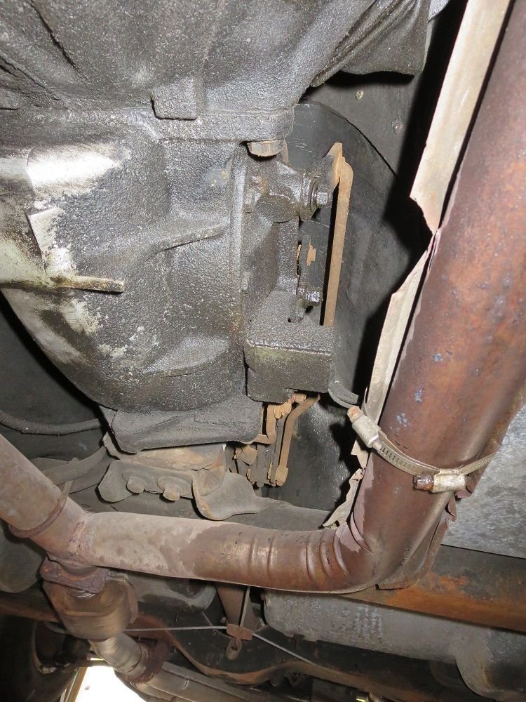

I found a photo! I think this part of my exhaust is stock (or at least stock routing and shields). My car had some creative "mufflers" when I got her.

Thanks! Awesome picture that tells EXACTLY where it is supposed to go! Jeez, mine is no where near where it needs to be, it is right there at the torque converter. We'd have to disconnect the exhaust system to get the torque converter on. I don't like the idea of it being there by the transmission pan now that I realize what is going on.
