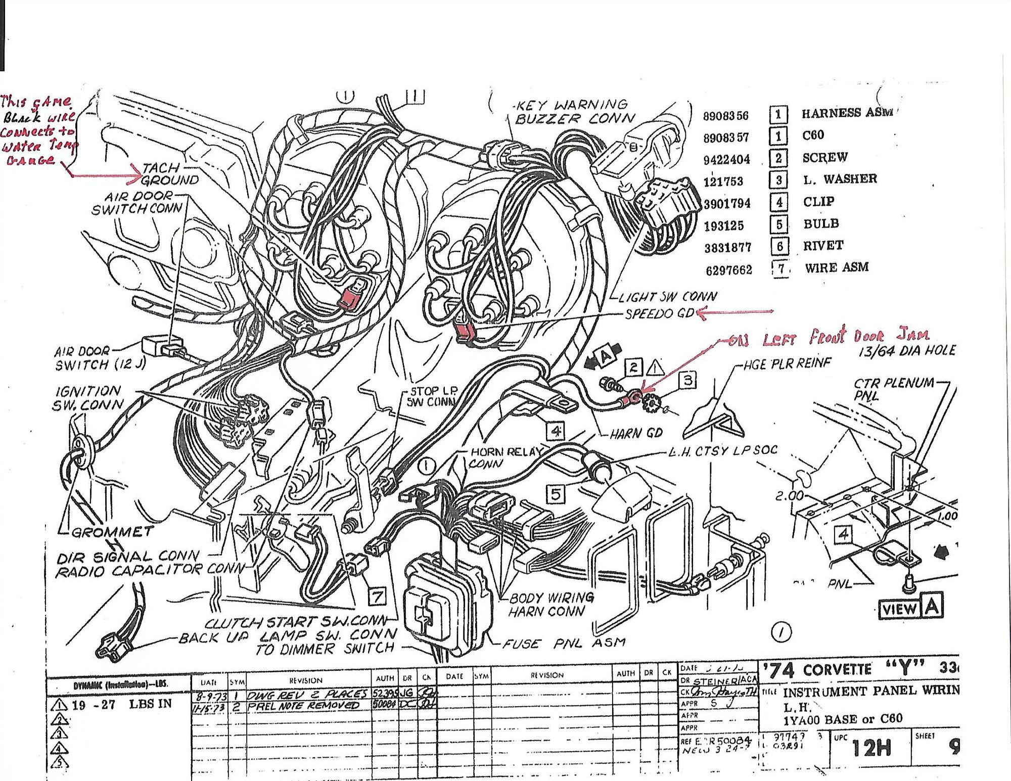

I recently bought a 74 c3 that I'm tearing into and need to know what stock looks like behind the dash and instrument cluster alls well as h-vac lines for air. If anyone has pictures that'd be great !

Contact 'Papawa' in the general section and get a '74 schematic.
https://www.gmheritagecenter.com/gm-...tion-kits.html
Disconnect the battery before you start.

Here, I hope this helps.
