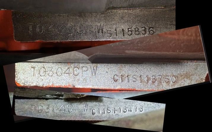

Here are a few stamps to compare. Stan I think you know the 13750 car, it had a really good restamp. Car 15836 has an original stamp verified by Al Grenning.

The red flag with restamps is the S in the VIN. The restamps have gotten better, but the S is still off in the "good" restamp above. Almost looks right, but no.

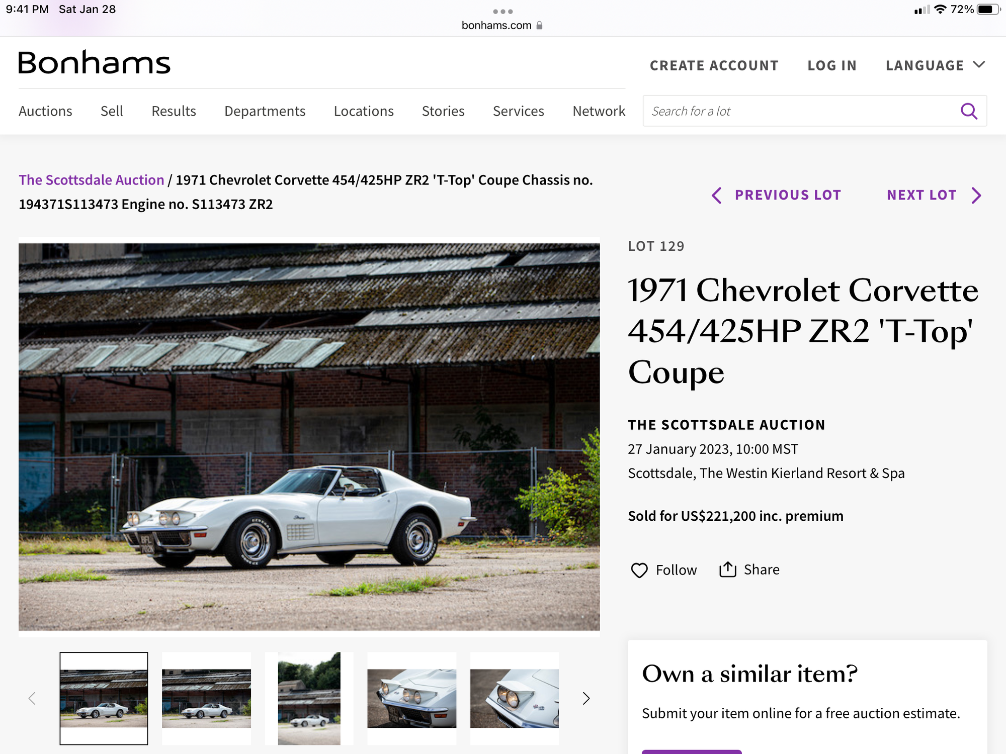

Just for anyone interested, the car is at auction with Bonhams tomorrow @ Scottsdale
https://www.bonhams.com/auction/2800...o-s113473-zr2/

Old Jan 28, 2023 | 09:42 PM
jr9170's Avatar
jr9170
Joined: Feb 2003
Posts: 13,238
Likes: 1,092
From: YANKEES UNIVERSE 70 454-LS5 500 ft-lbs Torque
