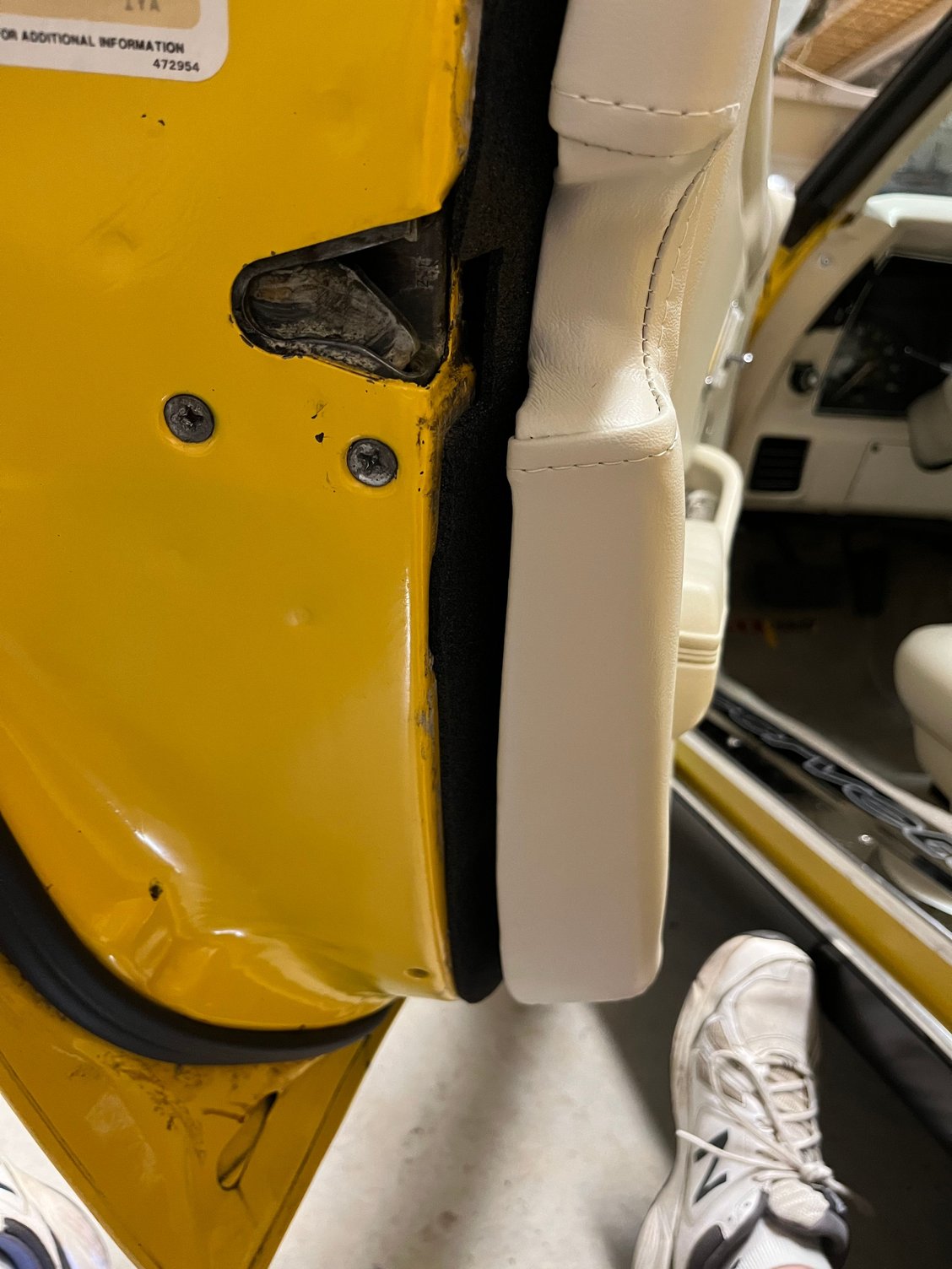

Installing new door panels on my 1980. Everything went well, but the bottom ends of panel toward rear stick out about 1". There are no screw holes or retainers on old or new. The lowest rear screws are on the arm rest. (I know that prior to '78 retaining clips were used in this area).Looking for ideas as how to best fasten to door in this location.

Is there a screw located in the carpet area to the rear of the panel ?
Seems very odd you'd have this gap.

No there was not on the original panel. Also the corvette assembly manual page 290 does not show a screw on the rear part of the panel.
However, the Wilcox diagram you sent shows a screw on the rear. I will take the panel off again and see if I can find a screw hole. Maybe I have to drill one.
Thanks for info.

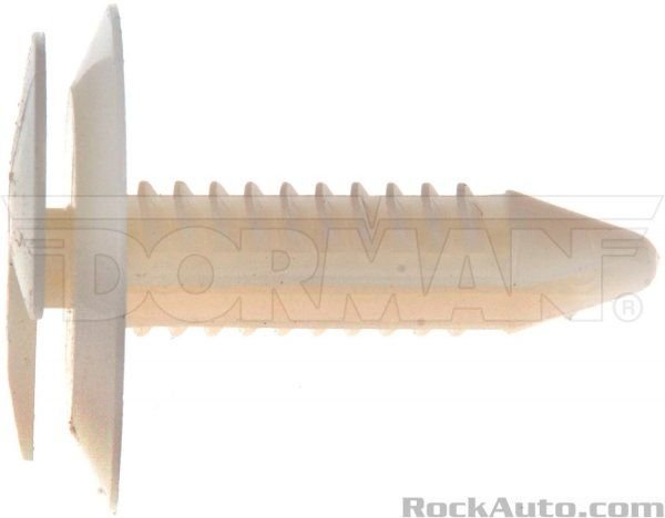

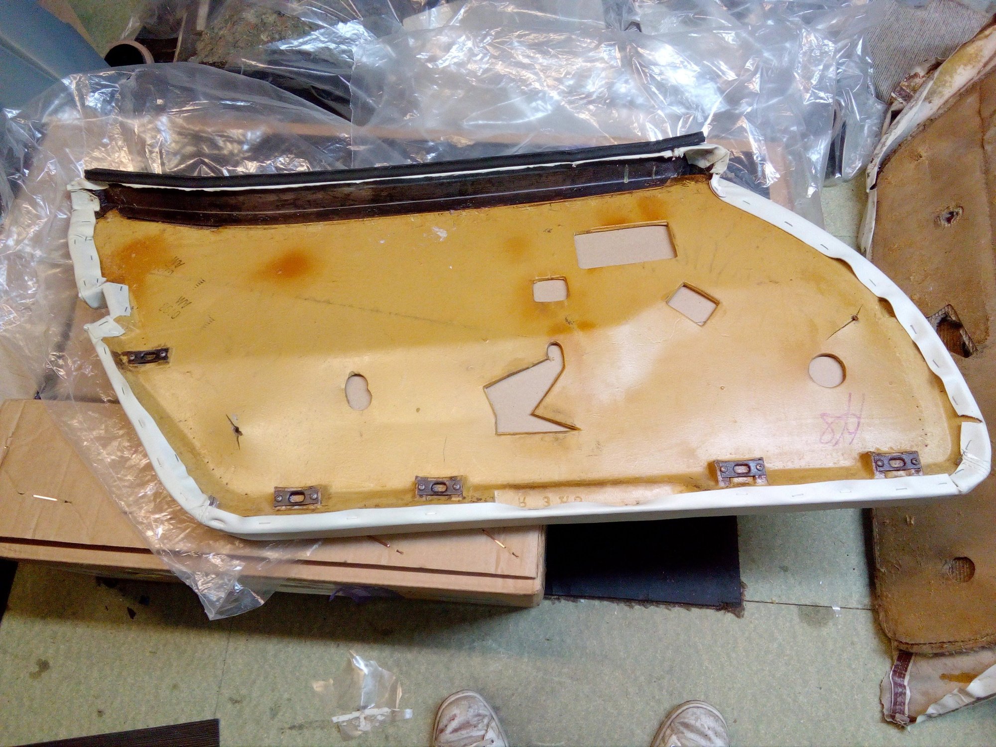

My 78 has clips like this that fit onto the metal plates on the back of the door panel and push into the holes in the door.

Thanks for the info. My 80 door panels do not have the metal tabs for push pins. Old door panels did not either. I thought they were similar to 78's but apparently not.
