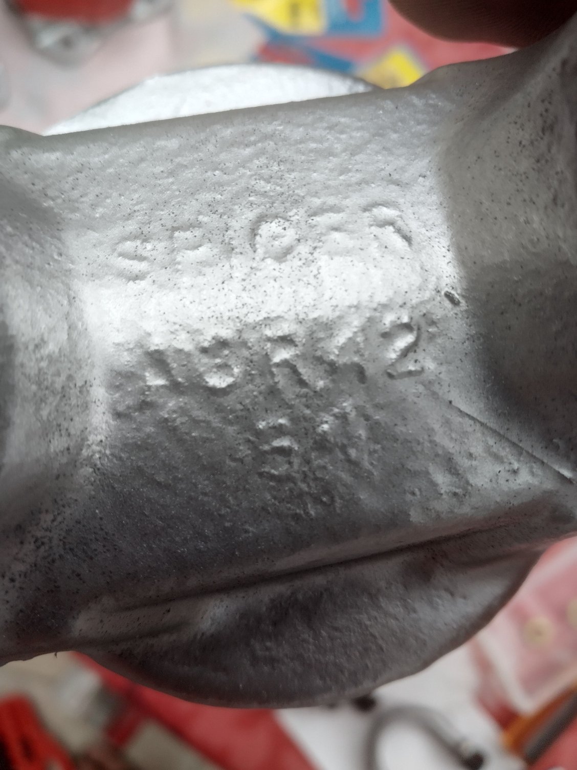

1) When installing the first u-joint I bent one of the plastic grease seal on one of the caps (see pic).
The rest of the installation turned out fine. Should I still use this U-joint or buy and reinstall a new one?
2) Is there an 'out' and an 'in' side on the half shafts? Or doesn't it matter which side goes on the differential and wheel side?
I don't see any markings. The model is 'Spicer A3R42-54' for the halfshafts.

I feel your pain. I did the same thing on my first U-Joint install.
I would think that as long as the needle bearings are in place as they should and no grease is leaking you should be OK. Can you still rotate the U-Joint with out issues?

Yes, I can still turn them.

Looks like teflon. If it is, let it sit a couple days see if it straightens out from its own 'memory'. Otherwise, hit it with a hair dryer, warm up the seal and just press the seal with your fingers. Maybe it'll un-deform. I wouldn't put too much heat on it (i.e. heat gun) ..could damage it worse. Most of the sealing portion is probably inside the area you see. Most Corvettes are garage and trailer queens. How much rain are you going to run it in? Not much. It'll probably last 20 years. If it bugs ya, yeah, replace it.

I installed the half shafts, and bought a new U-joint.
The deformed teflon seal just did't change with the heat of a hair drier. I bought one new U-joint.

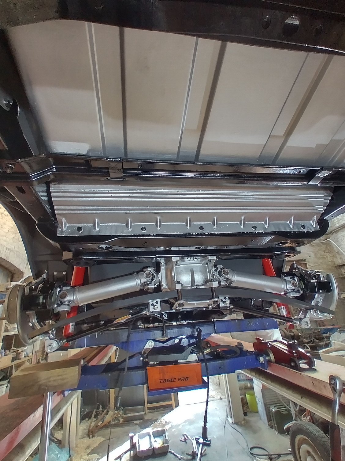

Here is a of where I am now:

Looks great! Now you have 3 spare seals! lol....
