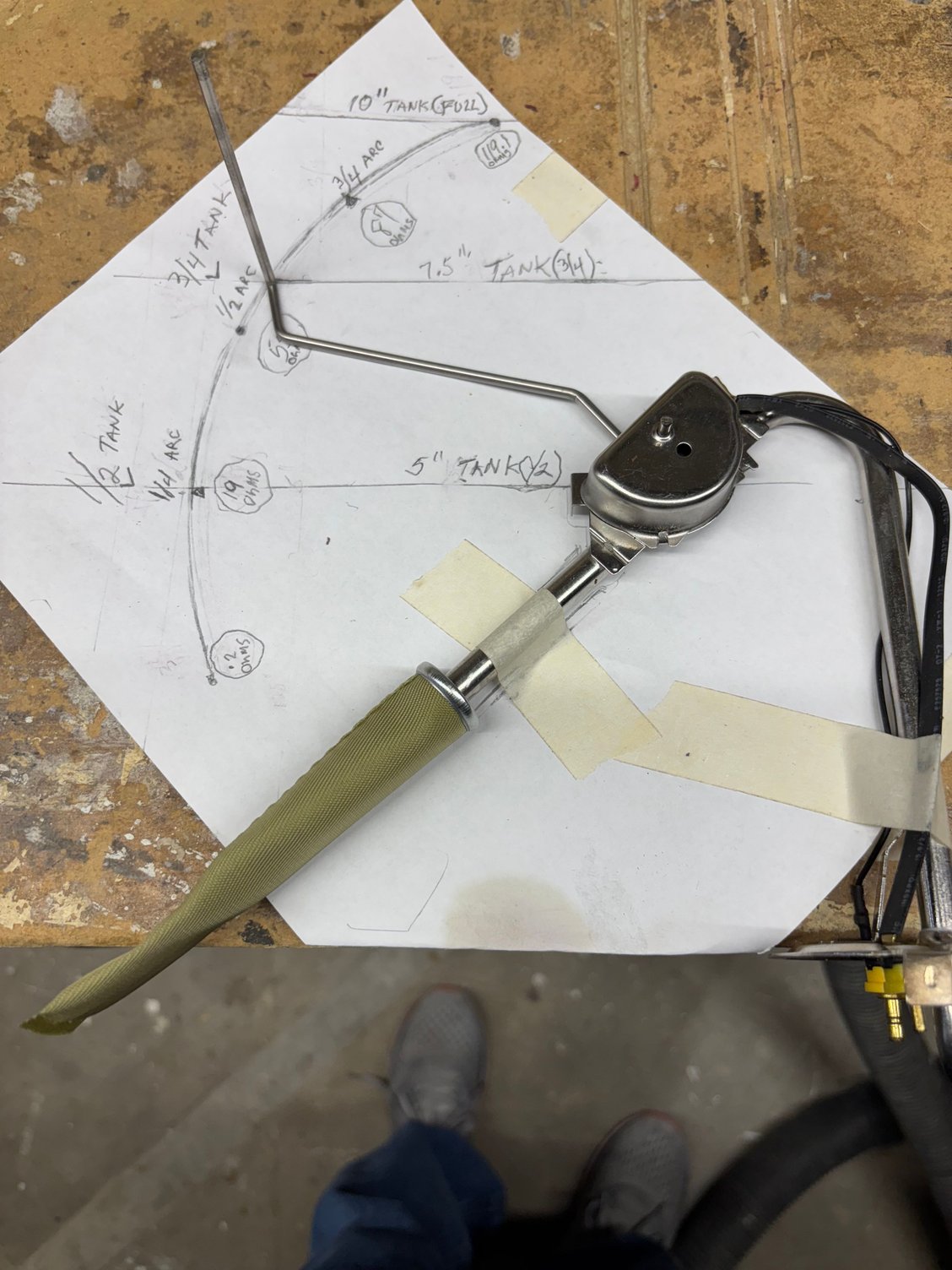

Does anyone have any experience with the 90 ohm c2 fuel sending unit from csmdowest? I have tested several 120 ohm versions and they are not accurate. They read correct (120 ohms) at full tank but at 3/4 tank they read approx 25 ohms. I have modified the float position and get a slightly better reading but still significantly off. I don’t believe they can be made accurate do to the position of the rheostat (sp) and the resulting arc of the arm. At mid arc position I get 60 ohms but that position is above the 3/4 mark and above 7.5” of gas in the tank. tks, jb
Note the float has been removed to enable reading the diagram I created showing gas tank level, max and min arc of float, and ohm outputs at various positions.
