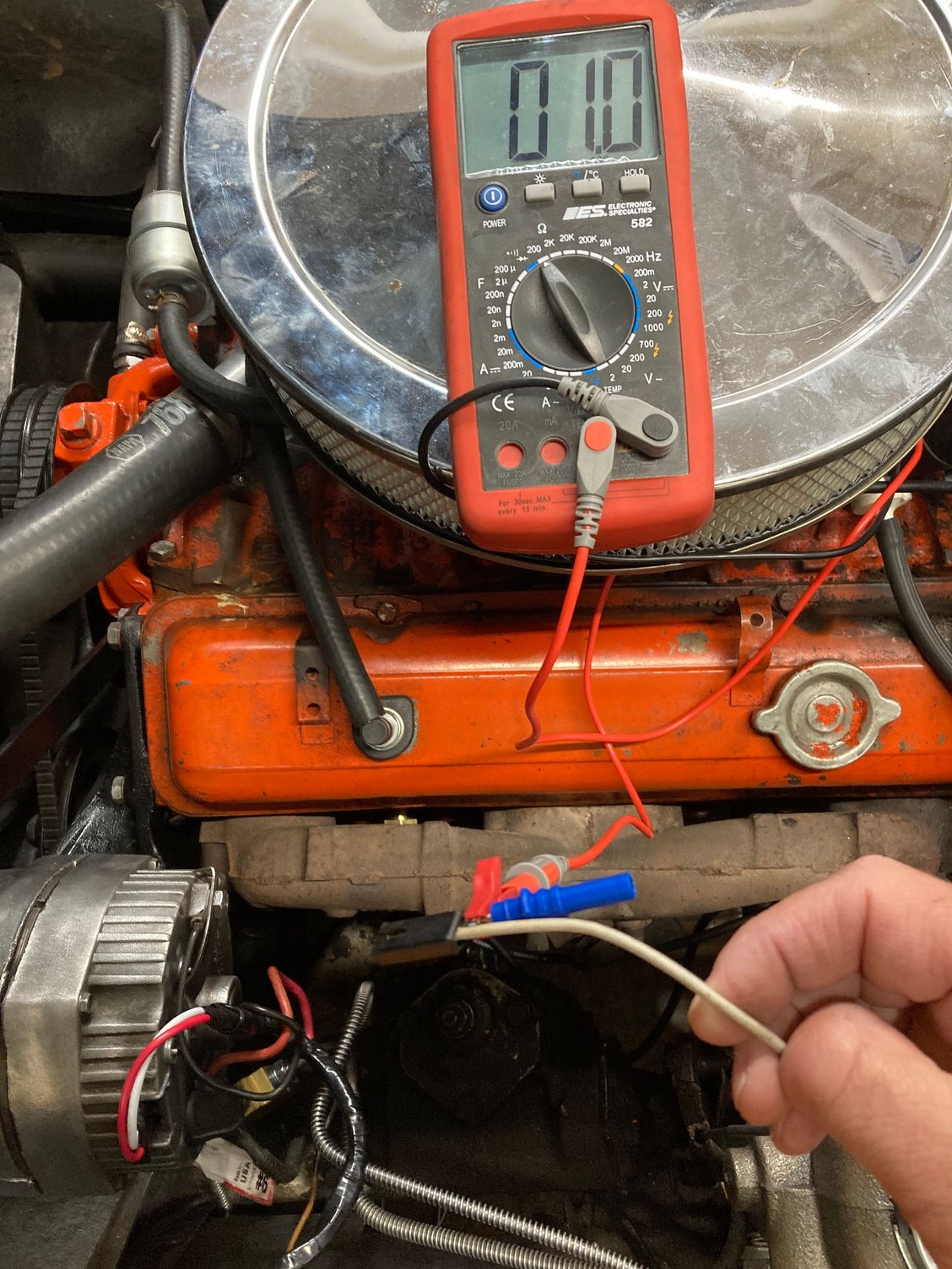

Confirming ohms wire from sender is good… 1 ohm resistance from terminal to the gauge.
