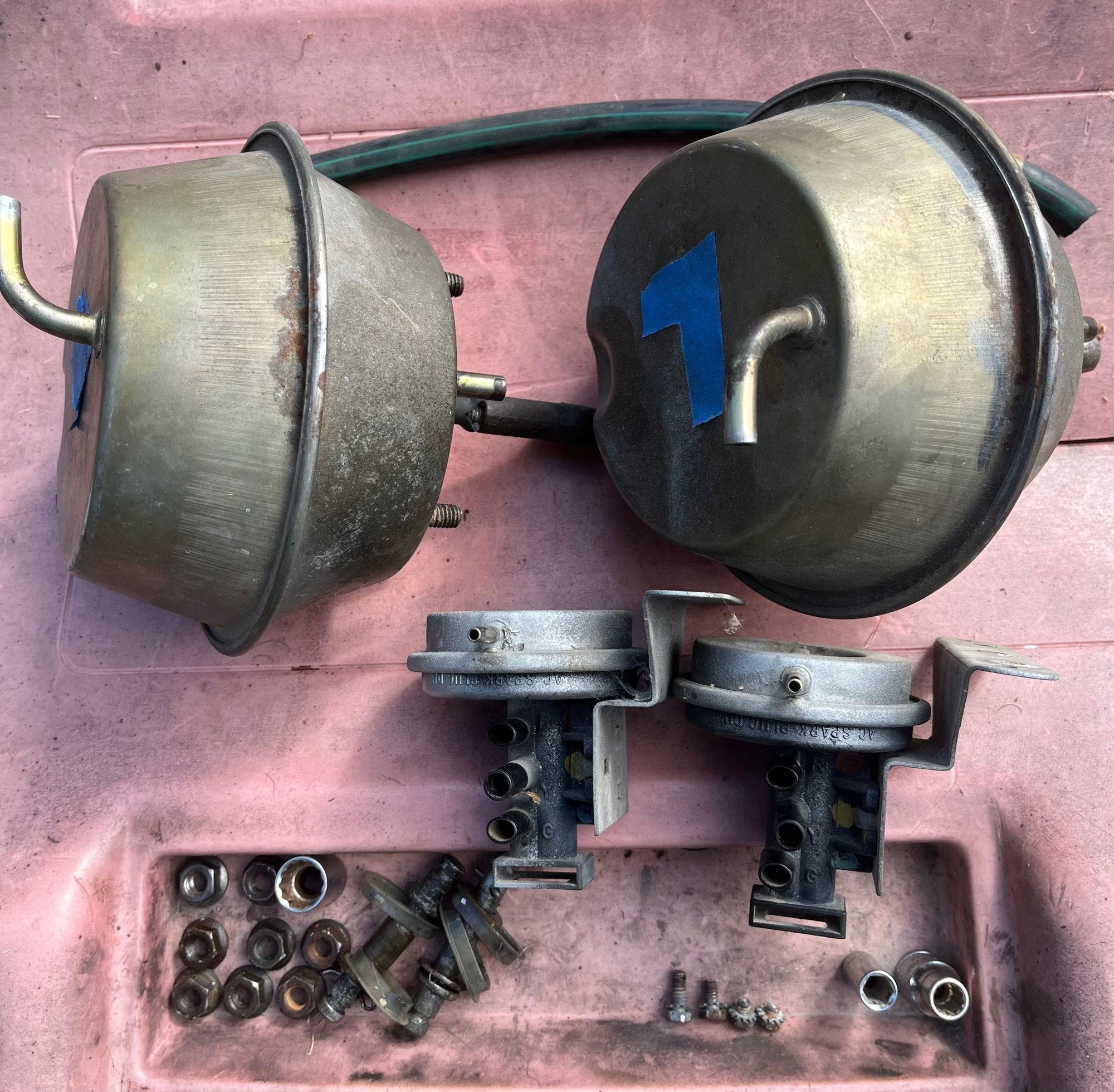

The goal for this week is to get the headlights working. I disassembled the headlight vacuum components for testing & cleaning. Unfortunately, three of the four bolts holding the relays onto the frame sheared off when I removed them. I’ll drill out the threaded holes after I get 4 new bolts.

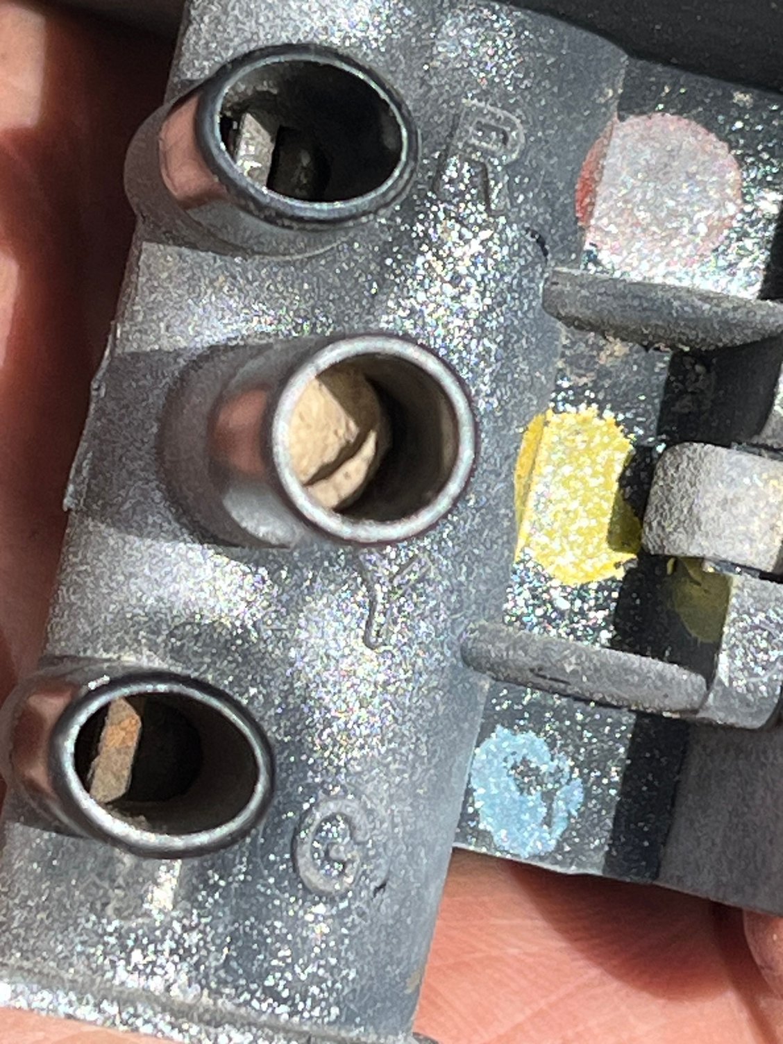

I probably never would have found the mud packed inside the relay by some industrious wasp if I hadn’t removed it from the car.

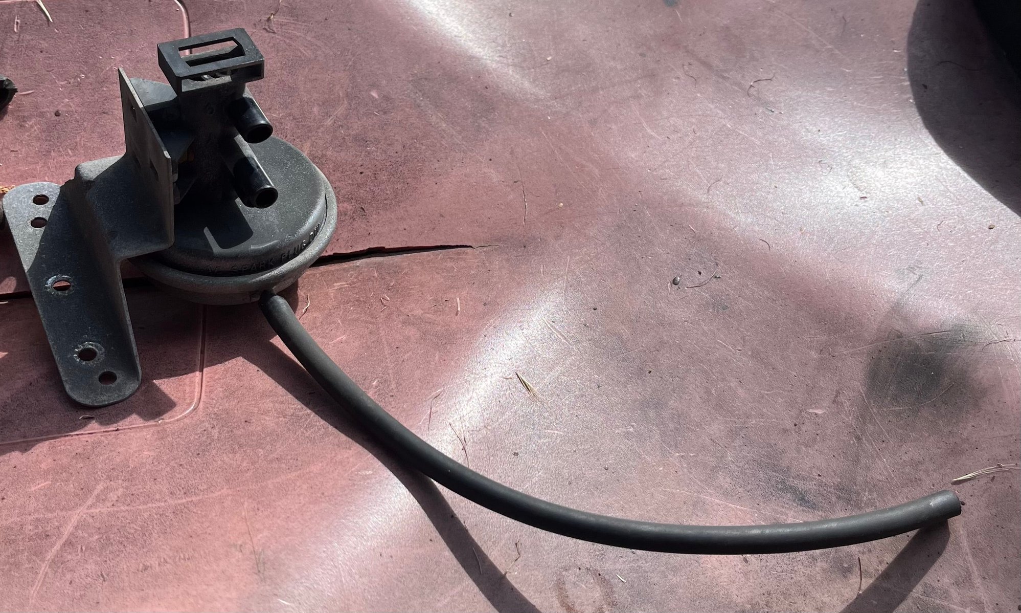

I tested both relays applying suction to a piece of vacuum hose connected to where the longest vacuum line splits & connects to the two relay diaphragms from the manifold.

I dont follow how you tested the relays but in the pic you have a hose connected to the metal port of the top diaphram. You should see the plunger go up inside the holes where the mud was...it should stay up indefinitely.
You should also apply vacuum to the middle of the three tube where the mud was and it should swap from bottom to top as you apply vacuum to the metal port on the top....

RE: testing the relays…
Thanks R2…exactly what I needed to know!
