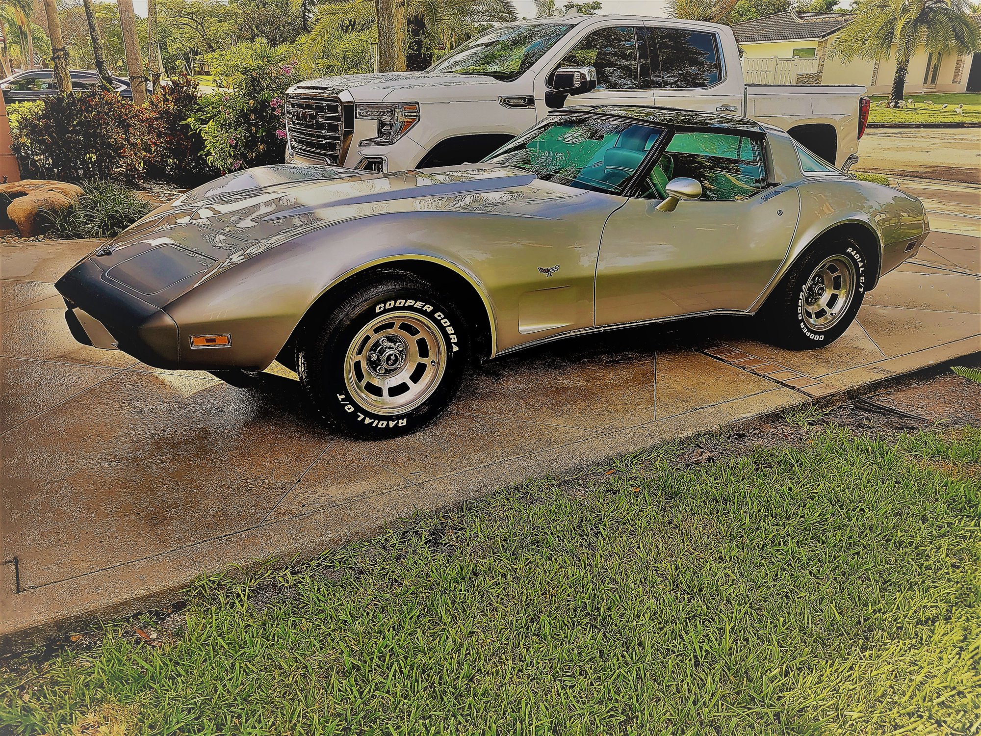

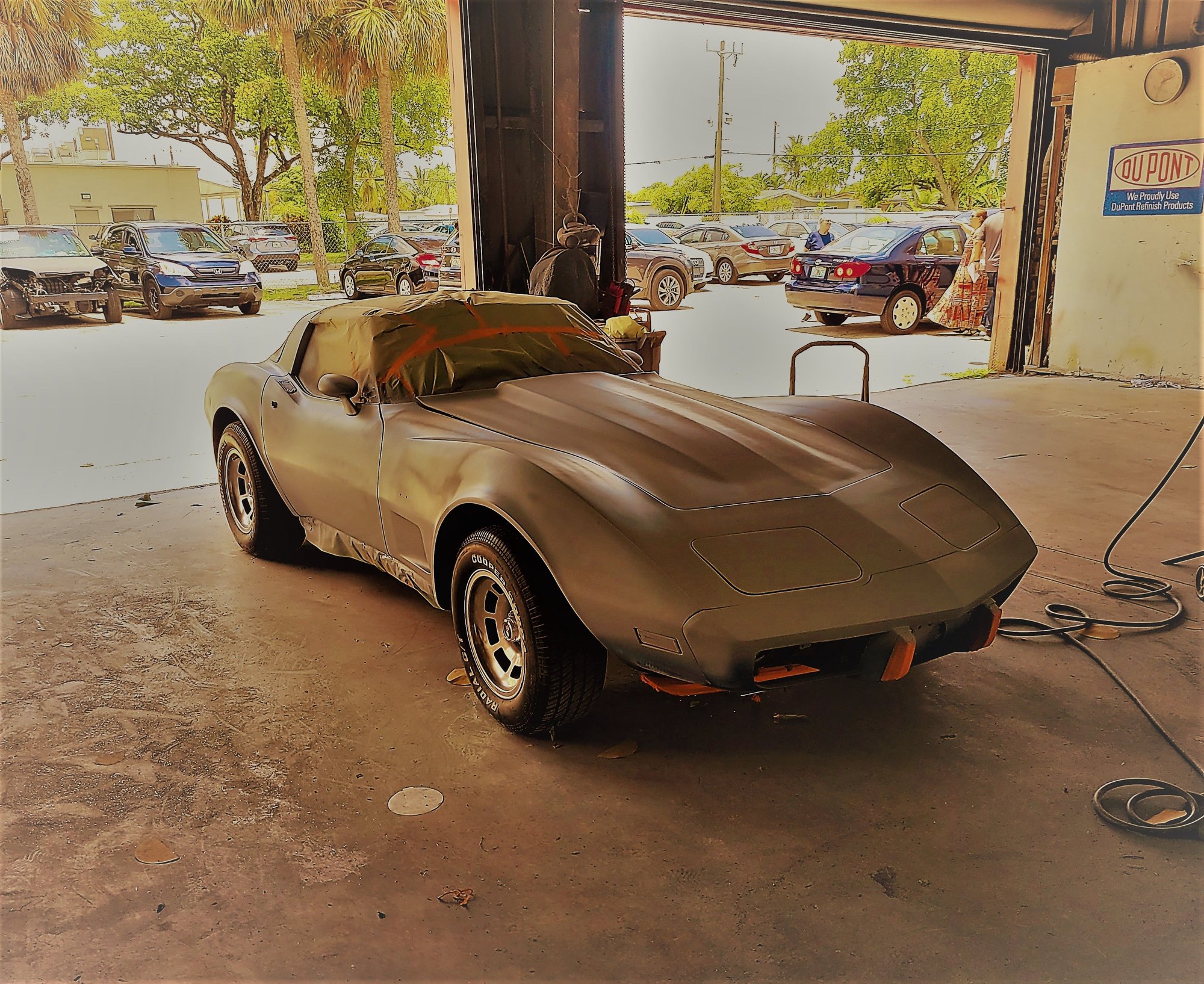

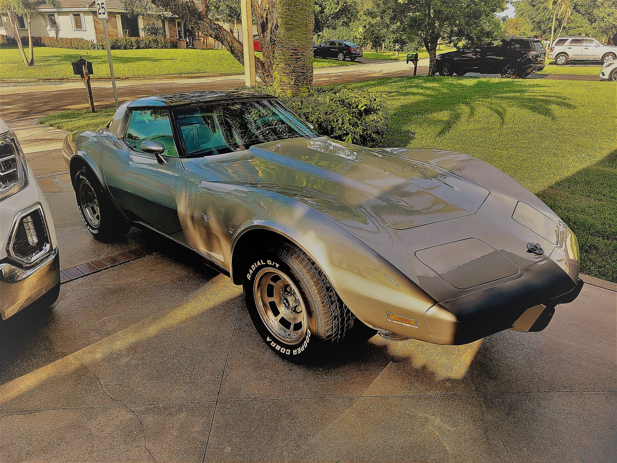

Back from paint shop looking really good

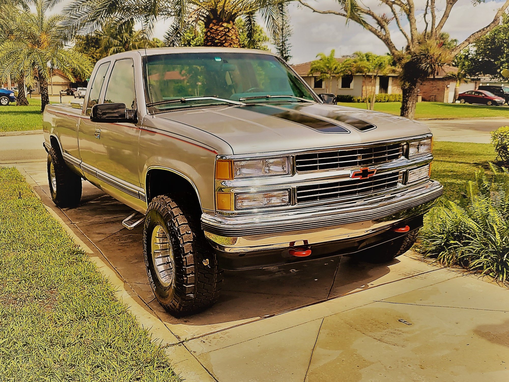

Same painter I had just did a truck it's not perfect but nice. I like the forum but sometimes I don't understand replies. I'm taken yours as helpful. I hope it was.

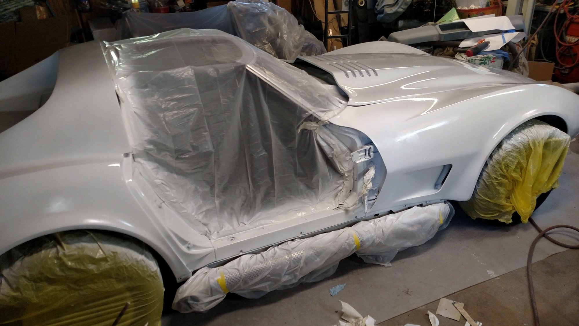

And how many you tube videos you watch before going nuts with you harbor freight paint gun... OP and anyone else thinking its out of reach...

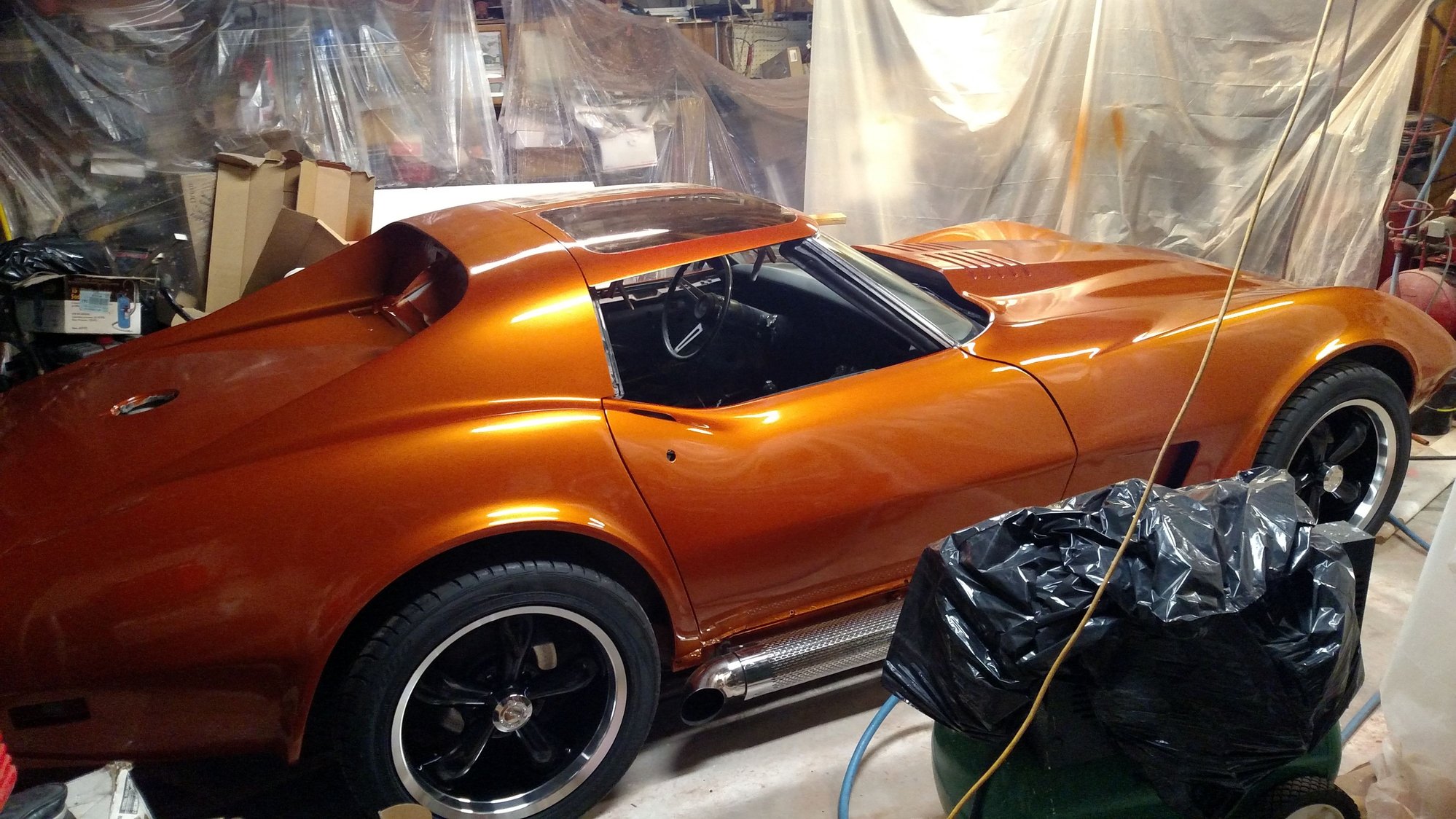

Dont let anyone discourage you into thinking a decent looking paint job needs to cost 10 grand. Looks like you already have the hardest part out of the way with the body and prep work which is 95% on the deciding factor on how the paint job will look. I learned of the first car I did before this one which was my old 84 c4... color changing chamleleon is not very forgiving to mistakes.

it cost me just over $800 to do the body work including quarter panel repairs and for the 3 types of primers, base and clear to paint my car but I wont lie, I spent 2 years stripping paint with a razor, doing the body work and painting it.... when it was done the satisfaction was worth every minute of it. Ive had people at cruise nights flat out call me a liar when I tell them I did it at home in my garage after watching lots of you tube videos. I used a $120 craigslist air compressor and harbor freight paint guns.
No corvette tax for me thanks.
