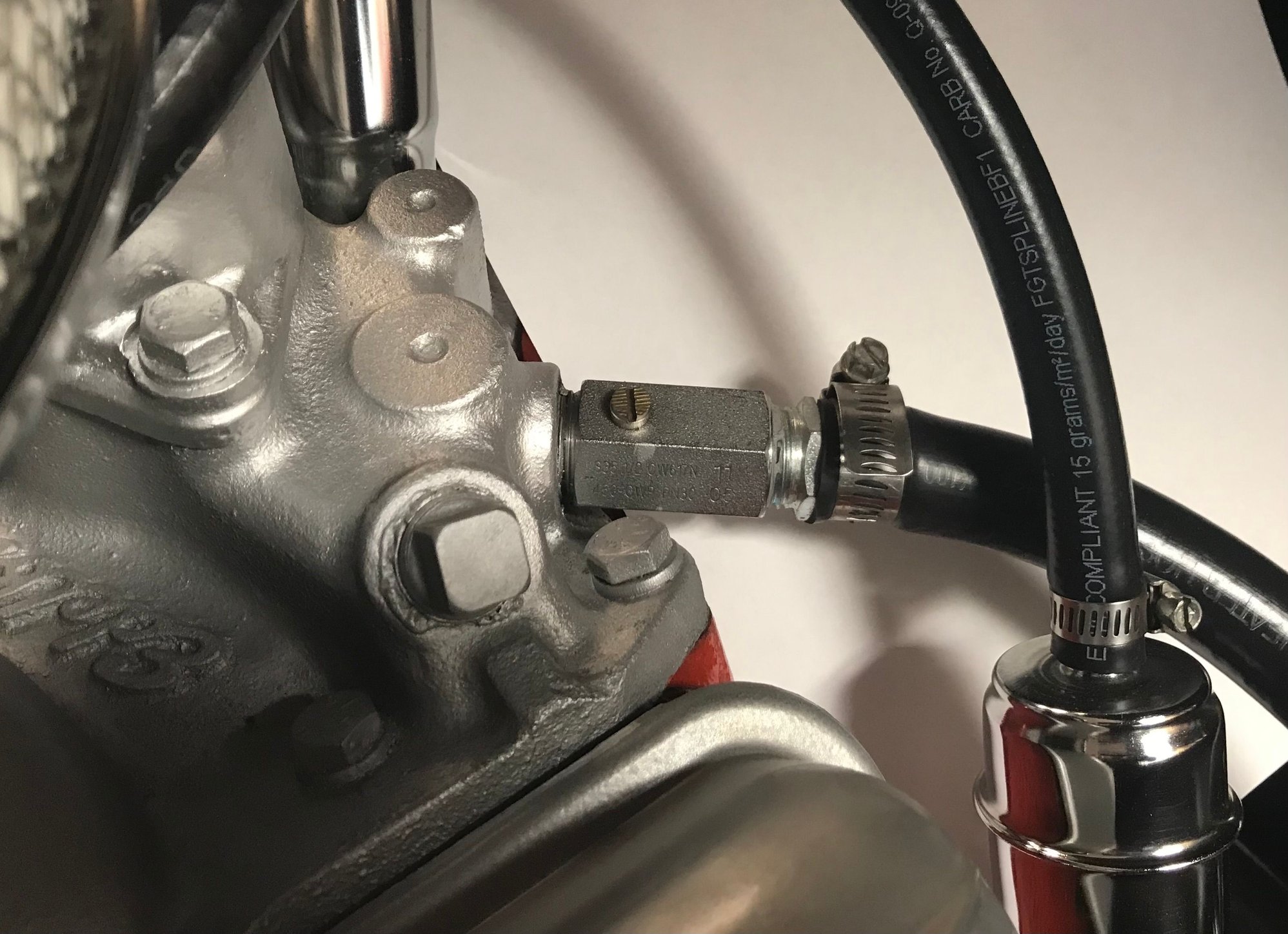

Not sure if something like this might work for you. Blade screwdriver to open / close a ball check valve. Installed this shut off on a '66 327 to cut down on the cabin heat. Works great, inexpensive, easy to install. Bought the parts from McMaster-Carr about 12-years ago.
To Heater core by-pass
