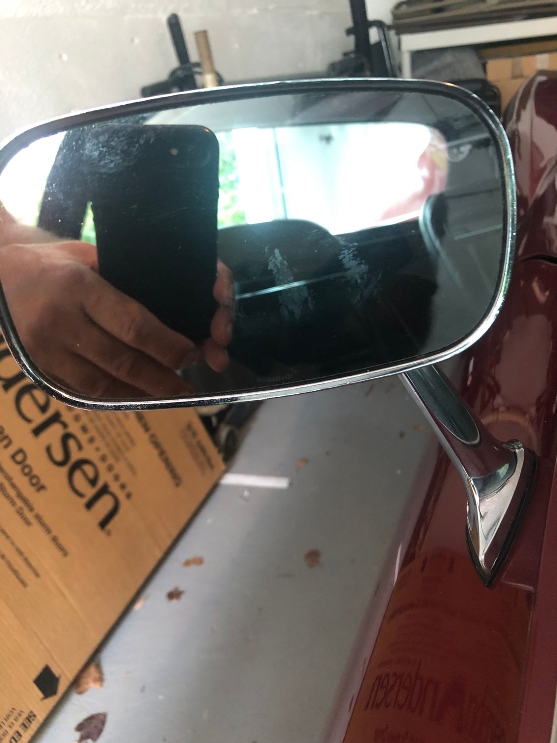

Hi all, can anyone ID my 75 driver’s mirror .. my car is very original preparing
for NCRS judging in November. Thank you

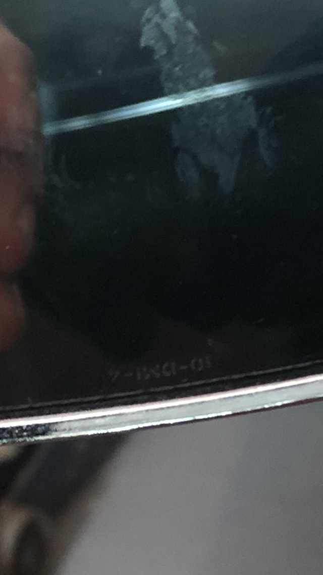

Looks like an October 1976 mirror. 10 DMI 6, right?

looks like 10-DMI-4

October '74 fit with your '75's VIN production time period?

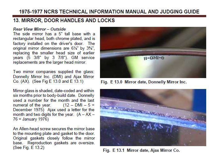

grady white -- your F 04 body build date translates to March 4 1975. The mirror date code can correctly precede the body build date by up to 6 months, according to the recently revised 3rd edition of the 1975-1977 NCRS Technical Information Manual and Judging Guide. A snip of page 84 is below: Your mirror date code of 10-74 fits nicely within the 6 month window.
