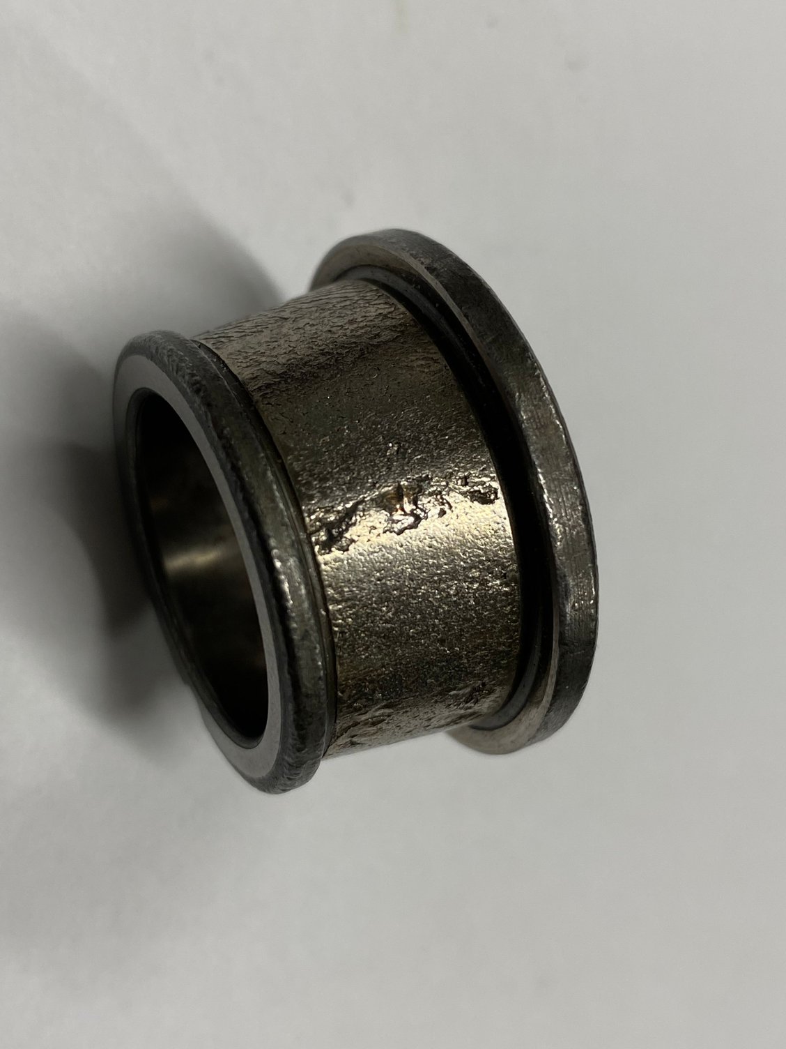

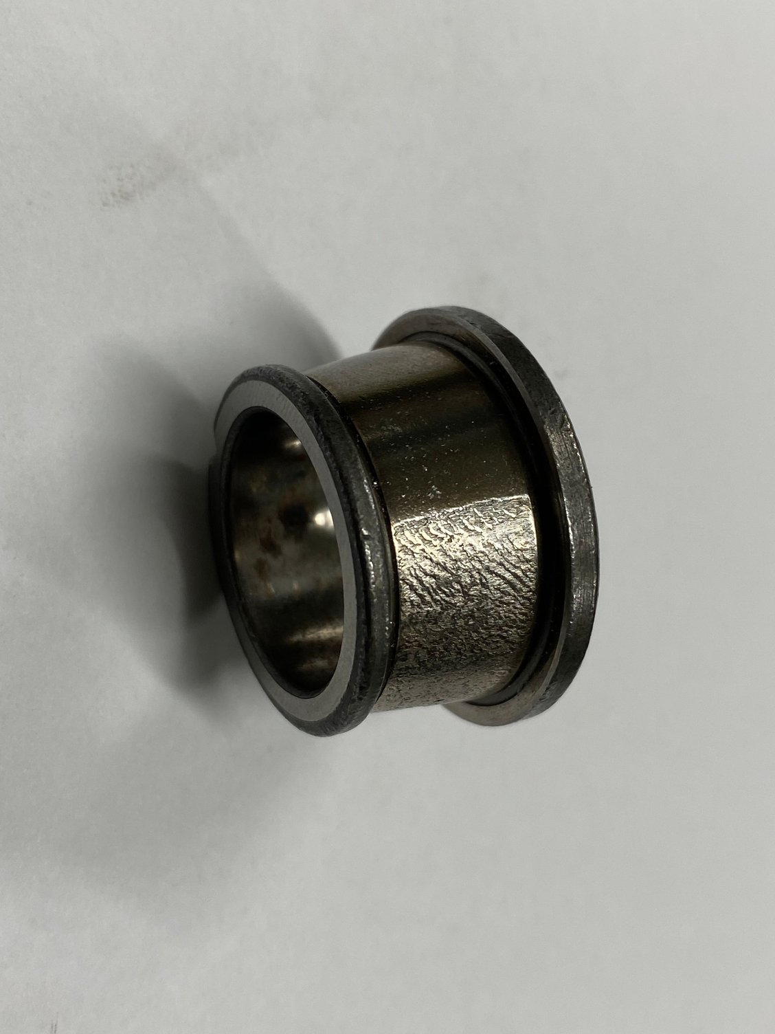

These are the inner rings of the outer front bearings from my '81. 103,000 miles. The grease pack between the bearings was dry and cracked although the grease at the rolling elements was still fluid. I replaced everything and it's like a new car.
