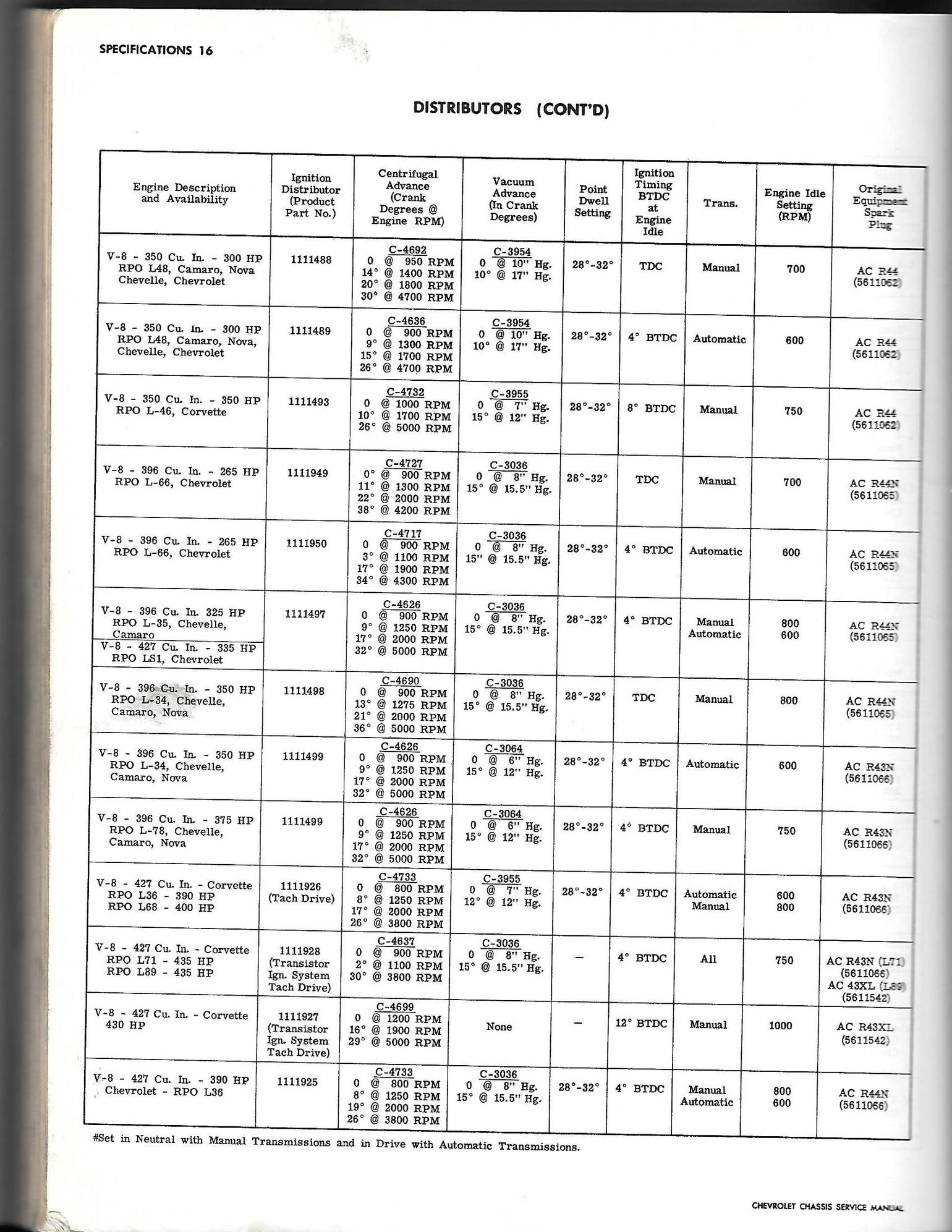

Pull out your '72 owners manual. Does anyone here have a '71 manual so we can compare the point gap. dwell angle, and timing? That would rule out some of the obvious stuff. Here's from my '69 owners manual, as an example:
I'm sure someone has factory Corvette workshop/service manuals laying around that should go into considerably more detail in order to try and pinpoint all the emissions tuning changes.

Actually it's the initial timing combined with the mechanical advance and rate of advance in the table below. This if from the 1969 FSM and is found in the back of the FSM. As far as the carburetor jetting and rod selection, Lars Grimsrud has a document where he provides specifications on many of the Quadrajets of that era and he might provide an updated one, this is old from 2007. The secondary Rod changed from 71 to 72 and perhaps the primary rod on the 72 MT cars. .
7041204 Chev 71 454 AT Vette Main jet, 77, Main Rod 49 Secondary Rod BG
7041205 Chev 71 454 MT Vette Main jet 77, Main Rod 49 Secondary Rod BG
7042216 Chev 72 454 AT Vette Main Jet 77, Main Rod 49, Secondary Rod CM
7042217 Chev 72 454 MT Vette Main Jet 77 Main Rod 45, Secondary Rod CM
