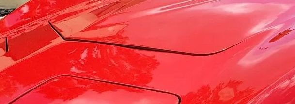

Definately the front of the hoodline looks alittle off. Get up under it with a mirror or something and make sure the headlight reinforcement hasnt popped off or similar. That metal bracket is epoxied to the underside of the nose to give it additional strength and support and to also give the headlights something to bolt to in the back. All might be AOK but there is a pretty good gap there. Its really easy to pop those off by putting weight on the nose (IE parade queen sitting on nose of car) particularly if its got some rust in and around the epoxy. I’ve reattached that bracket before and while its a PITA its doable in an afternoon. If theres a problem consider it a bargaining chip not a deal breaker.
Otherwise she looks really good and if the cage and the frame and other things check out I’d be bringing her home.

I took one of the pics and cropped it down so you can see what Im seeing. See the wave in the gap between the nose and the hood? Thats either a poor fitting nose/hood or that bracket has popped off on that side.

got it, thanks, obviously hoping to get an assessment from the inspection and I’ll see it on Monday.
