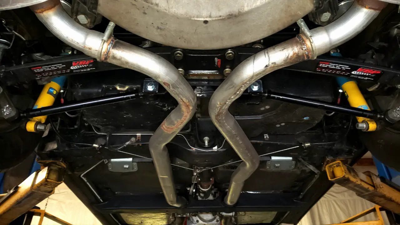

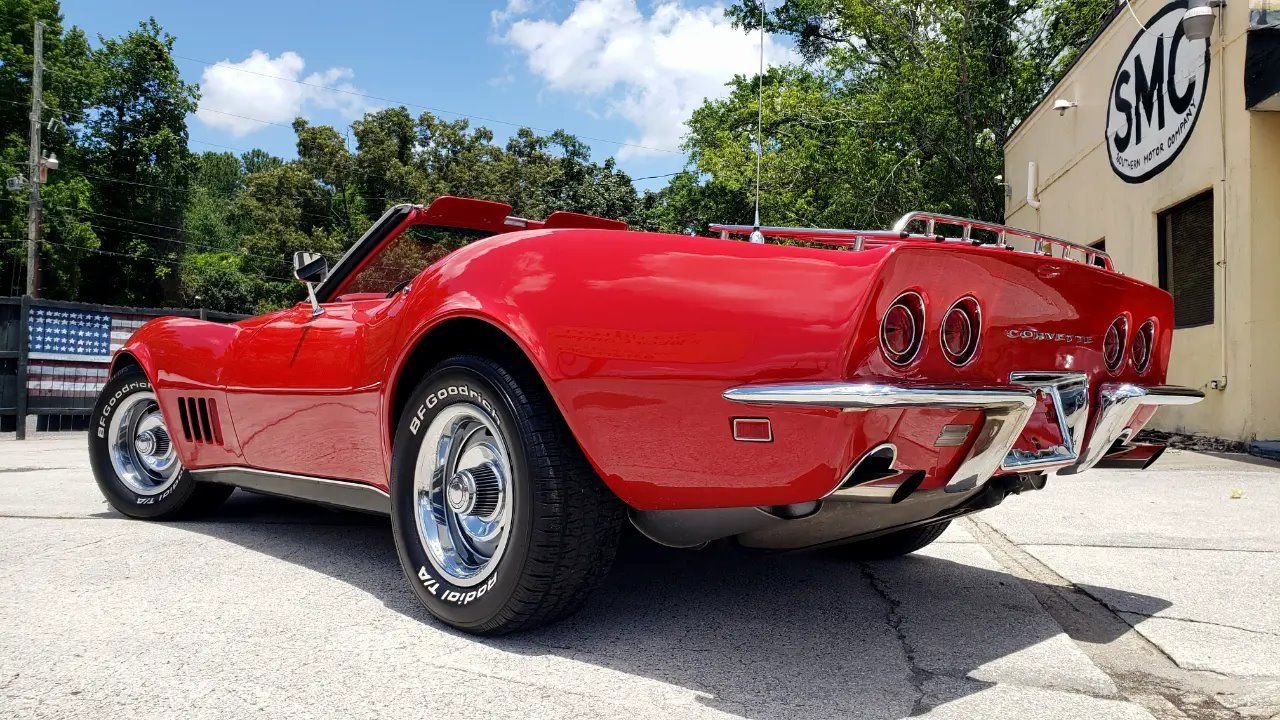

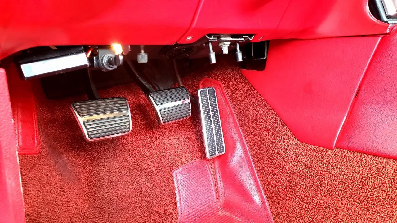

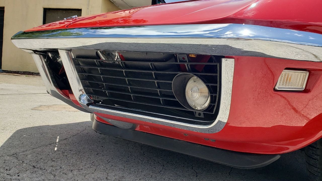

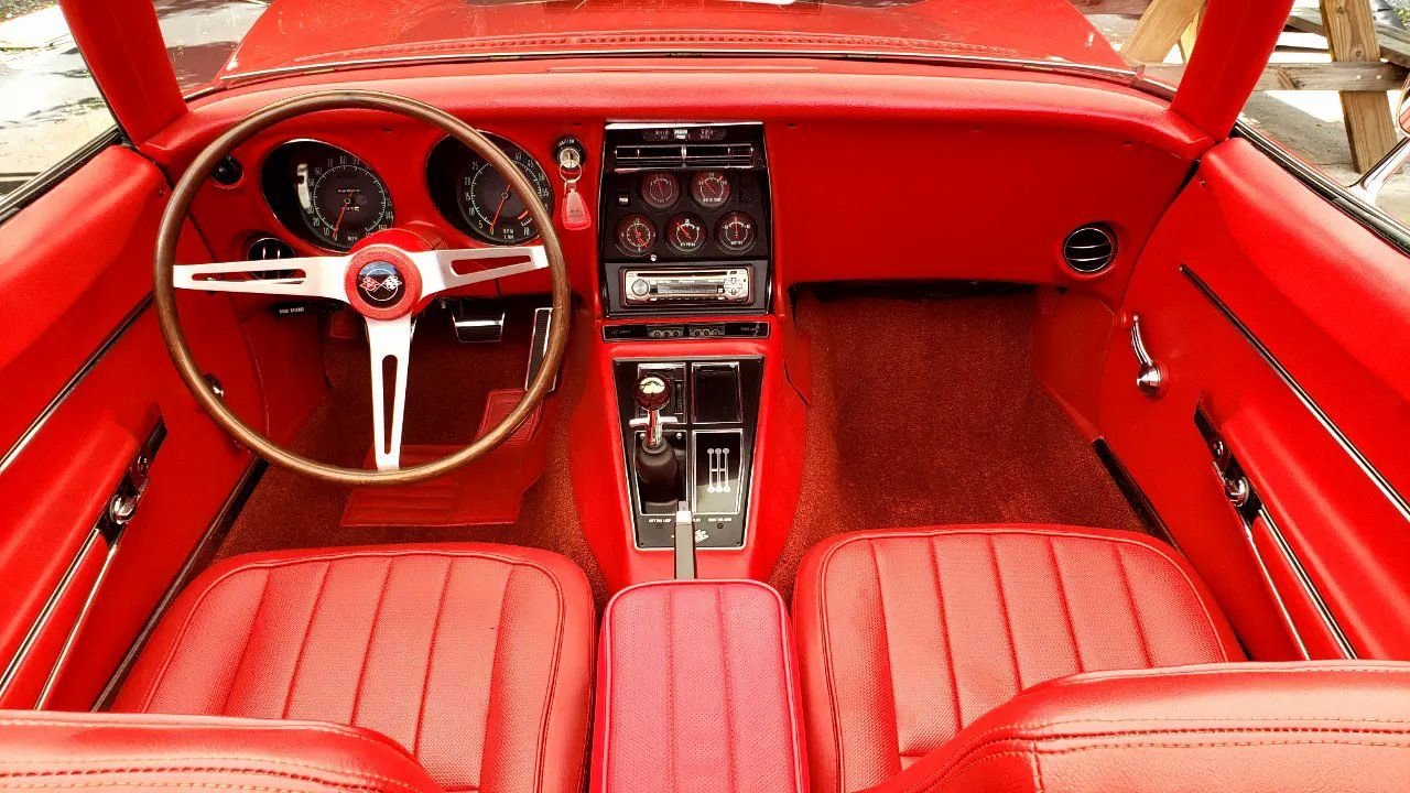

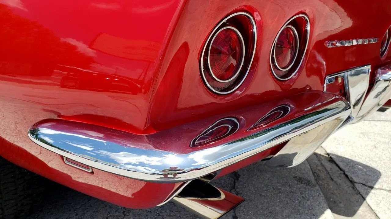

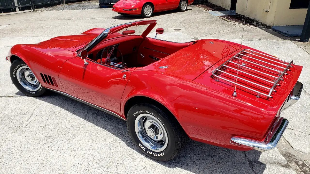

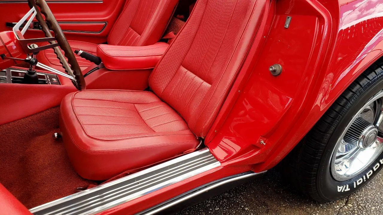

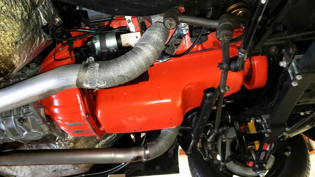

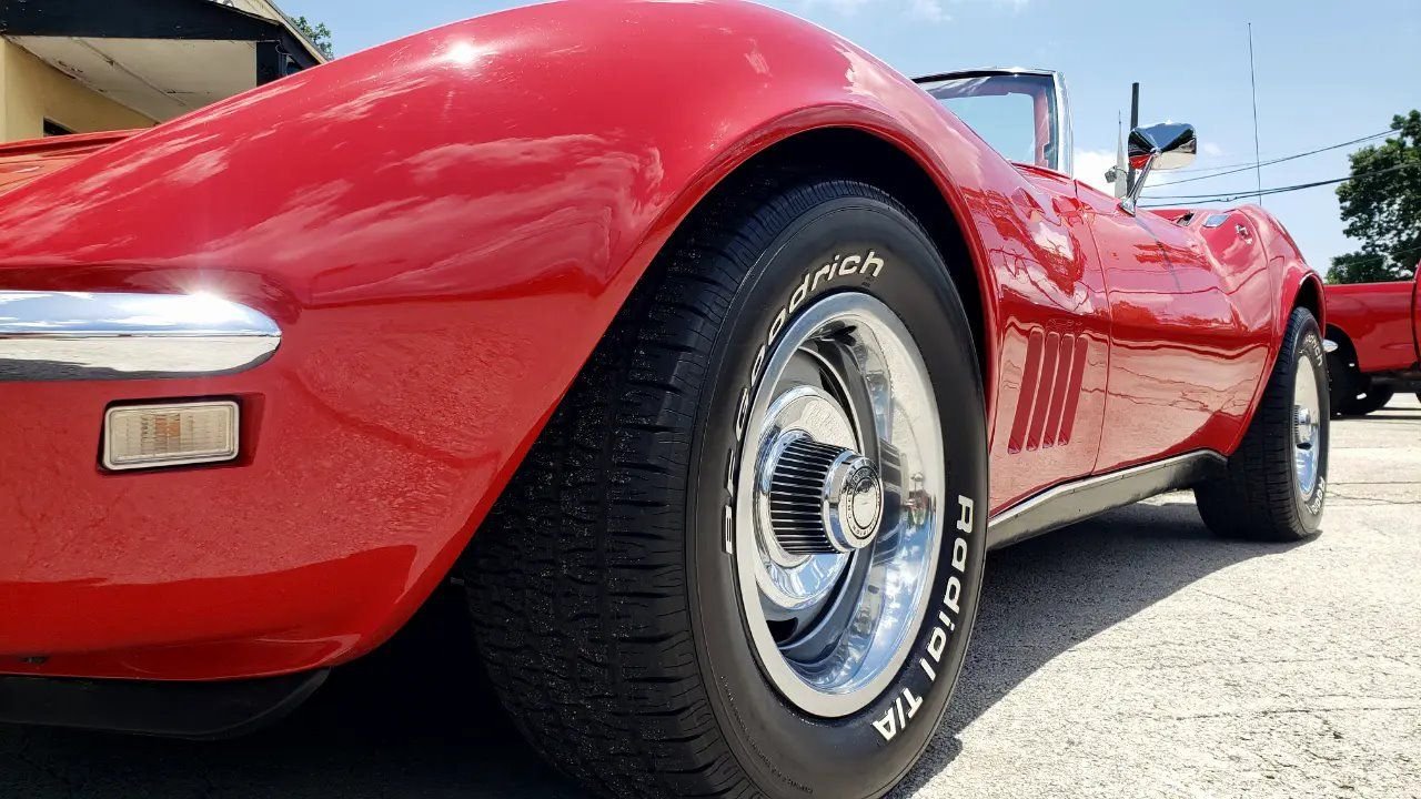

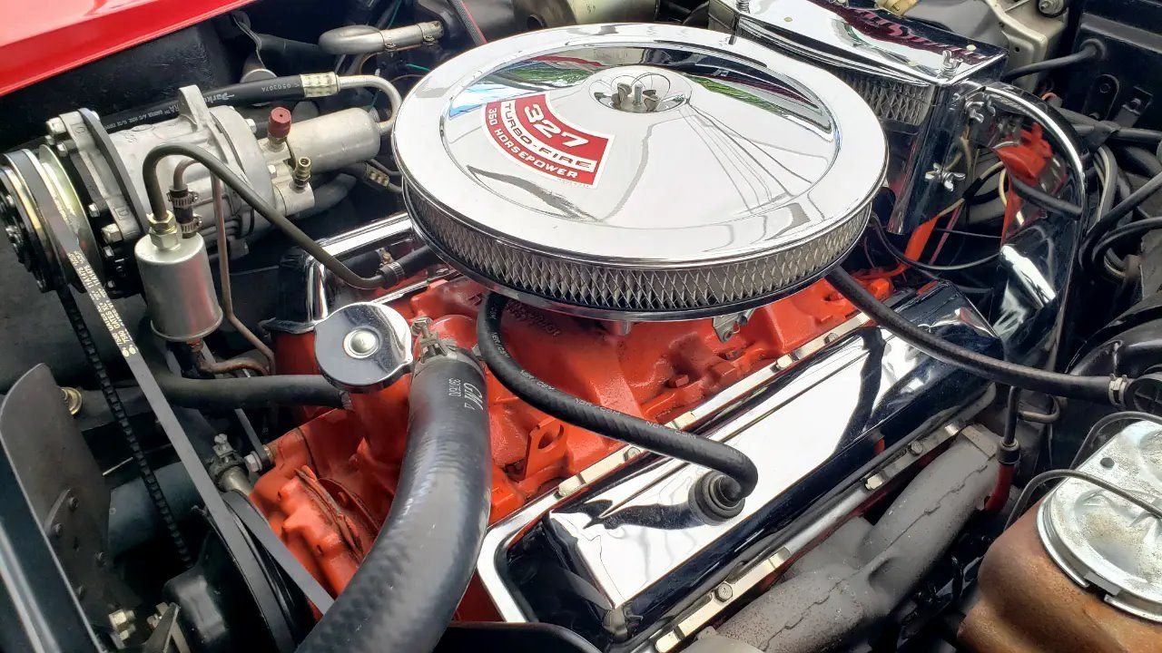

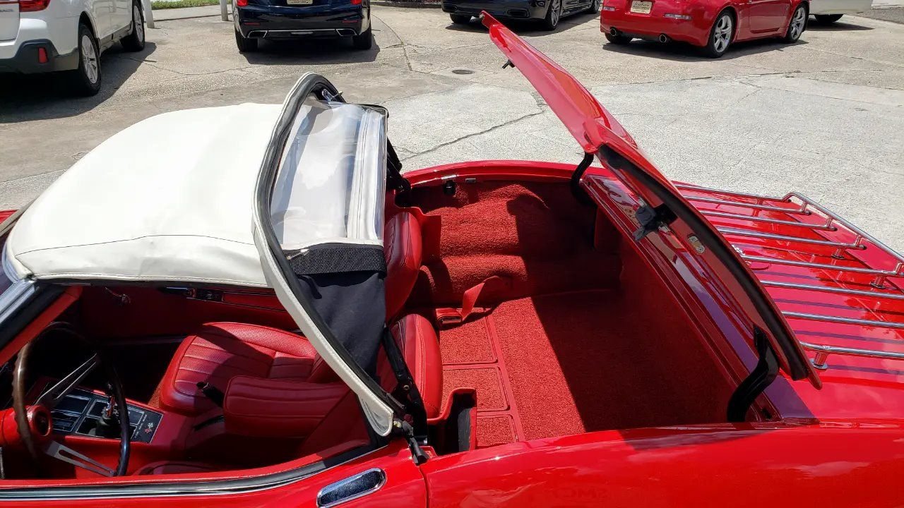

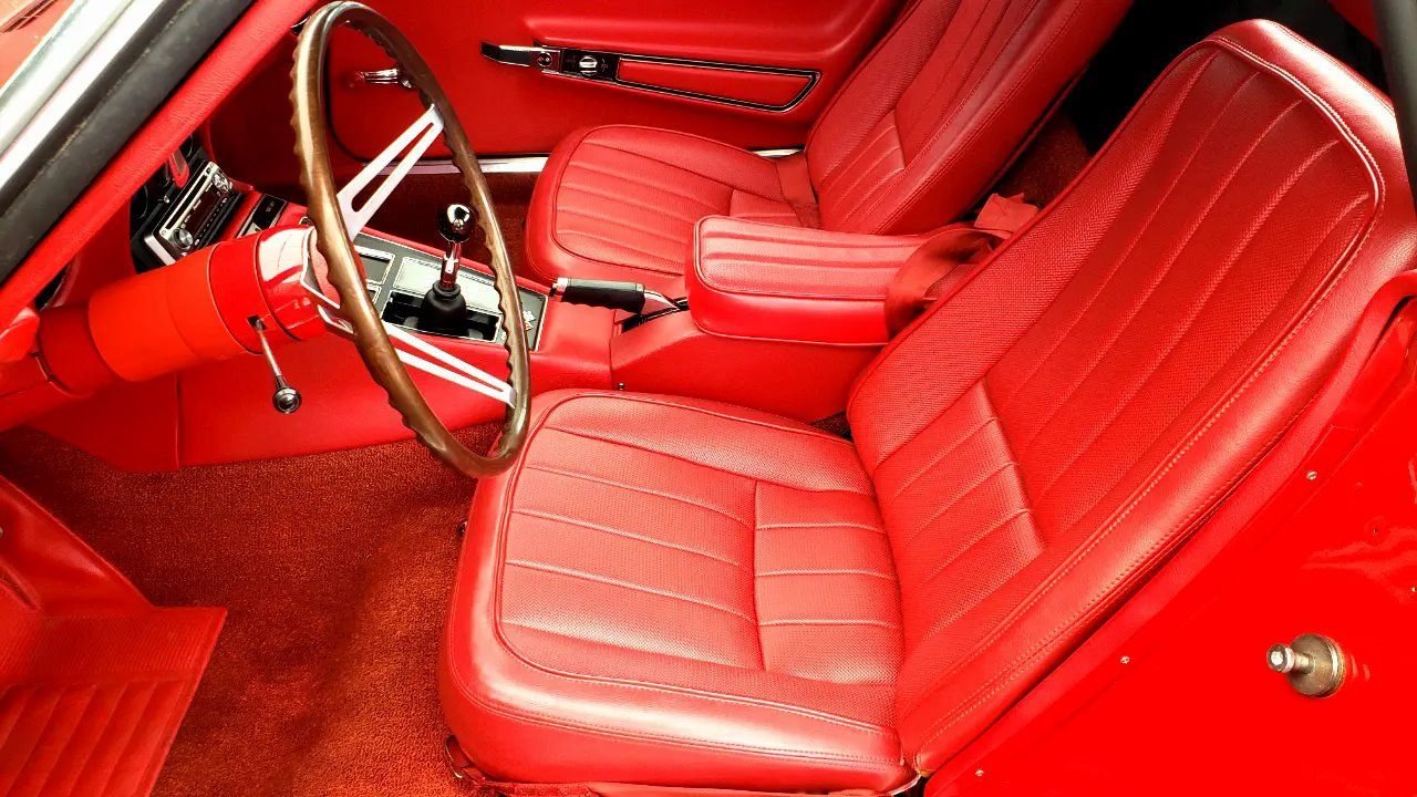

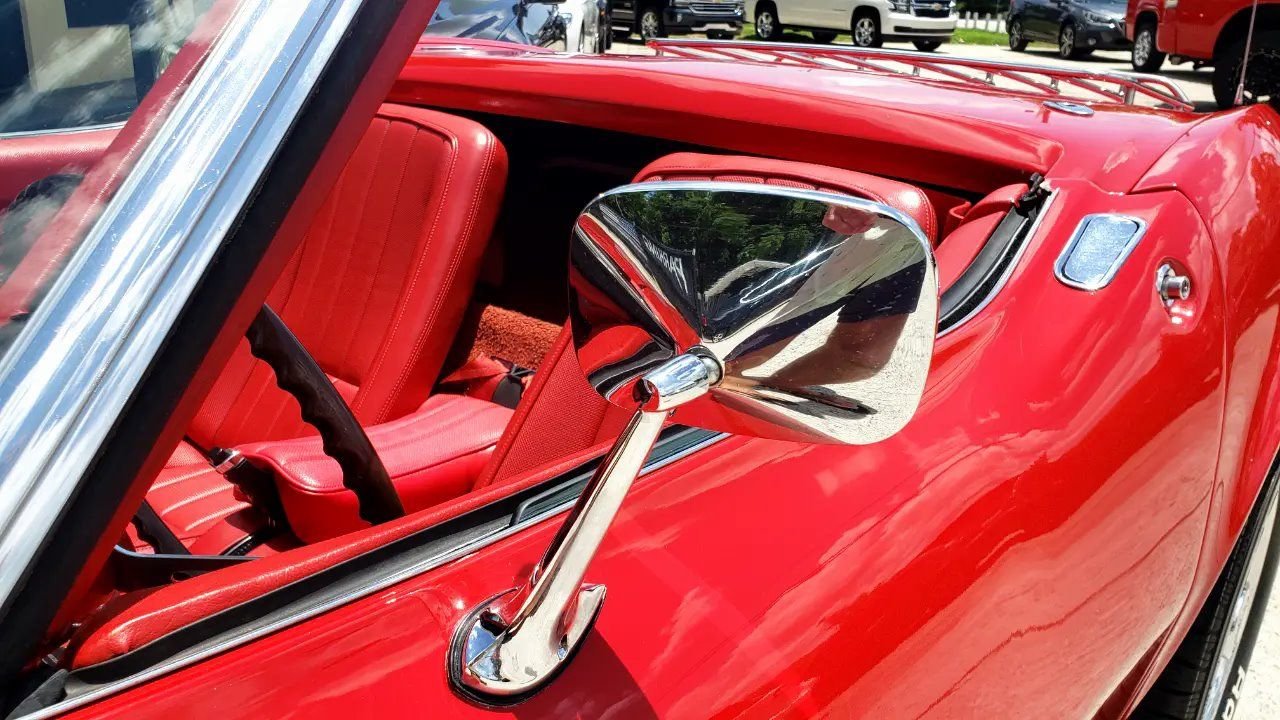

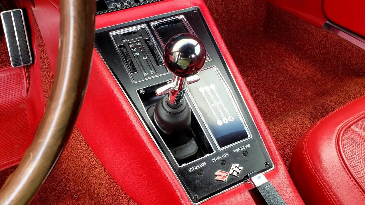

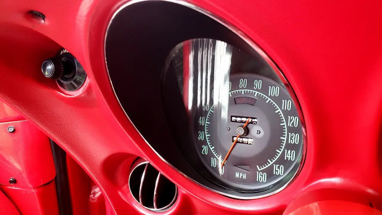

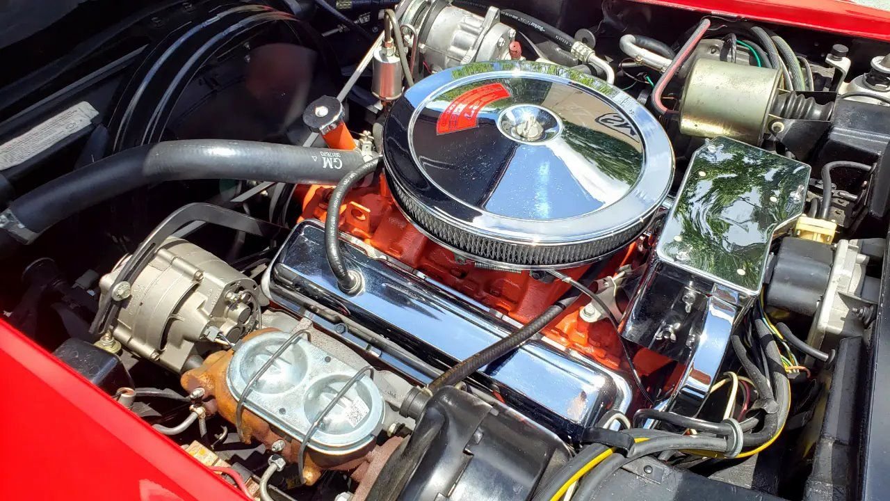

First, I hope everyone is having a happy and safe 4th! And thanks to all who have commented on my intro thread and other posts, the newly found community has been a big help as I move towards my first Vette. I plan to go see this car and before I do, I'd love to get some feedback. But first let me state, yes it will be inspected before I make an offer if that's the direction this goes. It's not a numbers matching car by any means. I specifically want a relatively recent restored car and even lean toward some modern upgrades (like the Tremec 5 speed and updated suspension this one has and more...)
Here's the recap of the car and pics... Have at it and thanks in advance. Anything obvious, not so obvious? (oh and if you want to offer any alternative by all means go ahead, it can't hurt).
1968 Corvette Convertible ! This vehicle received a frame off restoration in 2014 ! Powered by a 327 Cubic inch bored .20 over, Internals are a Comp Cam XR270HR-10 Roller Cam with Roller Rockers as well ! Motor is from 1968 and stamped to match the Vin but not original. Full VBS Performance Suspension, Includes Front and Rear Composite Mono Springs. Front A Frames, Bilstein Gas Shocks, Drilled and slotted rotors, Entire cabin is lined with double foil insulation, A/c System has been converted to a modern day system with all new equipment, The transmission has been converted to a Tremec 5 Speed. Everything on this car works as it should right down to the center console lights that illuminate for Brake, Turn signals, Reverse lights and Seat belt warning, Heck even the buzzer under the hood lets you know that the key is in the ignition. This vehicle drives absolutely great at all speeds and cranks up every time with no issues.

From the pics, it looks like a beauty. Who did the resto? Can you talk to the person/s who actually worked on the car? Any “before” and “during” photos?
What prep was done to the body before paint? Any evidence of damage? What products were used in the paint process (primers, topcoats, clear, etc)?
Casting numbers/date codes on block, heads, intake/water pump? Date codes on carb, starter, alternator, clutch hub? What kind of clutch? What model of Tremec (e.g. TKO-600)?
What was done to the differential? Gear ratio? Trailing arms/bearings? Who did that work?
Read up on how to inspect the birdcage. This is critical. Assuming the seller is asking a fortune for it, be sure you are able to pull the kick panels and access covers and look at the #2 and #3 mount areas very carefully. Also pull the windshield interior trim and carefully inspect for any signs of rust.
I would take a blunt pick hammer and tap the length of the frame on the bottom and sides where there is any evidence of rust. A solid frame will produce a sharp sound, a soft frame will be muted. These are boxed frames so sandblasting will only clean up the outside. An internally rusted frame is a ticking time bomb. The 68’s also don’t have the additional gussets like the 69s and later so are more prone to sagging. Look at the door gaps by the handles with no one in the car and with two adults sitting to see if they close down any. You can also jack the frame just under the door and see how much they expand.
Missing a bolt on the left hood hinge.

It is a beautiful car. The thing that I like the most is that he stamped the Vin numbers on the engine block and admitted it upfront. That implies a certain amount of honesty. Because if the guys dishonest this gorgeous thing could still be a total POS underneath. But I don’t think that is the case. I think this is going to be 50+.

Here are a few things I spotted that aren't stock: radio, A/C unit, front and rear composite springs, and air cleaner. If these are acceptable replacements, it looks like a fine car.

Very nice restoration and honest listing. Lot of pigs with lipstick out there and this doesn't appear to be one of them. Good luck on Monday.

I think it presents well, appears to be an early '68. The suspension upgrades are a nice addition which will improve driving experience, but not sure if absolute originality is a priority for you. I have to say I've had 4-5 '69s and to be honest I prefer the '68's. I rather the quick rev 327 over the 350, the interior is much cleaner without the passenger floppy map pocket, key in the dash and 4 brake lights. It's seems every event I attend there are multiple '69s, and '68s appear to be a rarity which is a plus.
I would not hesitate to look at this one further from what I see.
