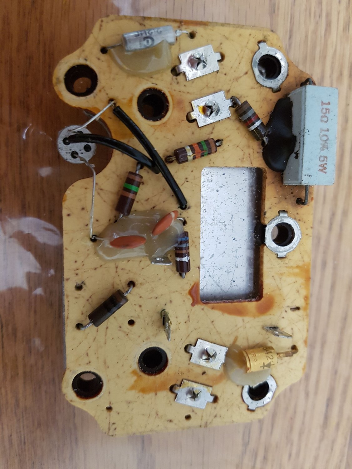

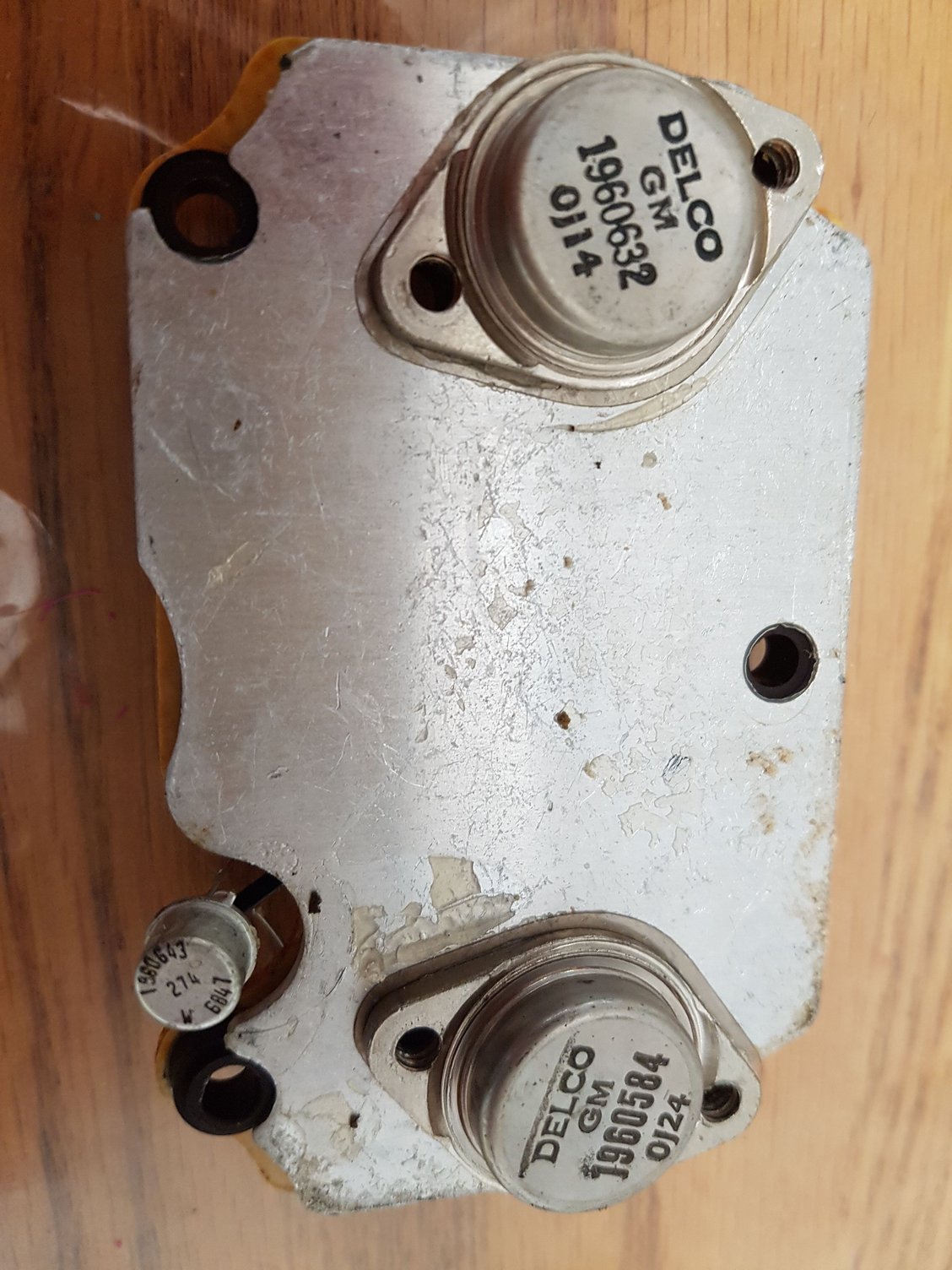

I recently took out the TI amplifier in my 71 LT-1.
I wanted to restore the box and replace the board components. The problem is I don't find the Delco Transistors.
What must I do? Is it possible or not? Or I should replace the board by a new one with a modern design. How about the quality of these new boards ?
So do you have any advice to give me?
Thanks.
Alex

I would replace the board

You can buy a original service board or a new more reliable technology broad from some vendors. Here are a few.
http://www.tispecialty.com/amplifiers.htm
Amazon Amazon
https://www.lectriclimited.com/vehic...del/65?cat=931
https://www.corvettecentral.com/c3-6...-inside-272122

OK, Thank you.
I will follow your advice and buy a new module.

The Amazon and Corvette Central boards are a 2nd design and are a better design. Then the 1st design from Lectric Limited I should have added that
