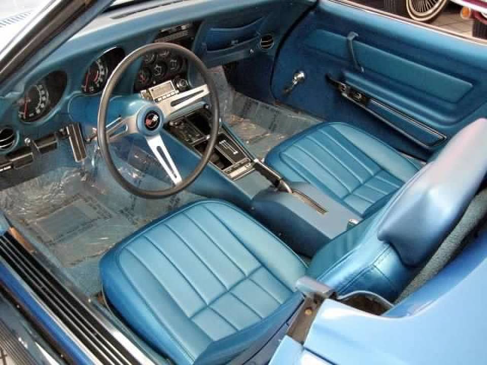

Hey gentlemen my dash lights are not working. I was able to find a sweet spot by using the dimmer but now they seem to be out. The interior lights will come on no problem when set to the far right using the dimmer. What is the best way to repair this. Car is Mostly stock with one repaint. Wiring appears to be pretty unmolested. Factory radio still in place..
Thank you in advance Dan
