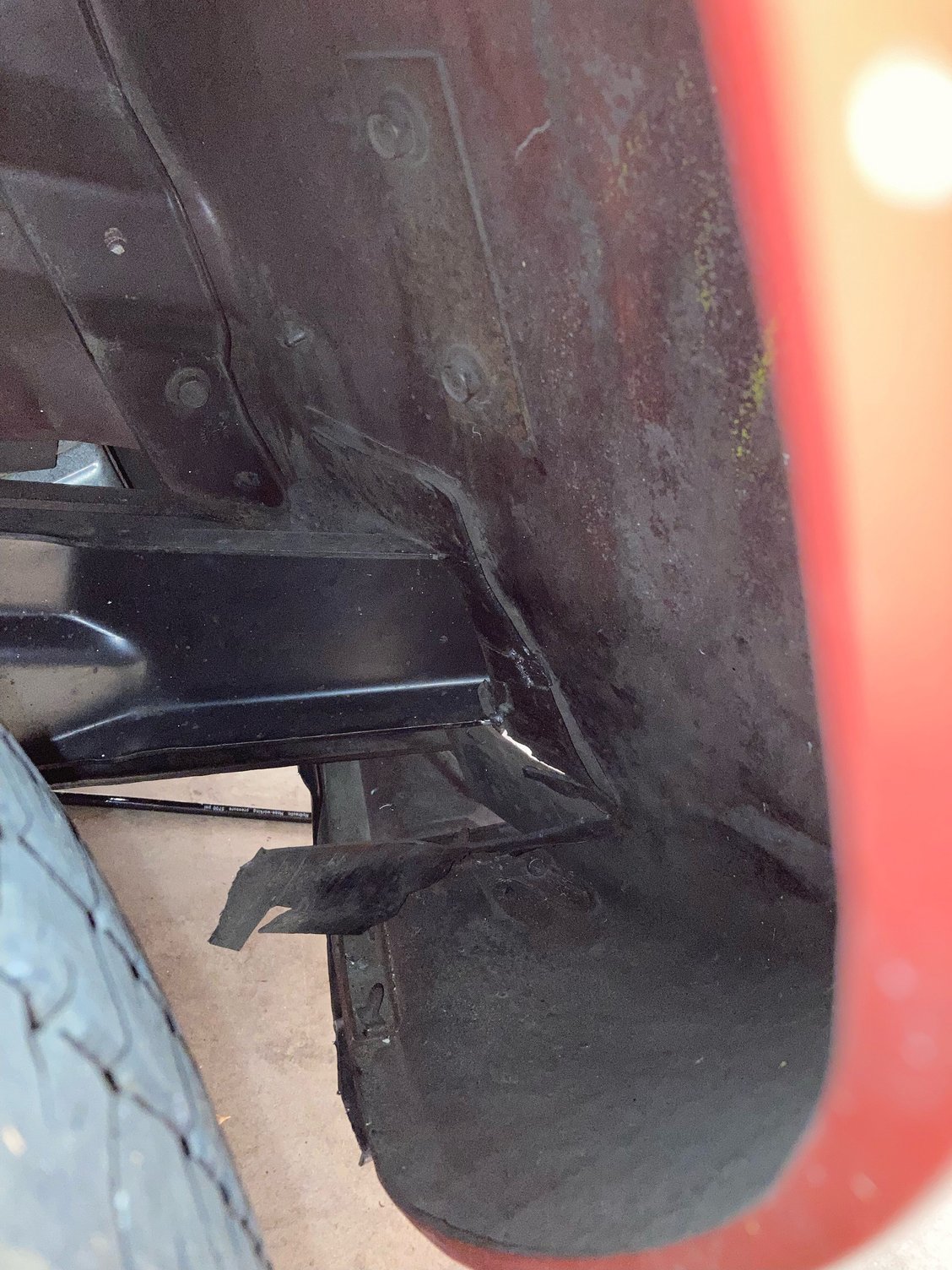

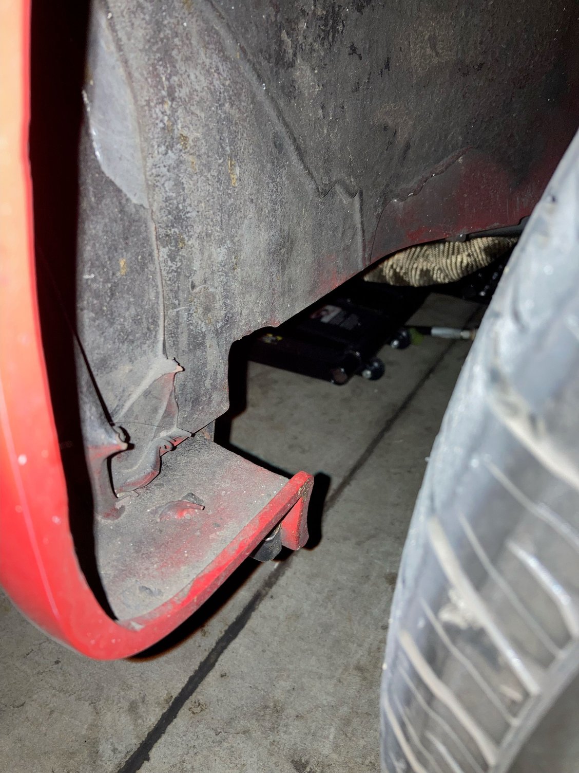

Here's what the "cut" looks like on my 79, behind the front wheels. The tire still rubs on the frame by the steering box on tight left turns, but not on the fenders. I'd be very surprised if the OP's car does not have this feature.

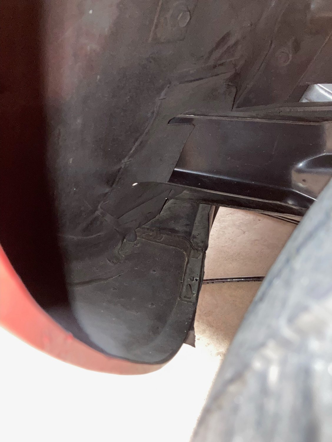

Hmmmm.
i had to look..
79 with the standard tire size originally..and now..

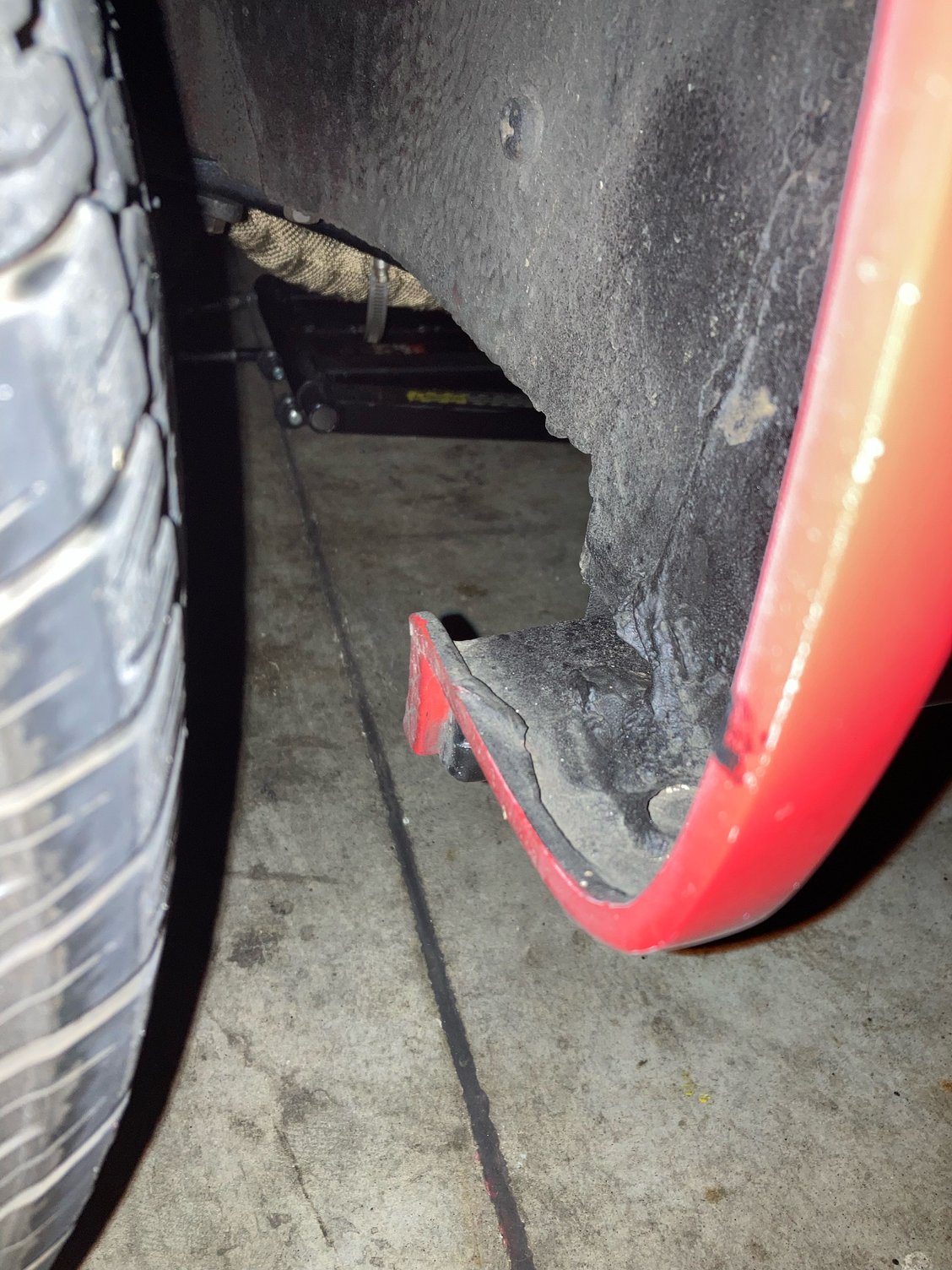

In my 79 the lip on top of the guards have been trimmed at the factory, I run 255/60R15s within only minor rubbing on chassis when on full lock.

Says both were trimmed..inside rear..and front lip…
i have zero trimming…and i do not know history from factory…butstill have grease markings..
it says the use of the larger tires in 78-79 required trimming.
