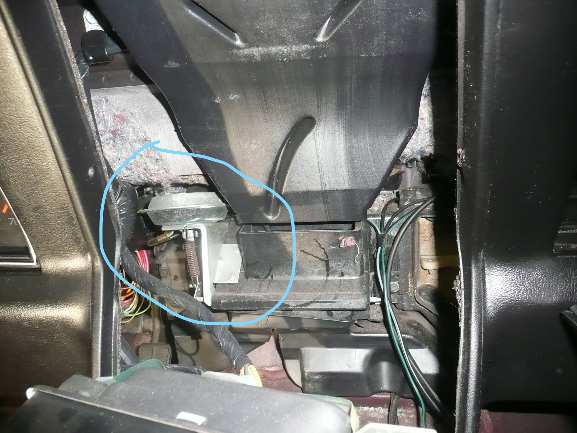

As I recall, There's a vacuum actuator under the dash that switches from defrost to heat.
This one (it's my 79')
that would make sense. Any idea where I should look?

I see, it’s behind the instrument cluster. How easy is that to remove
