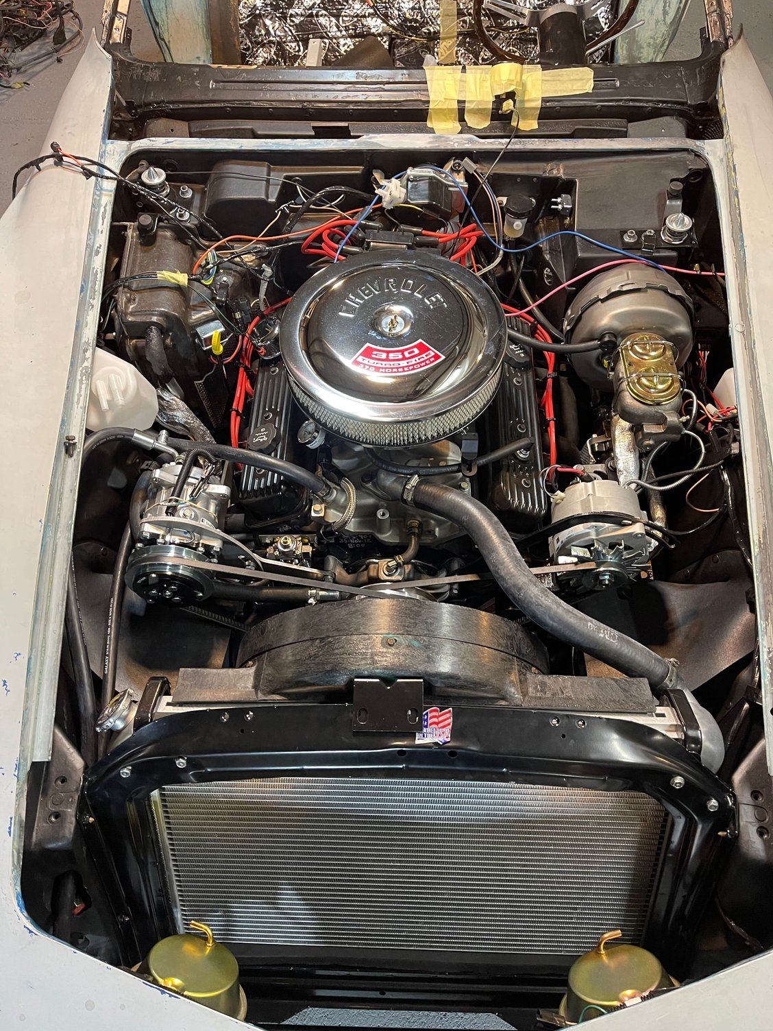

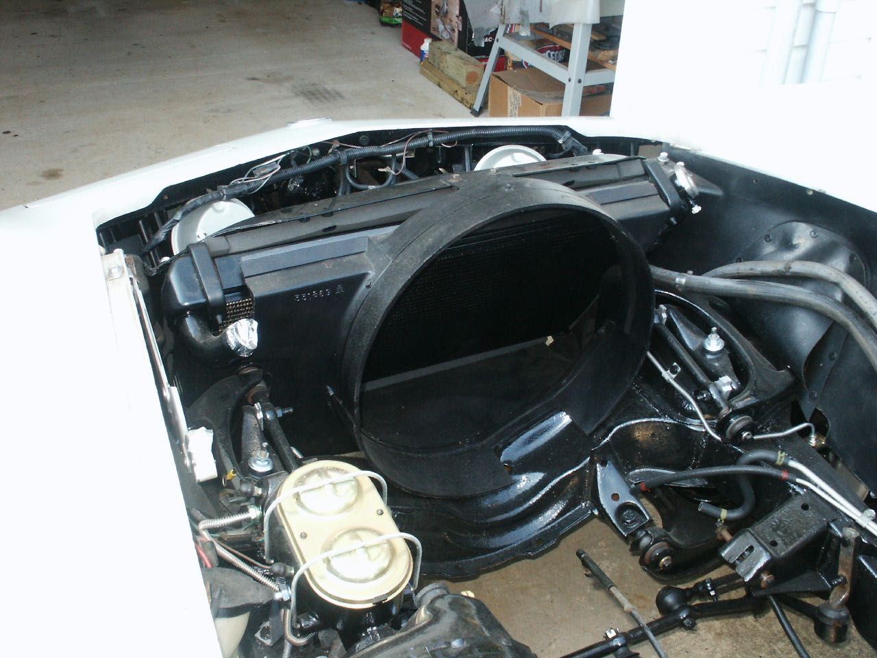

I installed mine before installing engine. The shroud is very hard to mount in place, so I installed the radiator and shroud as one piece.

I installed mine after the body drop, however I put the fan shroud on the radiator along with the radiator support and then installed it all at once as one big chunk in the car. Was much easier this way.
