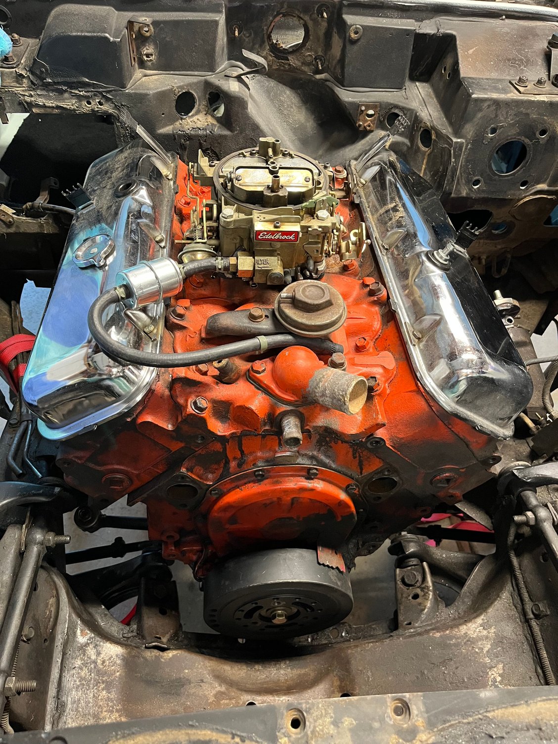

Hey All, I recently retired and am thinking about re-detailing my LT-1 engine. The car was a frame-off restoration, yet I would like to freshen up the engine. I will put forward a two part question;
1. Best way to repaint the engine block (pull the engine with manual trans or leave trans and pull engine only)
2. How to restore original luster of aluminum intake and valve covers
I am trying to put together a game plan for doing all of this come Fall. I have a 4 post Bendpak lift with two bridge jacks. If anyone has done so, can you please give advice on pulling engine with car on lift? This will be my FIRST engine pull.
I would like to clean up my exhaust manifolds, paint the block and restore luster to the aluminum intake and valve covers. While these may be three separate topics which can be explored in other threads, I would appreciate feedback on how best to approach this project. I always research extensively, put together a game plan....THEN start a project. I do not jump blindly into anything. Any and all advice would be much appreciated.
Cheers!

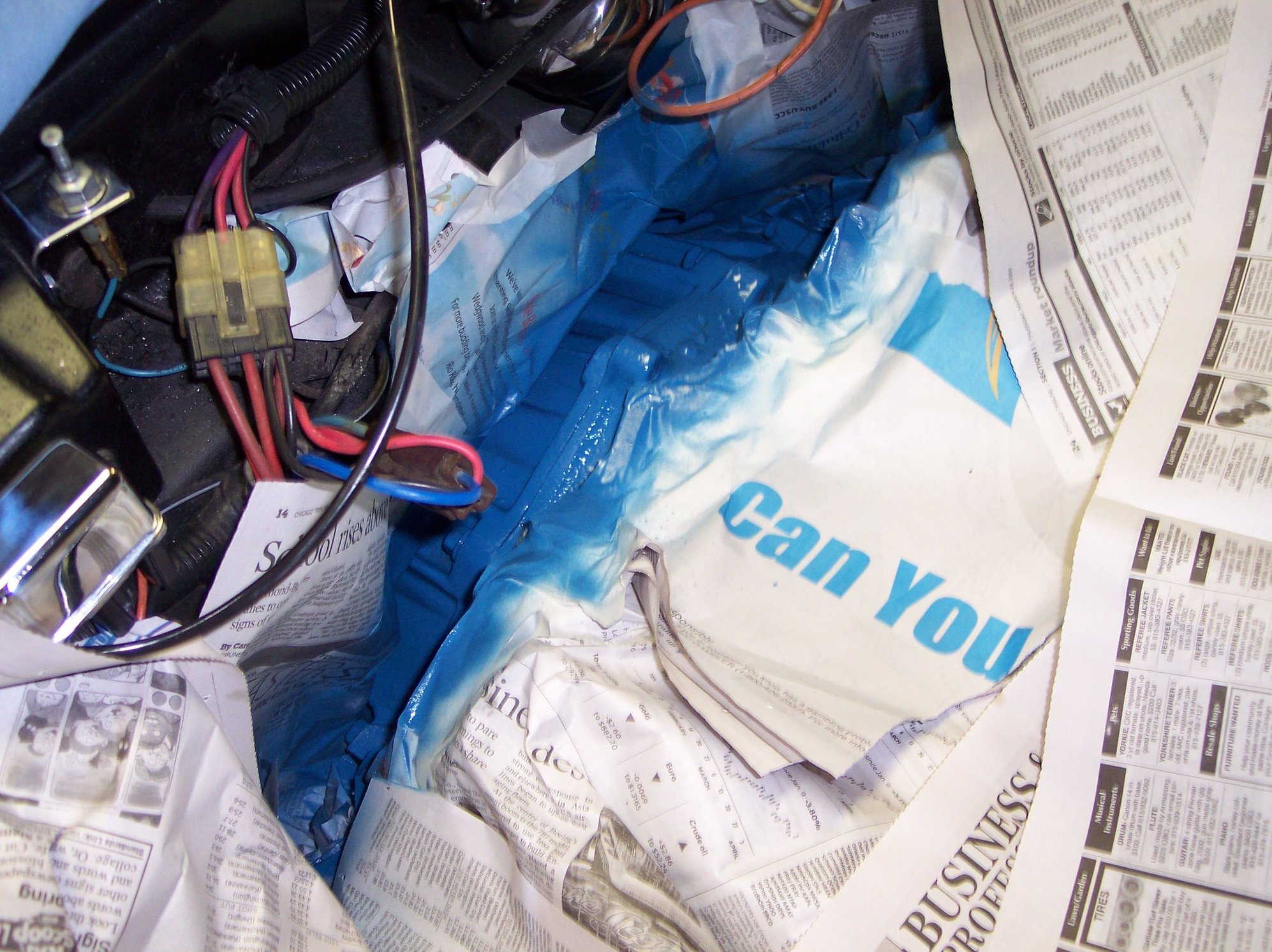

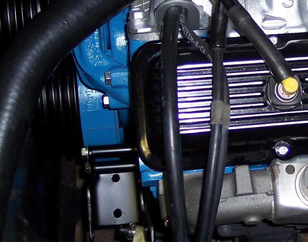

I did all 4 of my Vettes over a 2-year period few years ago. 2 78s (both now sold) and 2 79s.
Did not remove the motor from the car.
Removed EVERYTHING from the motor, all brackets, starter, alt, oil pan, front damper and cover, intake manifold, exhaust manifolds, distributer, and on and on. Sandblasted every painted item removed and the exhaust manifolds. I did leave the fuel pump on and masked it off.
Cleaned up motor, including jacking it up and removing motor mounts to get behind.
Masked everything off with newspapers, alum foil, and rags.
Painted block, oil pan, front cover. Put motor mounts back on and dropped motor back down. Replaced oil pan and front cover and touched up gasket/bolt areas. Used a high temp cast grey on the exhaust manifolds.
Turned out GREAT, 4 times!

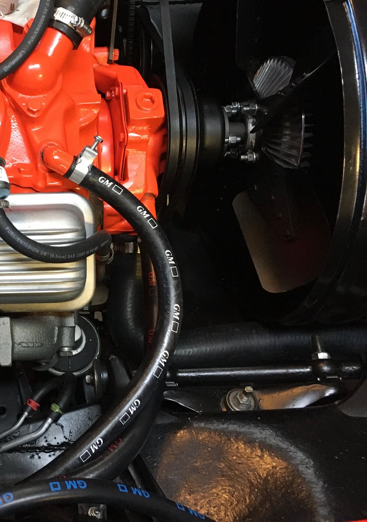

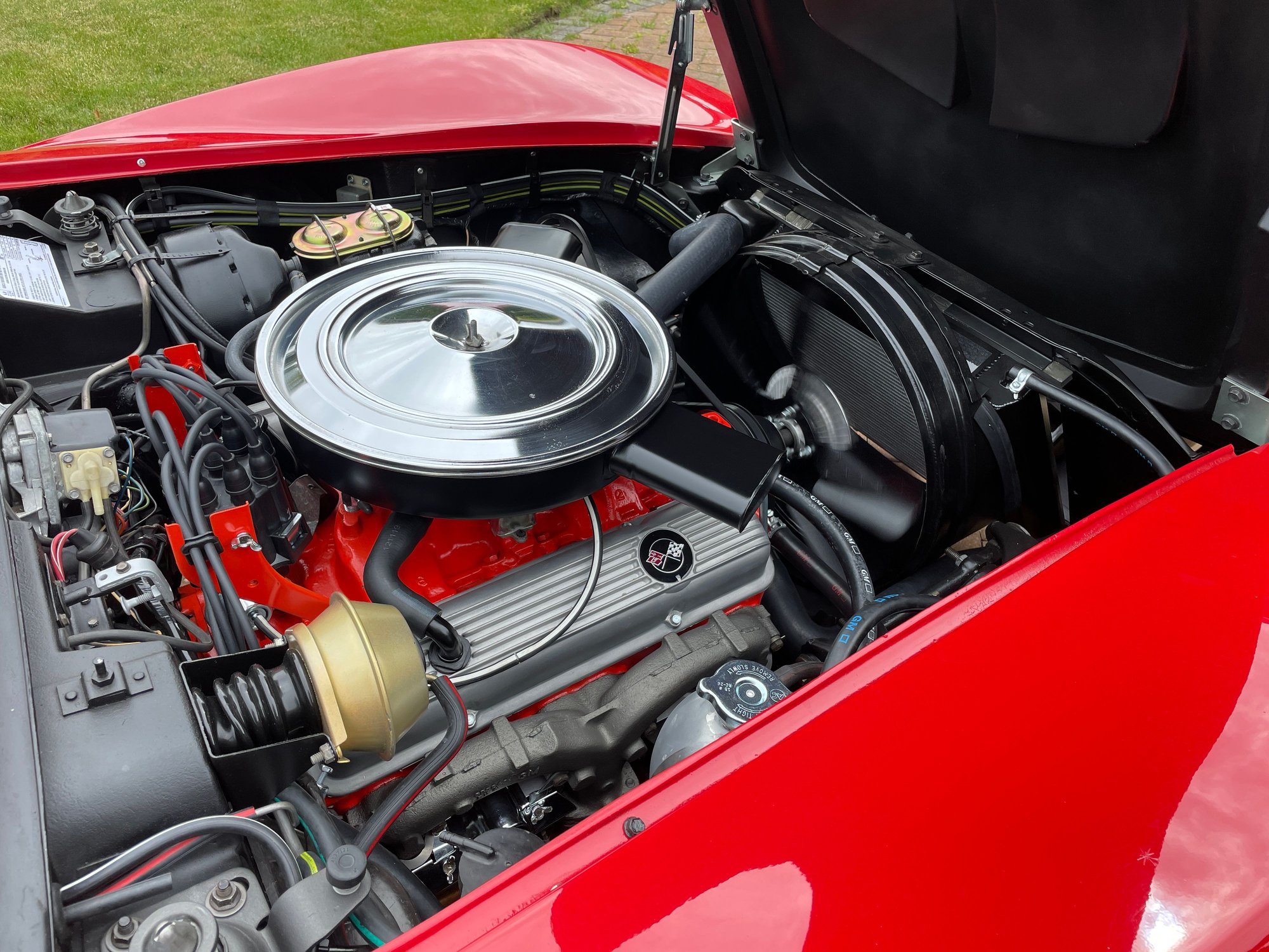

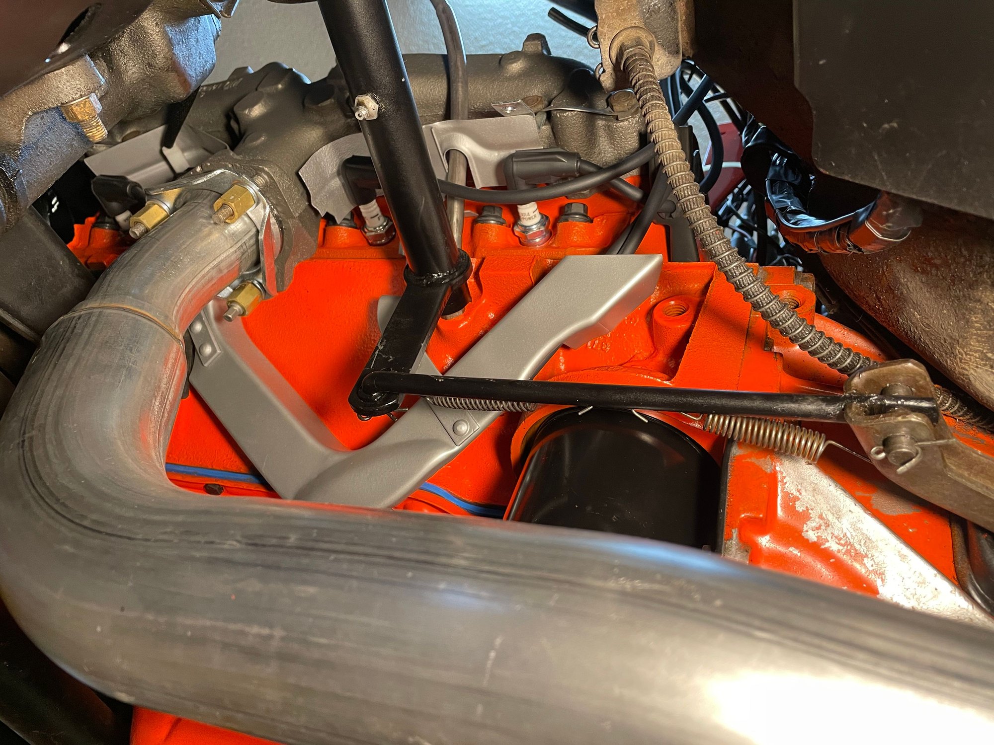

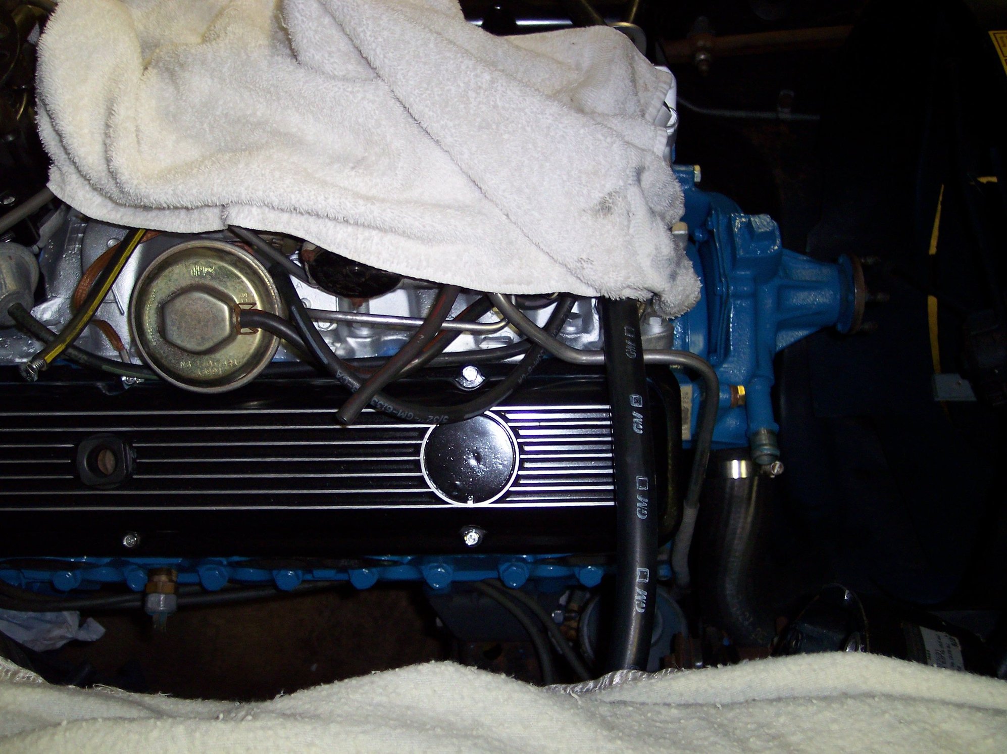

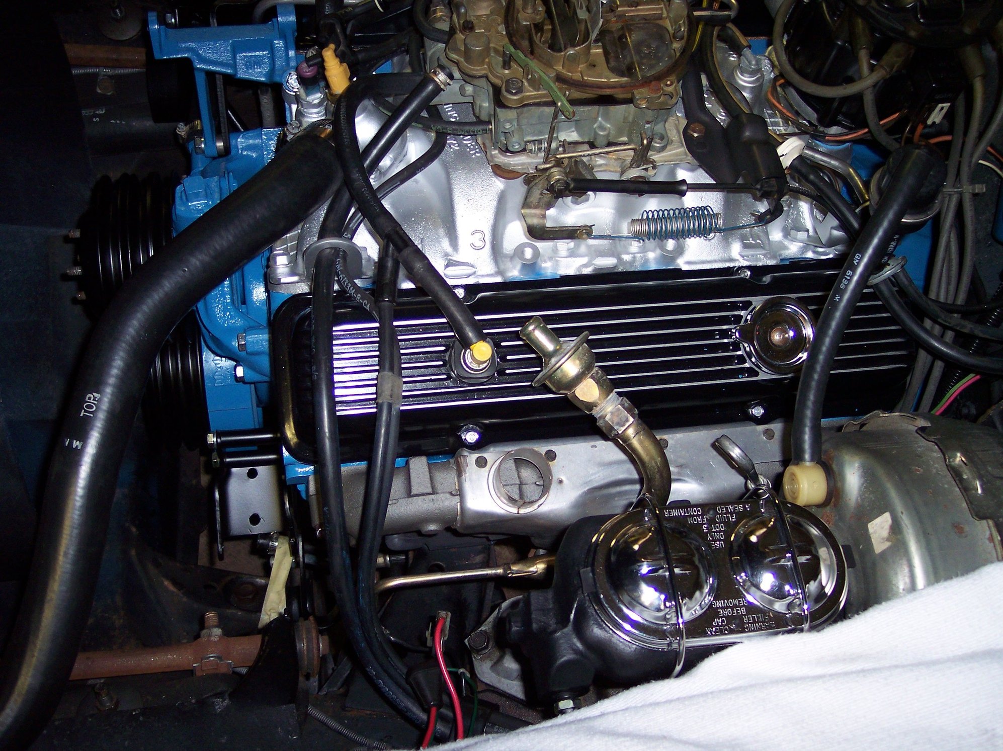

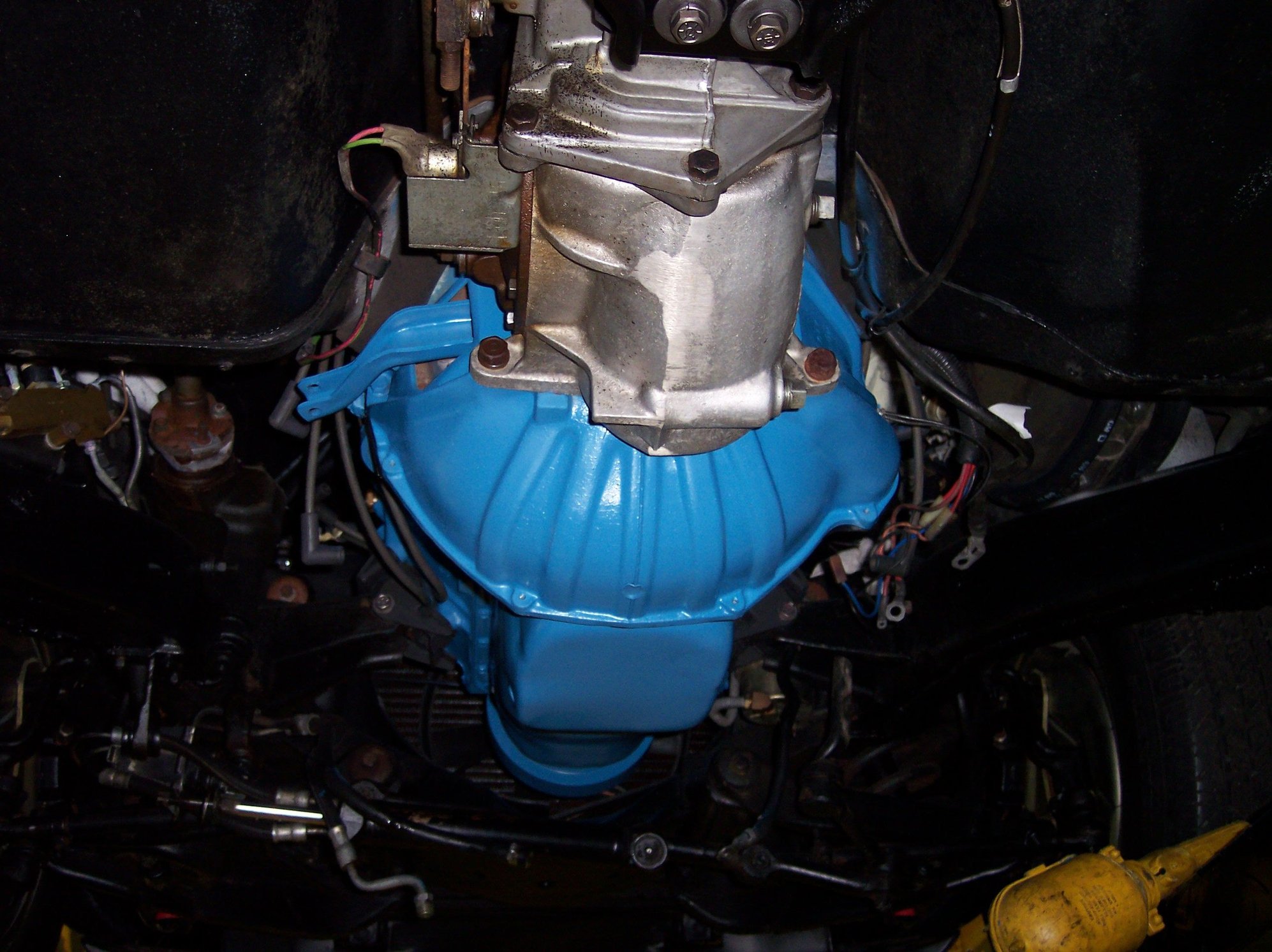

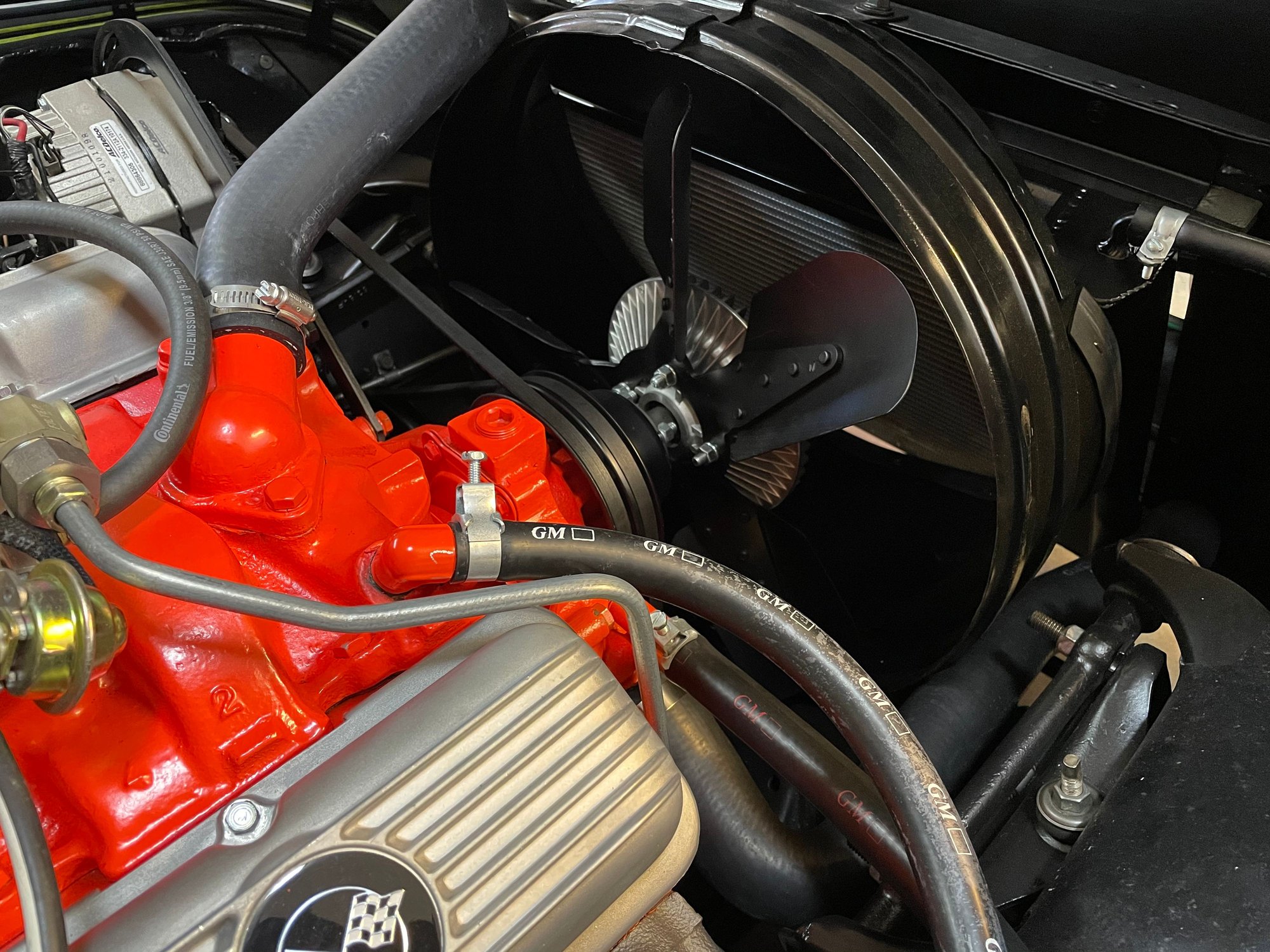

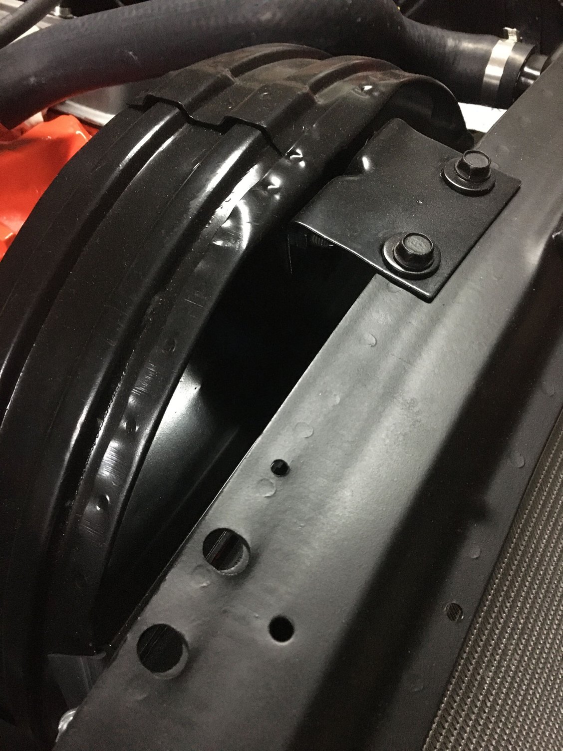

I just went through a major engine bay detail with my L48 ‘72. Bottom line is. How much time are you willing to spend and how In depth are you wanting to clean and restore each nut, bolt, bracket and paint each component separately. The problem is to make it look restored you also need to restore and detail the area in front of the rad support as well. Then you get into the situation where everything is painted clean and new looking but the decals look weathered. The hoses look old and grey. Wiring needs cleaning etc. I went down this rabbit hole. Probably spent about 150 hours but also with engine in and heads off ( for head and roller cam swap as well). Media blasting provided best results on brackets manifolds etc. I ended up ceramic coating my exhaust manifolds. I also media blasted my aluminum covers and overflow tank. They cleaned up well. But did have a slight fine grit sandpaper feel. I ended up polishing them with Autosol polish and they look pretty correct. I’ll attach some pics. With heads off and motor mounts off I was able to paint the underside of the block quite well. I also took the hood off and painted the underside of the hood. I’m pretty happy with the outcome and overall result. But way more work than I thought and learned a lot. Forum searches and Alan71 pics helped me big time.
Shielding not on yet. This is underestimated in the amount of time to put back on correctly. Can see why it’s often discarded.
They say decals are exact repros. They look good. But when compared to original. Not exact. But you have to change them. Everything looks new. Then you have an old weathered decal. Detracts from the look. So even though mine weee pretty good given age. Replaced them.
Valve cover after media blast and autosol.
More valve cover detail.
Getting the correct blacks for different components requires some research.
Drivers underside.
