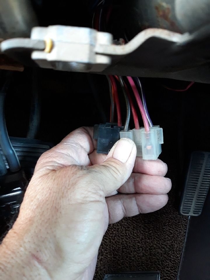

thanks to all for the help. now can anybody help with this picture is the pink wire to have power all the time ? the wires that have power all the time are the 2 in center red & brown . at this point in this mess i put in a new ignition switch still no crank.
