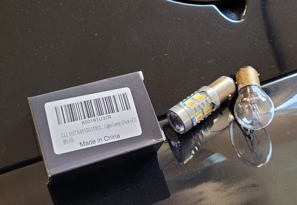

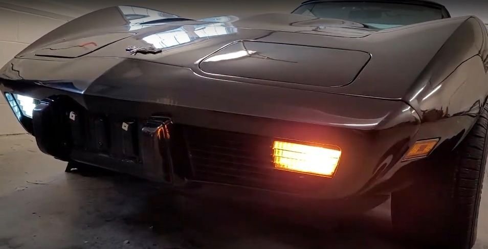

OP, I'm glad you found a solution that worked. I finally got a chance to repeat the experiment on my 79, and I have different results.
My 79 has LED taillights, 3-wire LED flashers in both positions (turn signal and hazard), and still has incandescent front side marker lights.
I used white/amber 1157 LED switchback bulbs in the front positions, and left incandescent bulbs in the side marker positions. There are no cornering lights in my 79, and the light circuit should be the same as your 72. Also, I don't know if the switchback vs. conventional LEDs does anything.
This configuration worked fine for me. The front lights are much brighter (and can be used as DRLs in "white" mode, as is intended). The photos below show the original and replacement bulbs, and the left turn signal during the left turn flash, while the parking lights are on (so the right-side light is bright white). The side marker lights are comically dim now compared to the rest of the LEDs, so I'll still need to implement the Blinker Genie fix detailed in my thread (linked above).
Anyway, if your solution works, it, works! But I'm surprised this solution didn't also work for your 72.
