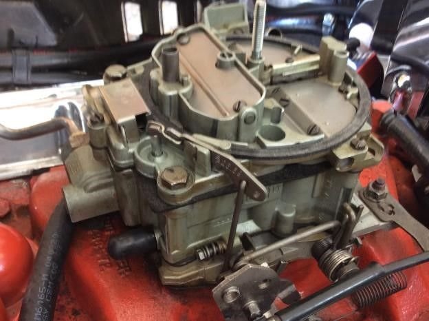

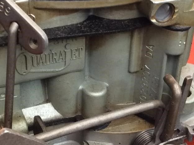

Mike was unable to get his photos loaded here on the Forum, so here are the photos of his carb:
The carb is a 1969 L46 (350/350) carb. It appears to be in good shape, but it has been commercially rebuilt as evidenced by the "t-bar" pressed into the bowl vent in the choke rear wall casting. It's also evident that the commercial builder sandblasted and stripped all plating off the steel parts - the parts are all bare steel, which is typical of a commercial rebuild. Also notice how they painted the choke pulloff diaphragm - all give-aways of a commercial job. That said, it is highly likely that the carb has multiple issues and problems, not just limited to the misaligned throttle blades. I have sent Mike a copy of my "Commercially Rebuilt Q-Jet Problems" paper so he can get an idea of many of the issues that are most likely present in that carb.
On the good side, his carb does not appear as badly hacked as many that I've seen. I can see that his secondary linkage is misadjusted, which could prevent opening of the secondaries under some conditions. It may have some issues internally, and we know they screwed something up on the throttle plate assembly. Bottom line is that the carb needs a complete teardown and inspection to determine all the issues, and then they need to be properly and correctly repaired and resolved.
