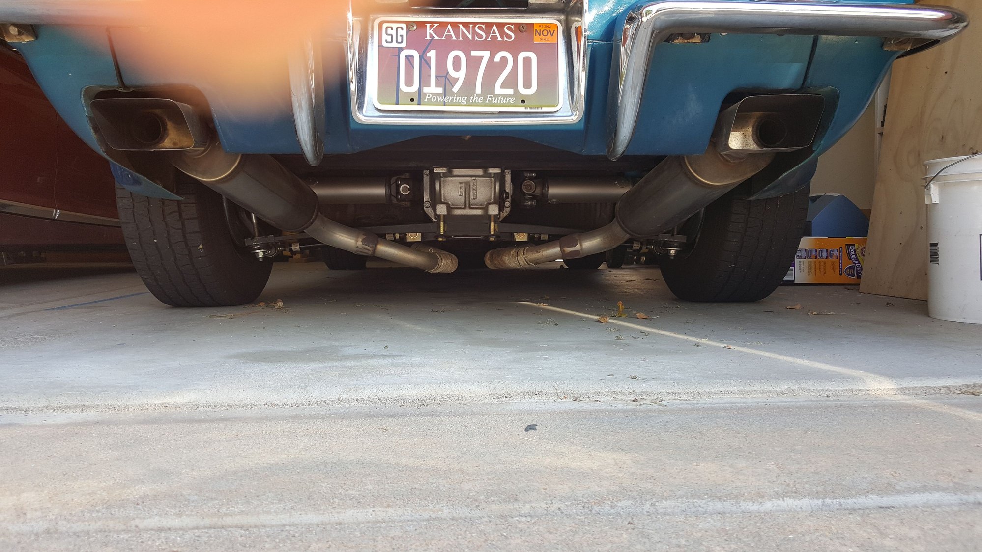

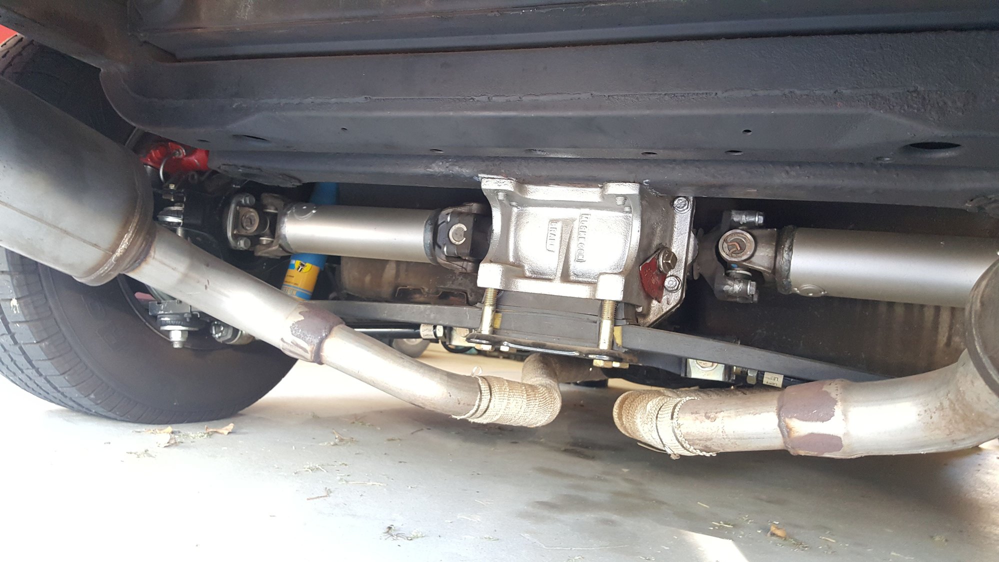

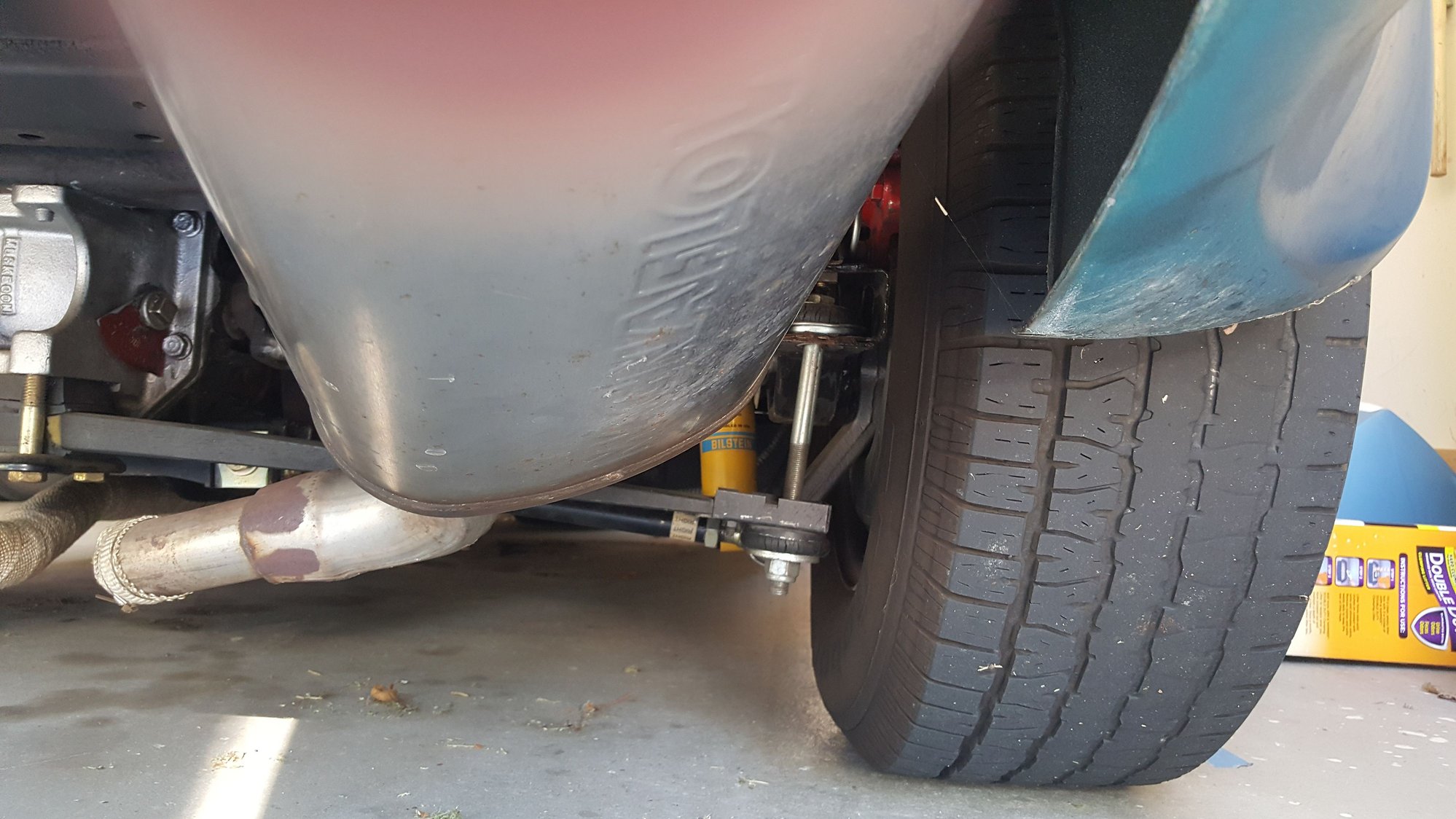

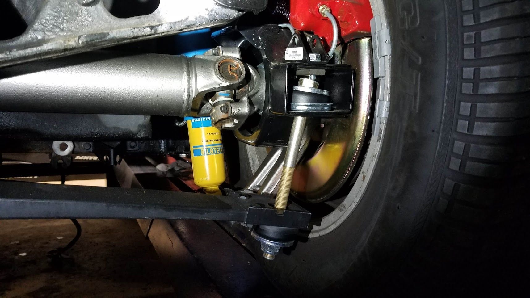

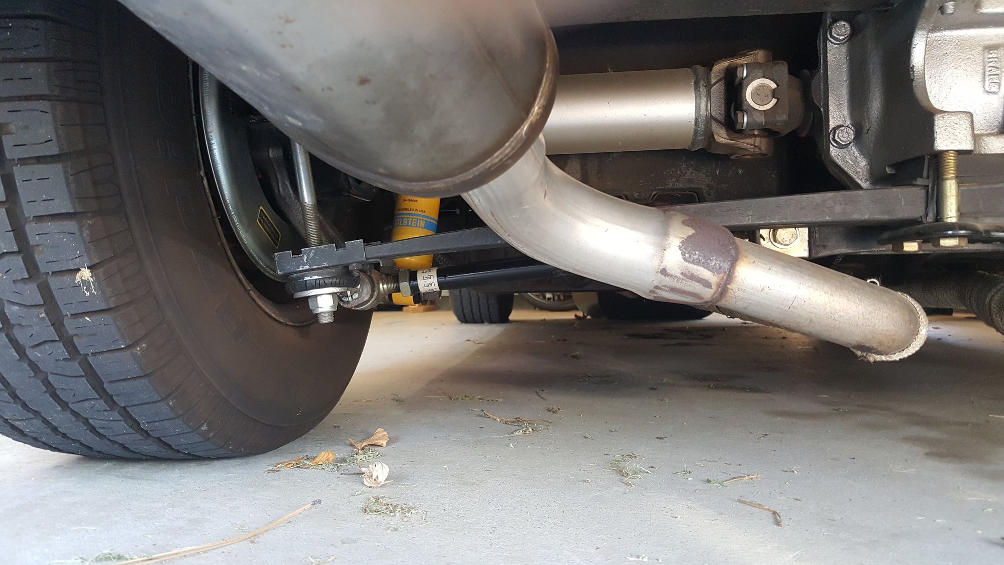

Yes, I think next week I will give a go, have watched that guy's u tube clips numerous times. here are some pictures of the lower rear end.

judging by the shape of the spring bushings... they have not been touched in many years..
any close ups of trailing arm bushings?

Bikespace's Avatar
Bikespace
Joined: Mar 2017
Posts: 11,934
Likes: 4,498
Thanks for posting photos!
It looks like you have a lot of positive camber. You can fix that yourself with your adjustable strut rods (you need to lengthen yours). If you garage is level, all you need is a level. Camber should be zero, or very slightly negative (bottom further out than the top). @cagotzmann's link, above, has numbers to get you started, and a way to measure. Until your camber is within spec, there's no point adjusting your toe-in.

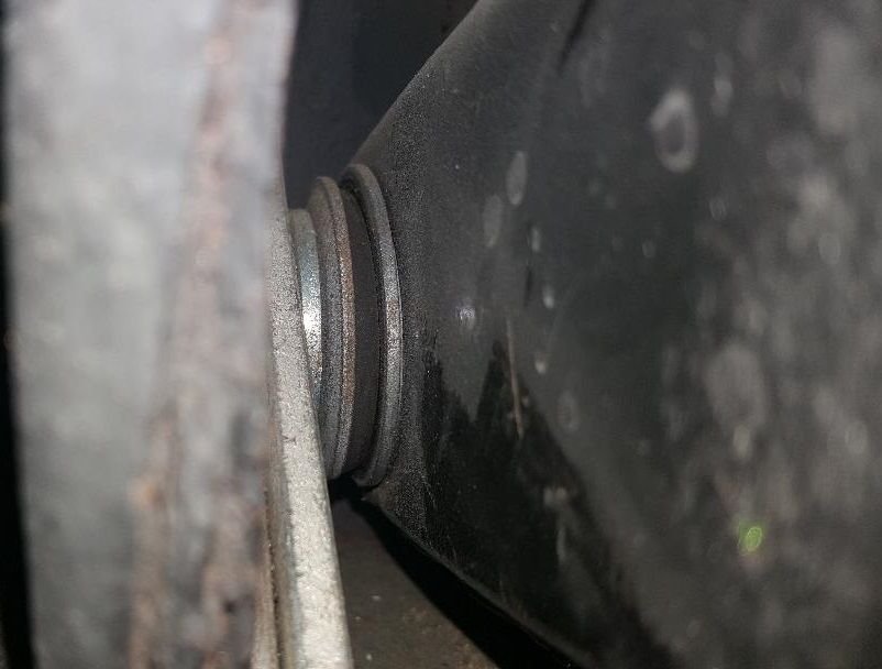

Here is a picture of the driver's side trailing arm bushing, not such a good picture. The car is jacked up, tire/wheel removed, spring unattached on this side, and the trailing arm is jacked to simulate weight-on-wheels (level). The disproportionate wear on the tires, both sides, is on the outsides. Some of that could have been from improper camber too. Also, I have ordered new spring rubber bushings and shim set for alignment porpoises.

That one bushing looks great..
