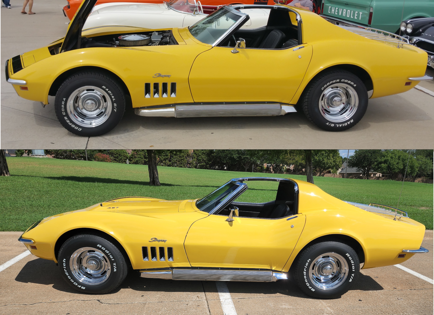

Not to confuse you some more, but my opinion
15x7 AG rims using 245x15 will round the tire a little and I feel will not sit flat. If you use a 15x8 AZ rim then it will sit flatter but you will probably have tire rub
I personally would not go with 245 tires as it will rub. I have a 68 and I plan on using 235x60 all the way around for driving.
I have 15x8 with 245x60 on my 71 454 and no issues. The design fits better. I also have a 71 LT1 and it has 255x60 and looks great and again no rubbing issues
For your 68 using the 15x7 AG rims I would go with 235x 60's for the front and rears. But if you like put 245x60 in the back.
or borrow a set of 15x7 AG with 235 and then try 245 to see if there is any issues.

When I got mine it had the 225/60 and it always looked weird and like it should be lowered (stock suspension). Went with the 225/70 and could not be more happy, looks great now.
Edit: And now the speedo shows correct
gbvette62's post was spot on.
