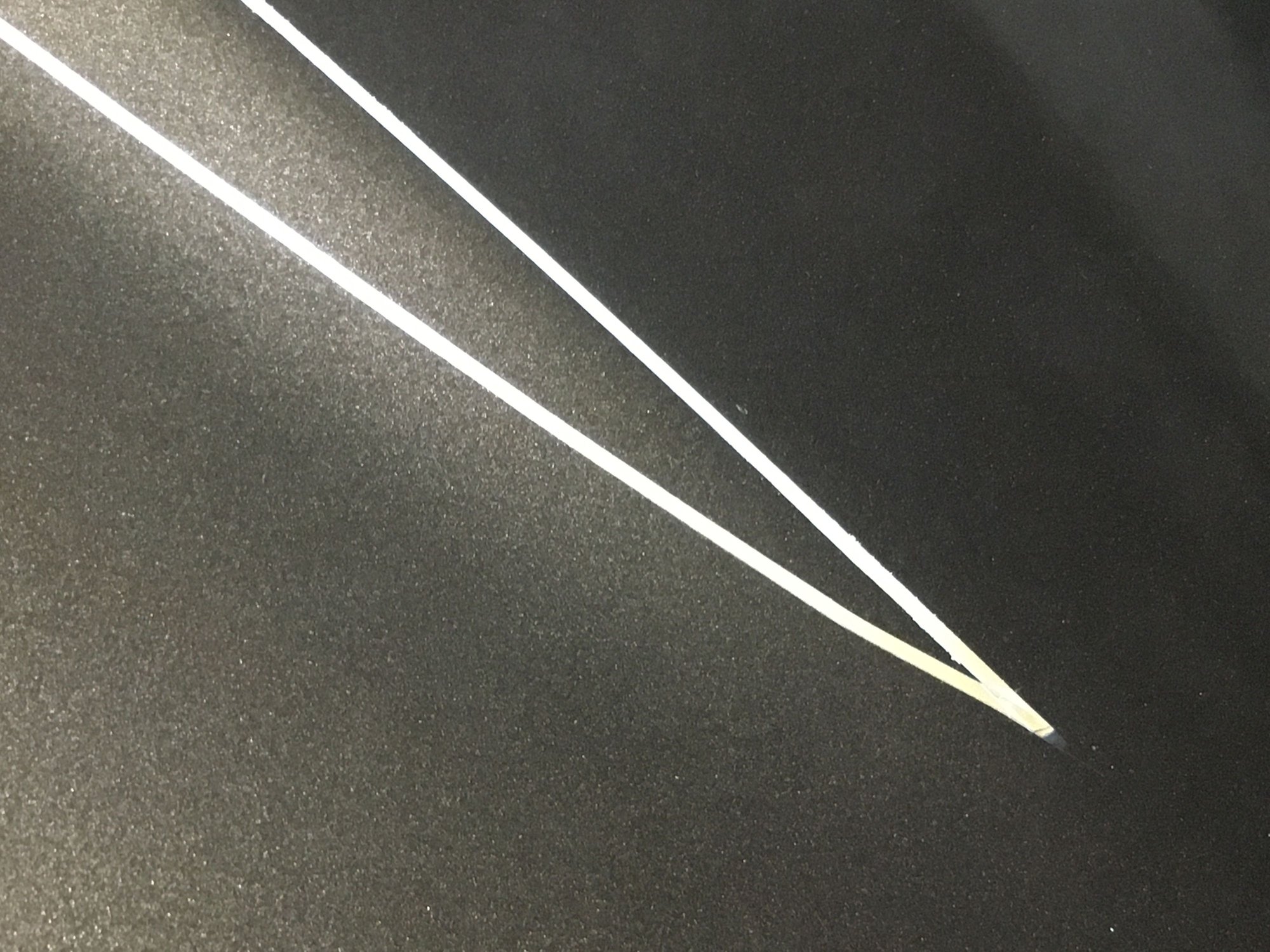

My 78 came with pinstripes I didn’t care for; the type dealers put on to get a few extra bucks. I used a rubber eraser wheel and then polished with rubbing compound. The car came with 17k miles on it; had been stored in a garage for a long time. Minimal exposure to sun, but all the stripes left ghost stripes.
The eraser wheel needs to carefully kept flat on the surfaces to avoid gouging the paint; easier on flat surfaces, concave curves are tougher.
