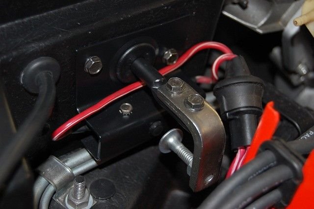

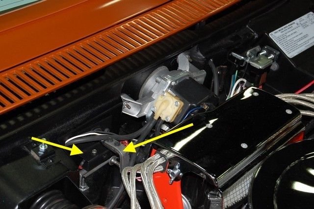

Check the wiper door limit switch and make sure that it stays fully pressed in while the wipers begin their upward motion.

Yes. There is a bent arm that holds a threaded stud that looks like a trumpet. The wide part of the trumpet pushes against the switch when the wiper door opens. This closes the switch circuit that allows the wiper motor to run.
Sometimes the stud needs to be adjusted so it makes full and consistent contact with the switch.

Somehow the connection got loose. Don't know how. Never touched it as it is tucked away. Everything works. Thanks guys.
