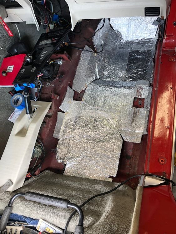

Hey all,
Starting on the interior restoration on my 1981. Pulled the old nasty smelling carpet out dreading that I might find a bunch of rust but looks like I dodged a bullet. I can see the floor plan rubber plugs are missing but given the condition of the floor pans, what would you do here, if anything, while I have this all out? Thanks!

Personally I'd clean it up with a wire brush and hit it with some Por15.

Looks good enough to use some rust preventor like Por 15.

Do you have to get it down to bare metal for Por-15 to be effective?

No, just put it on.

How does the underside look...it might need some POR-T.L.C. also to be safe.

Hey Doorgunner, undersides look great. Surprisingly even the kick panel body mounts look great. Whew!

No floor plugs saved that floor looks great

I wouldn’t do anything to it other than clean it, and a few squares of sound deadener strategically placed.
i would also be sure heater core not leaking while you are there 😂

Yeah I need to check that. Will need to do some research on how to get to it. I’m sure it’s not fun.
