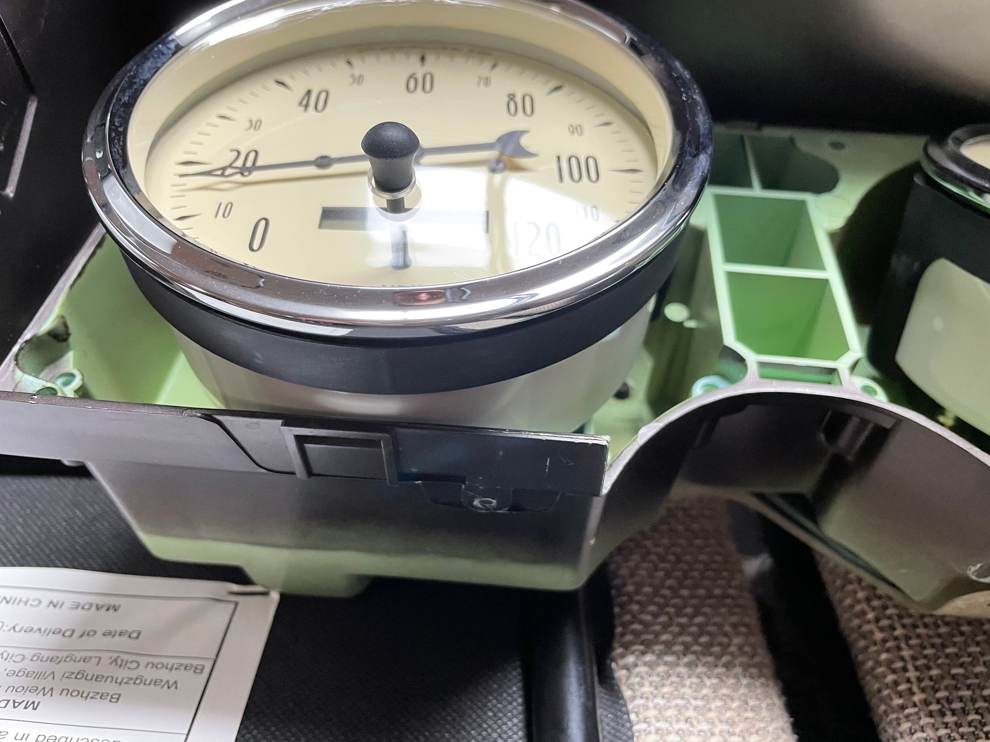

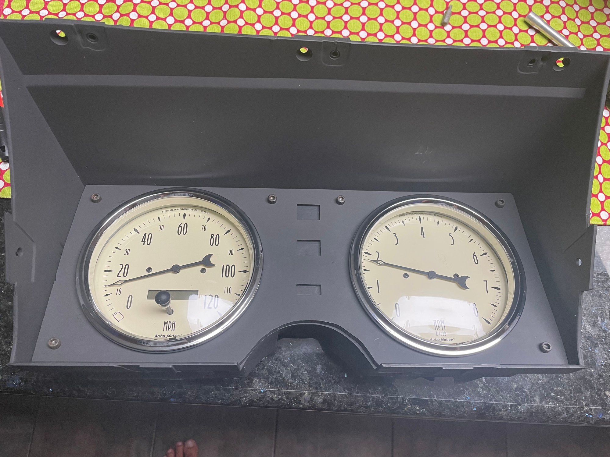

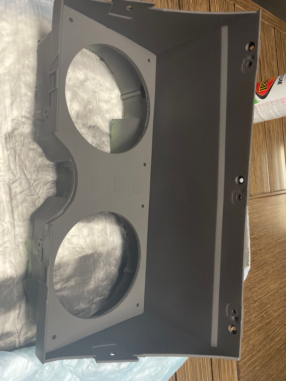

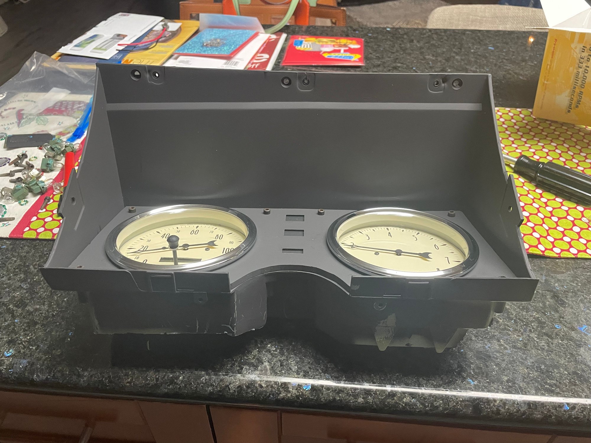

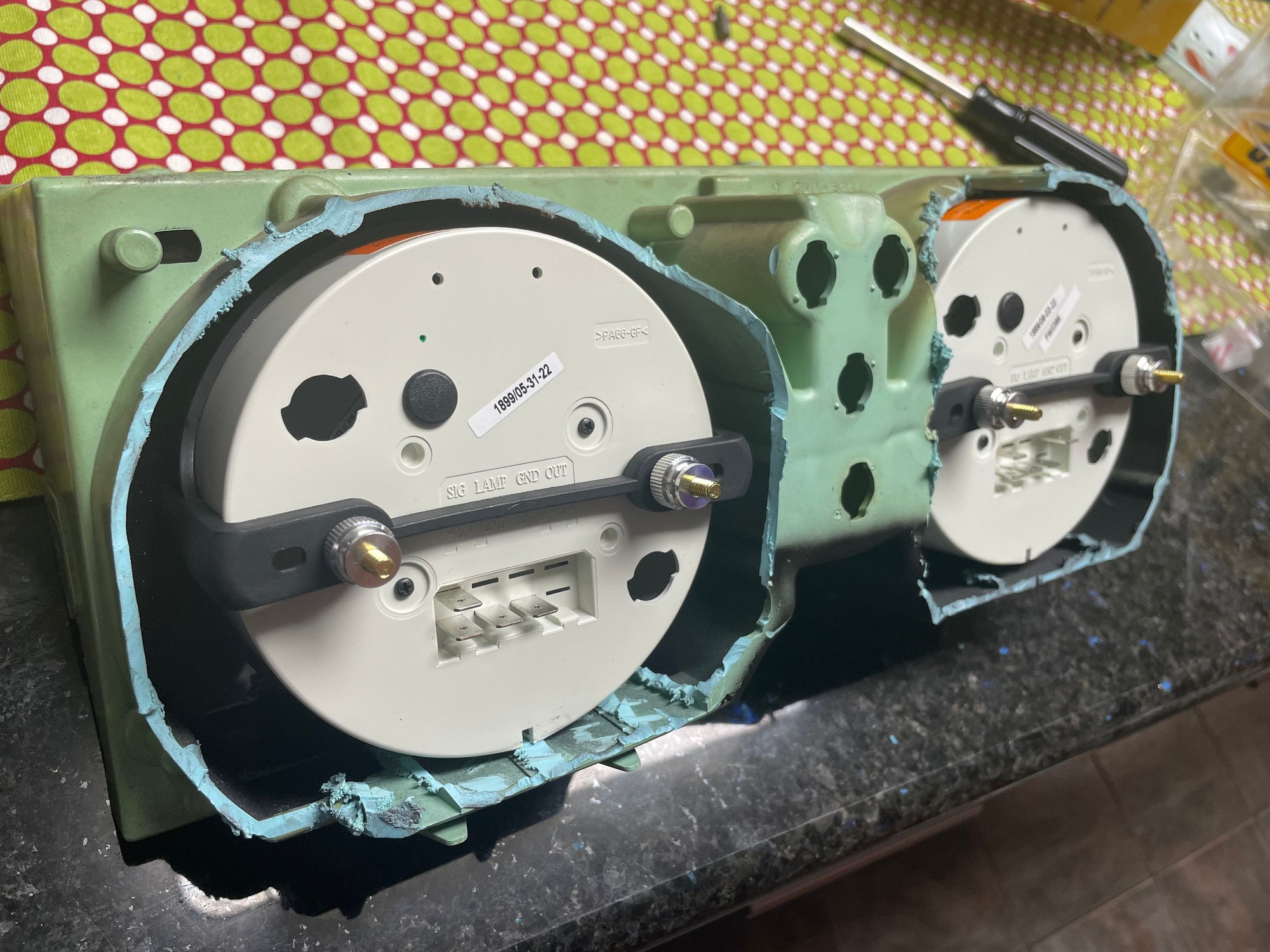

So I finally got around the finishing my dash.
What I was working with
How the back ended up after all cuts were made
I cut a piece of acrylic, sanded it, painted it matte black, and screwed it to the factory housing minus the faceplate
Final product
Final product.

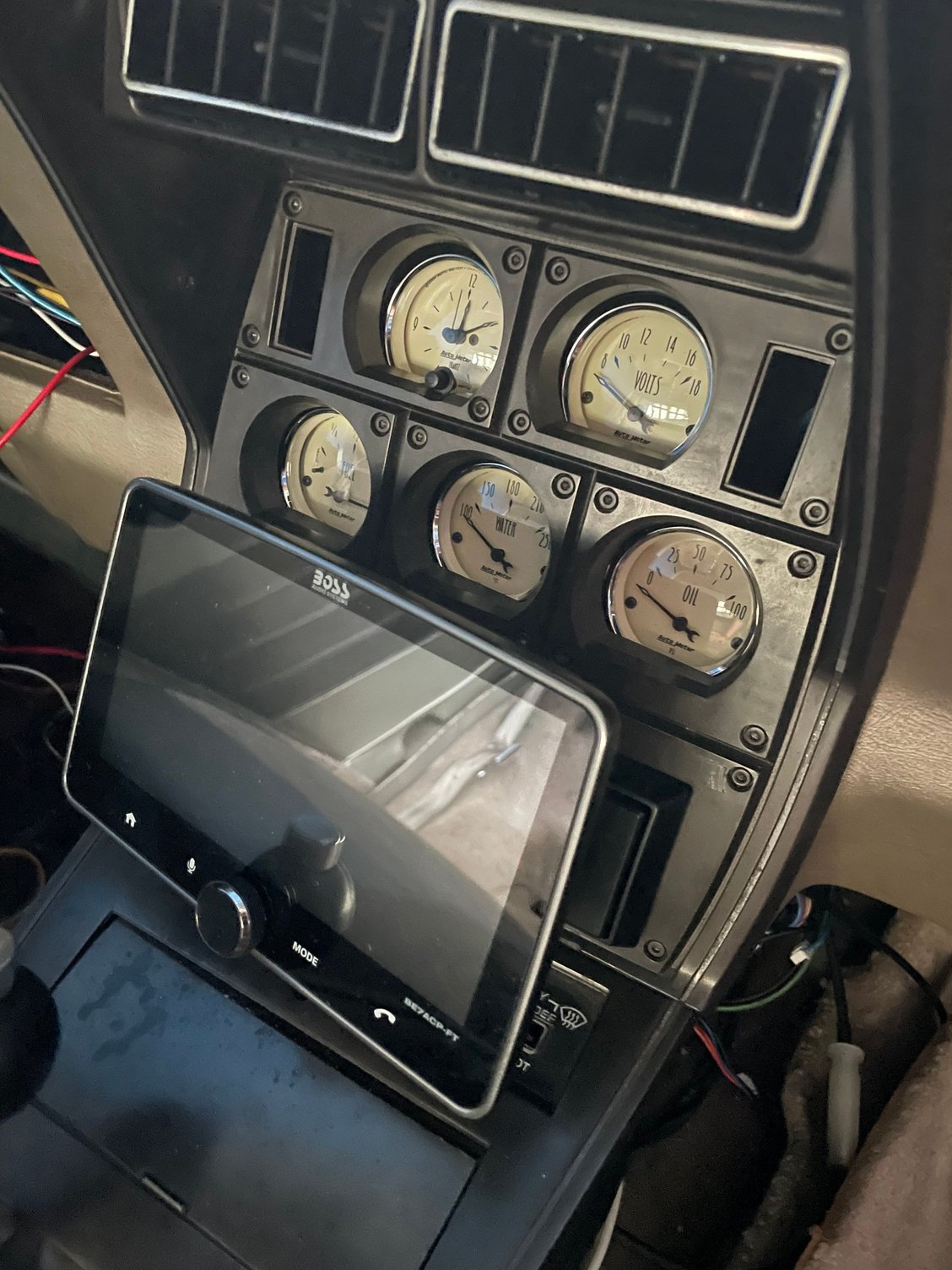

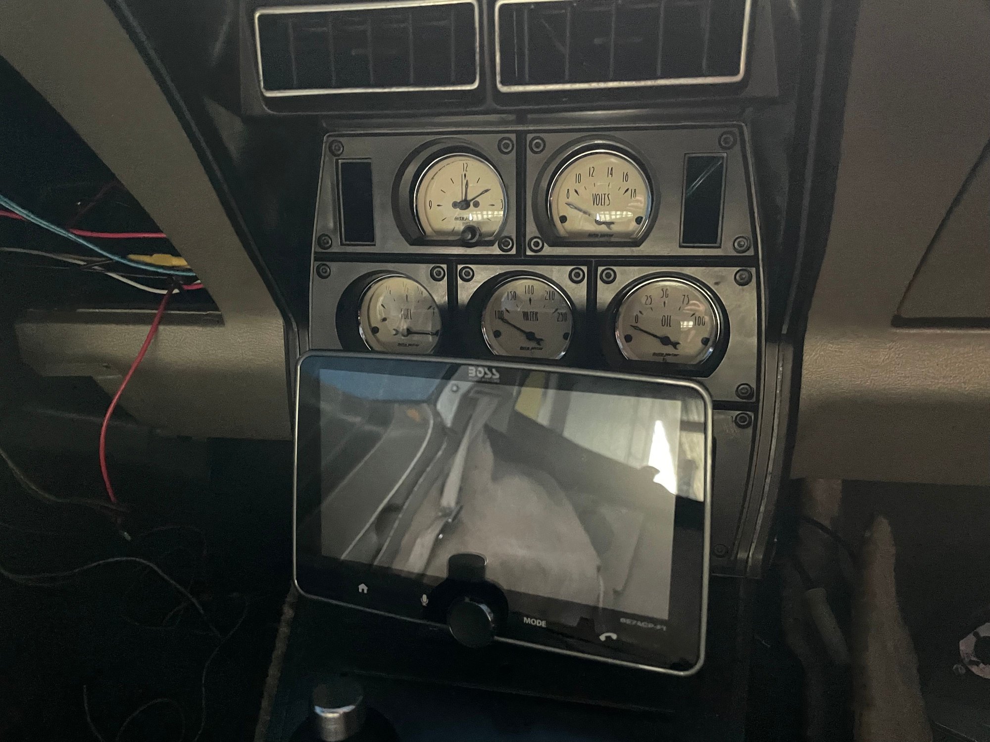

I’m doing an LS1 swap into the C3. I already swapped the center console gauges, and these are a match for it
