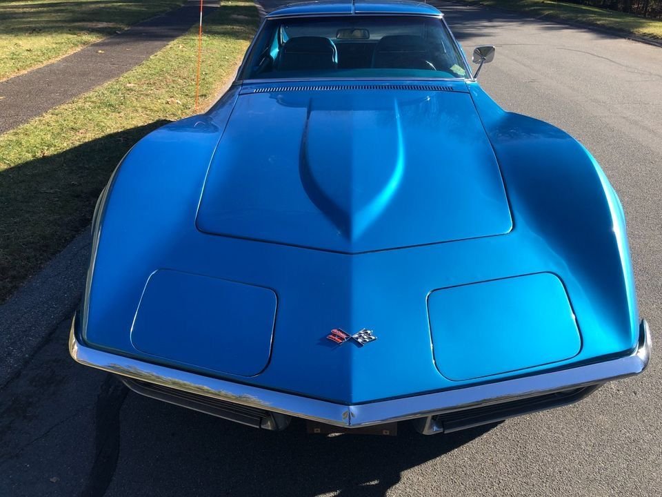

Thanks, everyone. There are some very inspiring photos here, as well as good, practical advice.
The Florida hurricane and the storms that spun off it caused some delays in car shipping, so it’s shipping out to me next week. I have some shopping to do in the meantime.
This photo was taken earlier this year. I want to keep that paint looking great!

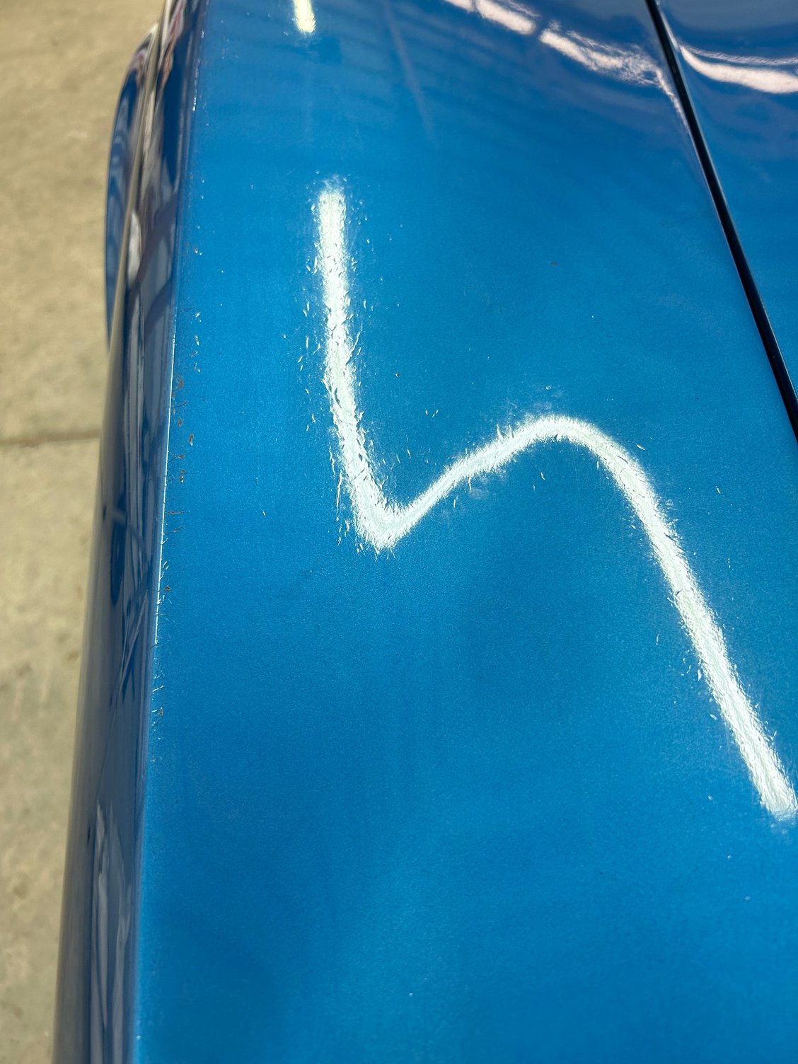

thanks for posting.. did some research on SINGLE STAGE ONLY car care.. and the #7 you mentioned.. i have corrected mine in the past with compound etc. scratch removers..and thought pretty good..
Although i am not doing the week long or even 24 hours long.. i basically tried it for 5 minutes and really was impressed.. NOTE this stuff will not last but i will try to put some wax over top as recommended to protect.. I have a black targa painted on my roof (not stripe on hood) and if you have a dark car.. it makes a difference..
I will say though that you are removing paint.. but not much...
i will post a few pics when done but lookin good..
NO glaze on the decal..

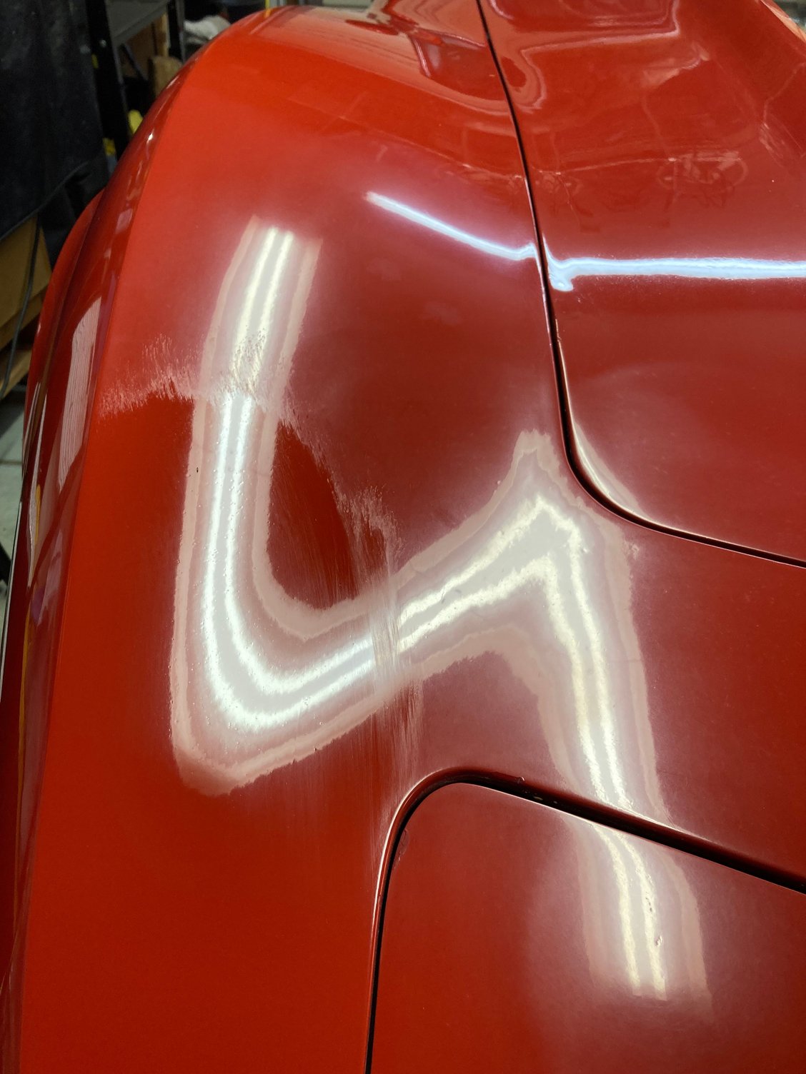

I think its worth a try for those sprorting lacquer mono coat paint. Not sure how long it will last but it is noticeable..would love to see a few try it even a small spot..
turned a 10 footer into 9? And darker deeper..
after wax shown…didn’t really change after glaze.

After rubbing off #7 that soaked in for 24 hours
