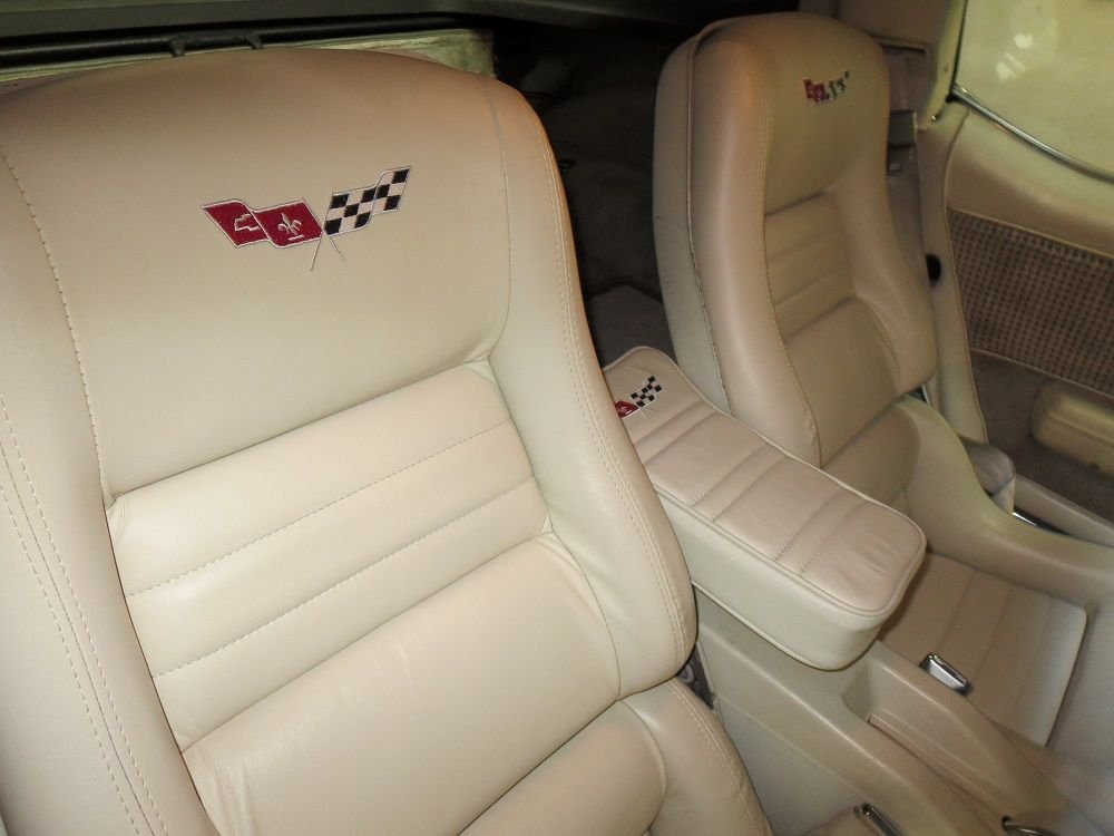

My 80 came with moldy seats that I replaced, but kept and tried to restore. The covers and foam stood no chance and were tossed. I was able to save the shells with a lot of bleach.
Replace all the carpet, too, and check behind the dash.
Wherever you get your parts, there are two primary manufacturers. Al Knoch, and Corvette America (now owned by Top Flight Automotive). For carpet, Al Knoch and ACC are the primary suppliers. The vendors will tell you where they get their stuff if you ask.
These are Corvette America put in my 79 by the PO. They are really nice.
