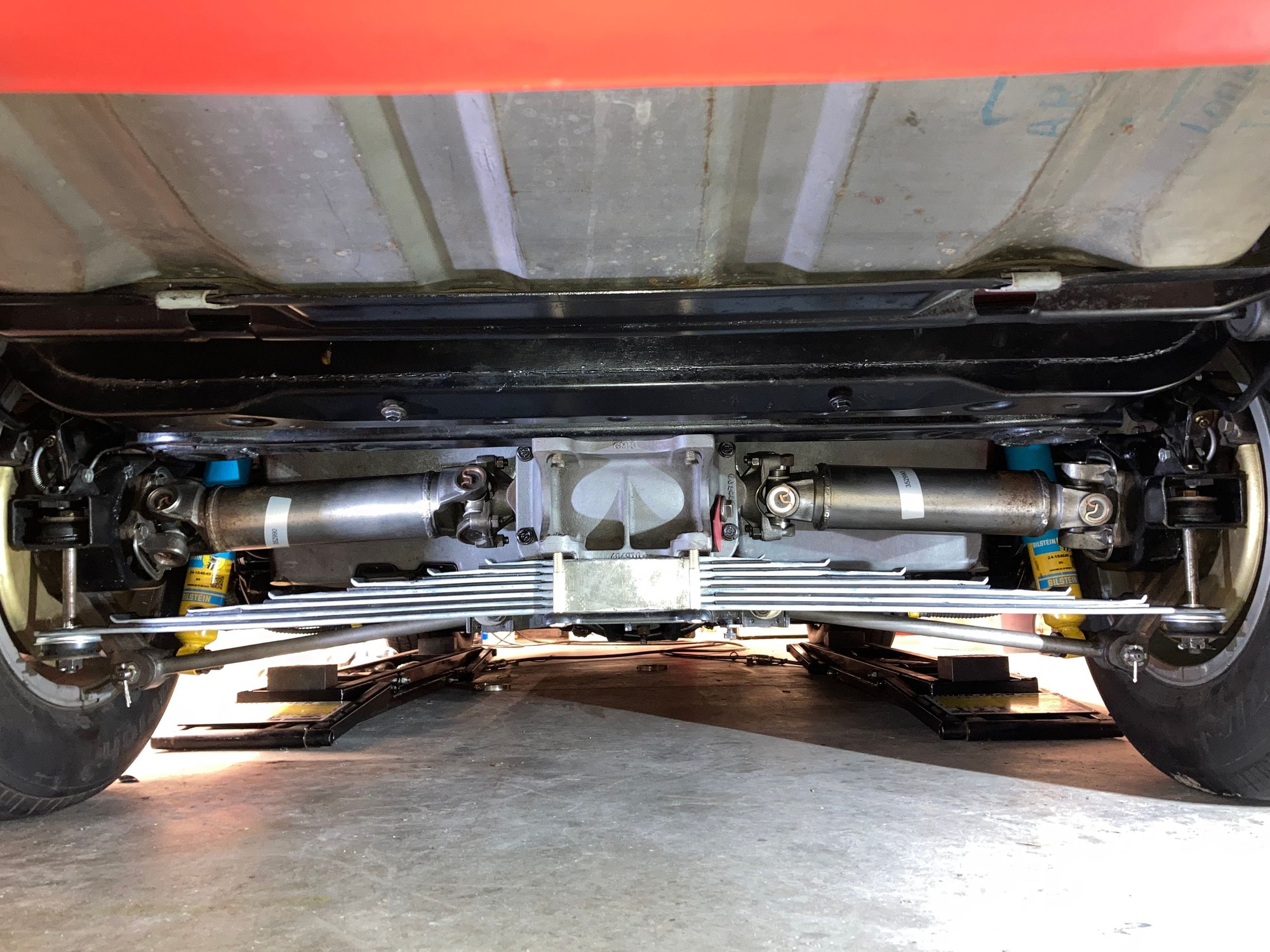

i went original..cleanedandsprayed with matte clear.
i used USA made poly from energy. I have had zero issues and very easy to install here
https://www.corvetteforum.com/forums...od-advice.html
now that said..i have done a fair amount rear end work, and removed many times..i find it real pita to line up on reassembly.
some say adjustables are easier to install, I don’t know but would consider next time if there is a next time.
i like the stock set up though and adjustments stay put for me.
